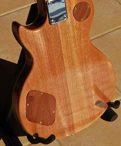

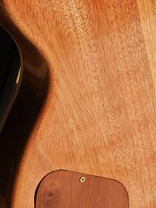

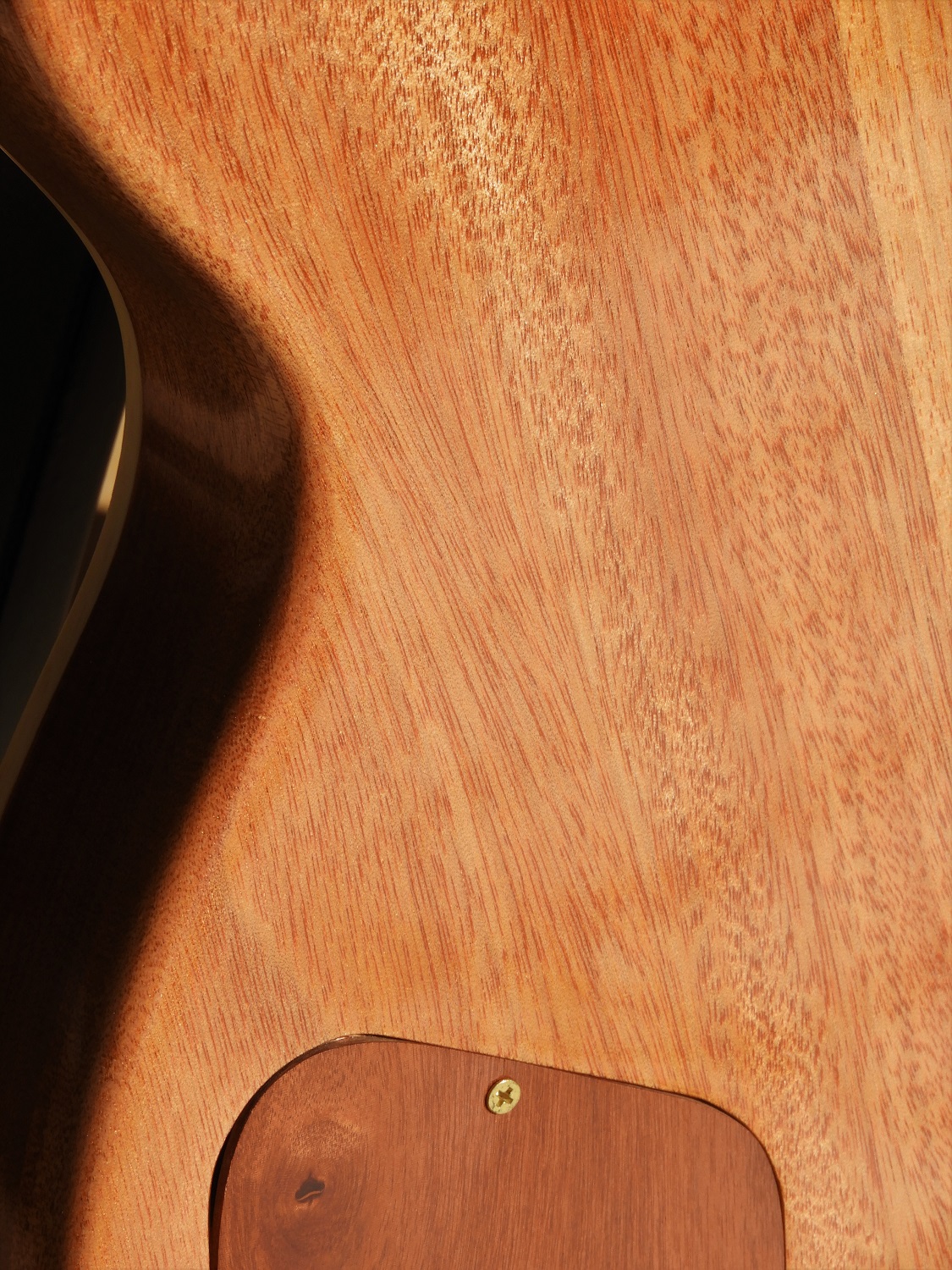

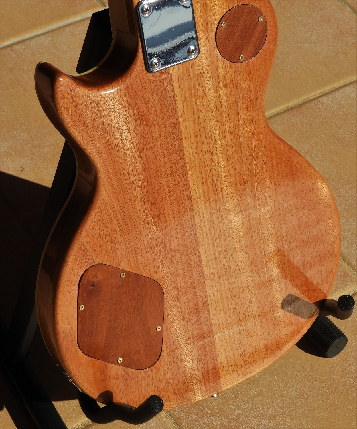

    I thought this topic was dead but as it is still of interest here is the result.
    The scratches were sanded back with all the mahogany and recoated with TruOil. Yes the TruOil finish is as easy to patch as expected.

    I can now sleep soundly as my apparent anal complex has been eased

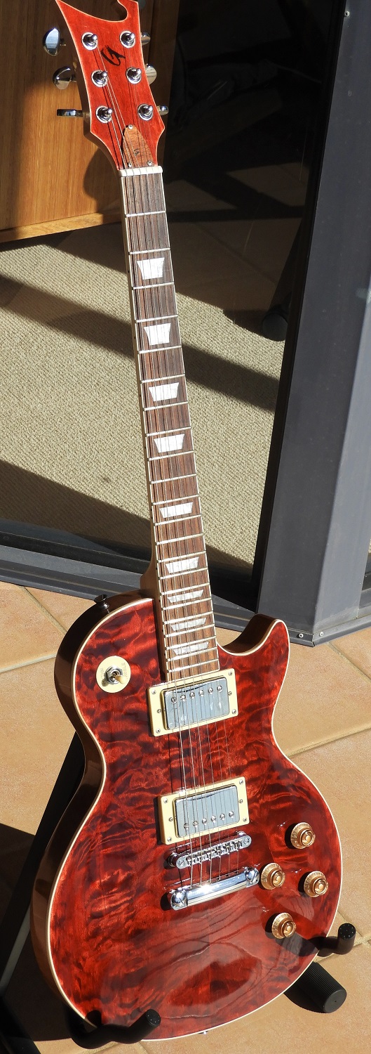

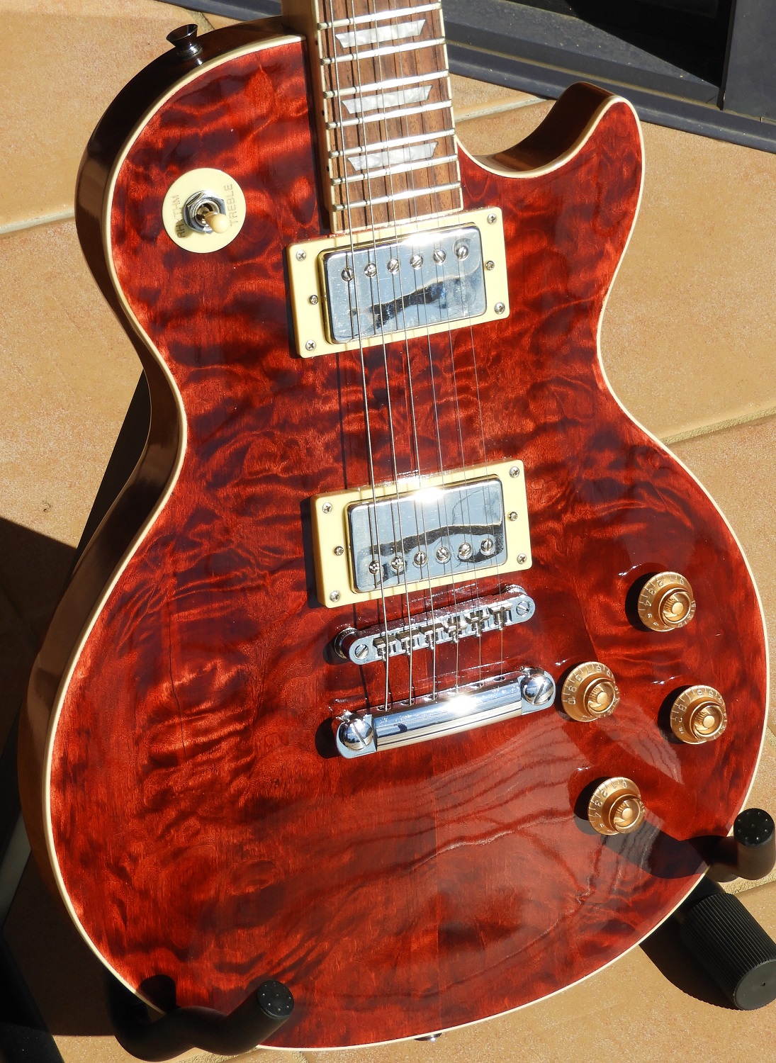

    I also took the opportunity to re-finish the cap as it was my first build and I was not that experience with TruOil.

    The guitar now plays beautifully just like when your car runs better with a wash and polish. Hihi
