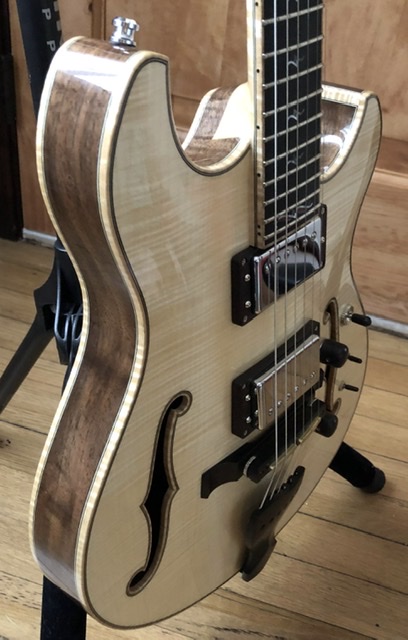

    Today I ordered black Gotoh bridge hardware. Since the guitar is already drilled for Tunomatic I don’t have the option of using a Benedetto style tailpiece. But I think a black bridge and stop bar will give a similar visual effect to the inspiration guitar. The 2 Knobs will be black and the 3 switches will be nickel hardware with black toggles. Black pickup surrounds and nickel pickup covers. I’ll change the nut for a black Graphtech Tusq nut, and the machine heads will either be light weight black, or mini nickel with ebony buttons.
    The inspiration again for reference:

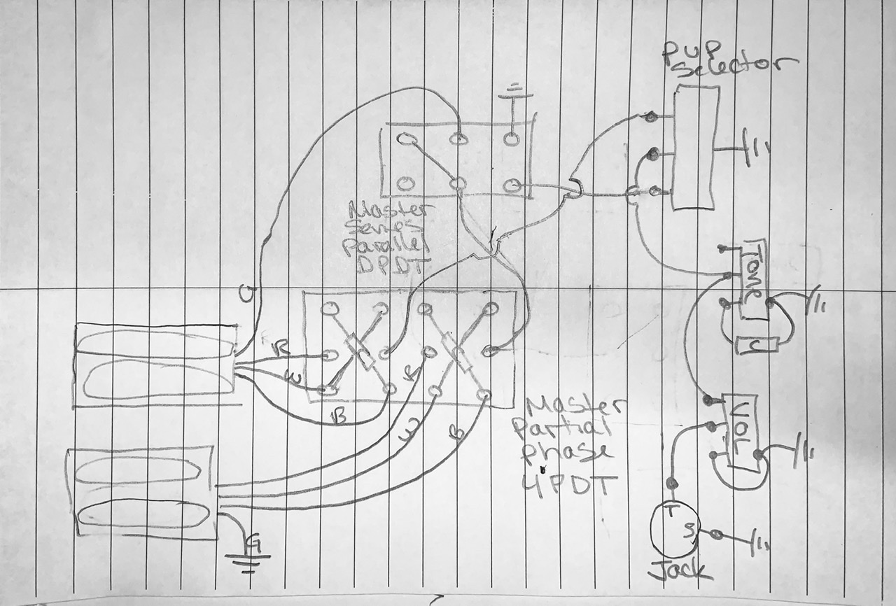

    I”m not a big fan of normal (individual) series/parallel switching low impedance humbuckers, but I do like playing with tone. Entwistle has a diagram for partially phasing individual humbuckers which is supposed to sound better. Also, the Languedoc guitar I’ve been referencing has a ‘master series/parallel switch’ and I found that intriguing. So I came up with a way to implement both. I posted this is a separate thread in the wiring forum (https://www.buildyourownguitar.com.a...ad.php?t=10478) but it’s part of this guitar, so here it is (I might have the pups backwards and IDK if anything else is wrong with it yet.)

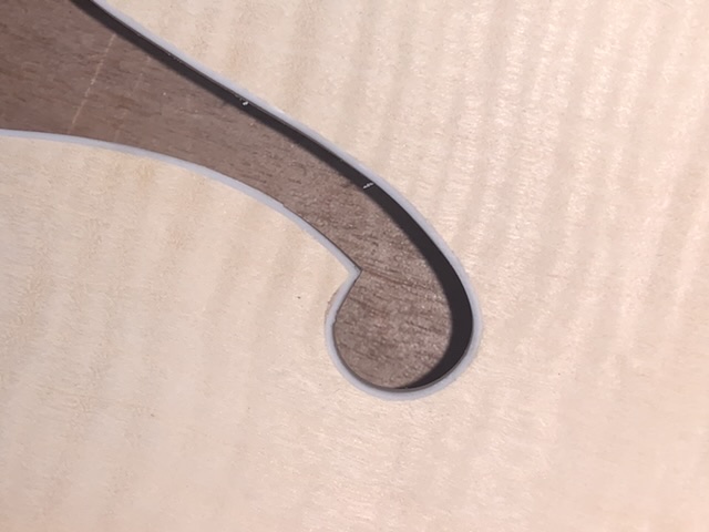

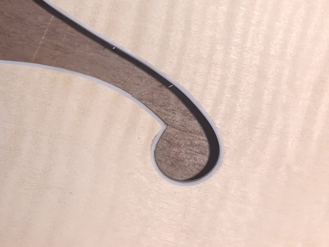

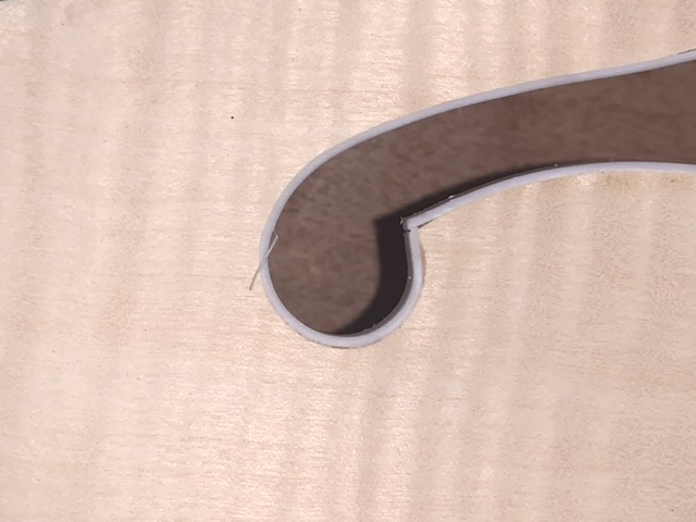

    Another thing I’m trying to figure is how to touch up binding gaps without affecting finish options. If I use CA it might show up if I were to stain the guitar. I ordered some PVC binding to make an acetone slurry though I’m not sure that’s the right approach either. Maybe just heat and straight acetone?

    You could stain and then repair the binding. Though acetone/binding slurry applied with a toothpick could work if you are careful and use a magnifying lens. Alternatively some grain filler should fill the gaps and take up any stain applied.
    Too many options available!

    I totally missed the thought of fixing the bindings after staining . That might be the best approach, then I could use almost any adhesive I choose.
    The wood is the right shape and the binding should be adjusted to match it, so I ruled out any filler other than more binding (w/ acetone.)
