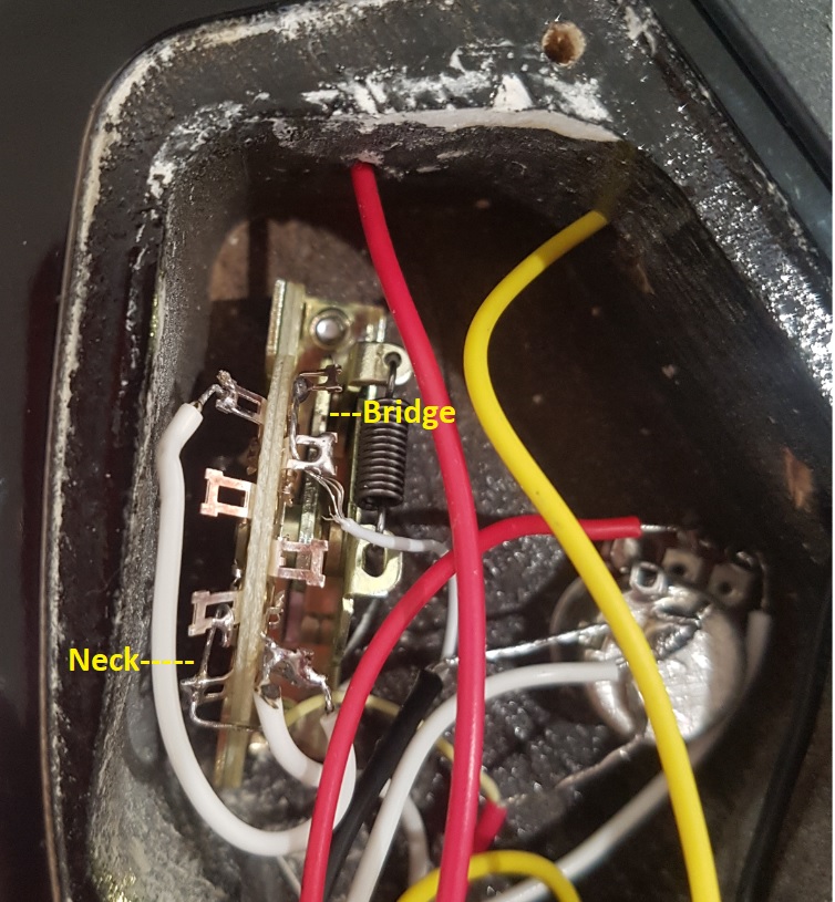

    Ok I have the guitar back. Just to confirm it's the top middle of the diagram you did for me and NOT the bottom middle.
    Here is a pic I have tried to label it the best I can I hope you can see?

    So noted in the blue line below is where I should make a connection or have I stuffed that up hahaha?

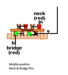

    Actually from reading I think this is the one I'm meant to be doing?

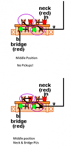

    Your blue line doesn't look right to me. The second diagram is the one to aim for. Here's why:
    This is the diagram just for the middle switch position, which should select both pickups. The red spots show which terminals on the neck pickup side are connected to each other in that switch position. The neck pickup wire connects to the other red terminal, but that is not connected to the output. It's the same on the bridge pickup side (green spots).
    The bottom diagram shows the two additional links required to connect the each pickup to the output wire in this position. If you go back to the full diagram you can connect the green dots to see which switch position will include the bridge, and connect the red dots to see when the neck is connected. The purple circles just highlight the critical spots.
    As far as I can tell from your photo, the two green lines I have drawn correspond to where you need extra links. But please test first without soldering if you can.
    Very happy with that thank you so much. I wish I could help othhers on this forum but I'm still learning, especially about the electronics.
    Only issue is I didn't have enough wiring from the neck pup so had to leave the orientation of the switch the same without trying to extend the PUP wires but he is happy now and I'm really happy that I learned. I encouraged him to get into guitar building too.
