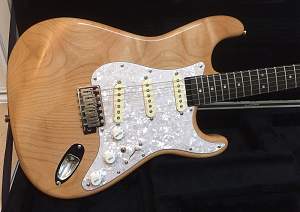

    Here's my example:
Name:	2017 strat body fnt sm.jpg

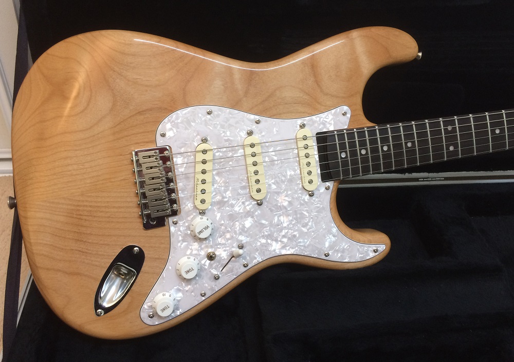

    Talk about a while between updates... (moving house is a good enough excuse, right?)
    Lost count of how many coats I did, reckon it must have been at least 25 or 30. Setting the neck went quite smoothly, left it for a good week or so before putting any tension on it. There was a bit of filling required in the neck pocket, which the old sawdust & wood glue trick took care of quite nicely.
    Decided to make the switch to gold hardware, and painted all the the black plastic parts white to match the binding. Also grabbed a couple of gold pickup covers to keep with the whol.e gold/white theme, and I ditched the tone pot in favour of having an individual volume knobs for each pickup, what with tone knobs being a little less useful when it comes to metal.
    The result is a rather pretty looking guitar:
    Absolutely stoked with it. Looks like a beautiful classic rock guitar, sounds like a high-gain screamer - exactly what I was going for. The sustain is pretty impressive too, particularly given it's quite a light guitar.
    It could probably do with a little more work - the nut is still a little high and I'll end up replacing the painted pickup rings with actual white ones (I've already put a little scratch through the paint on the neck ring inside two weeks) - but I'm happy to call this one finished.
