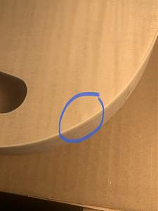

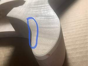

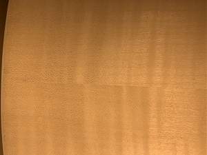

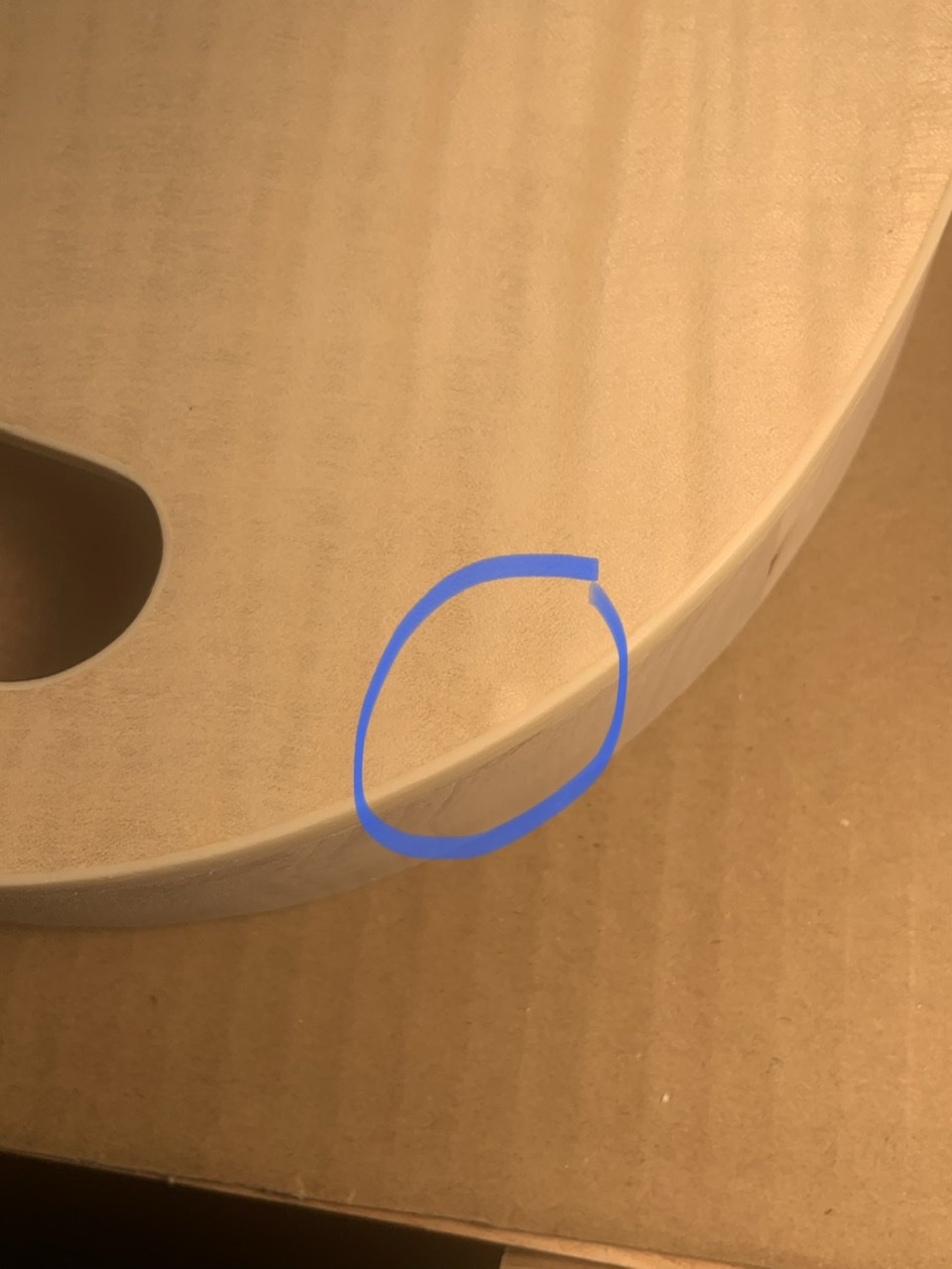

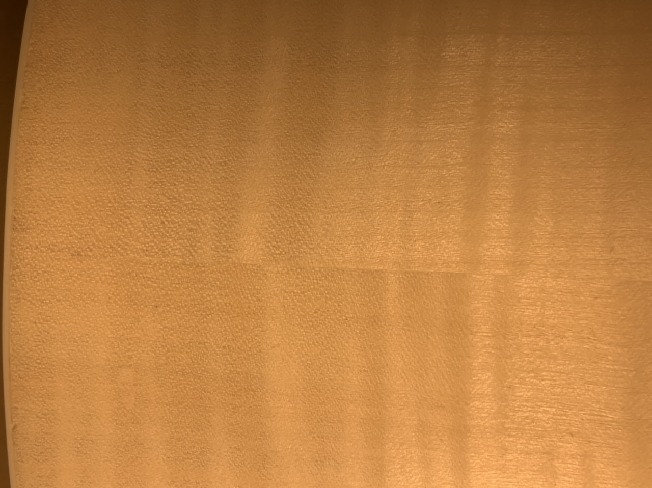

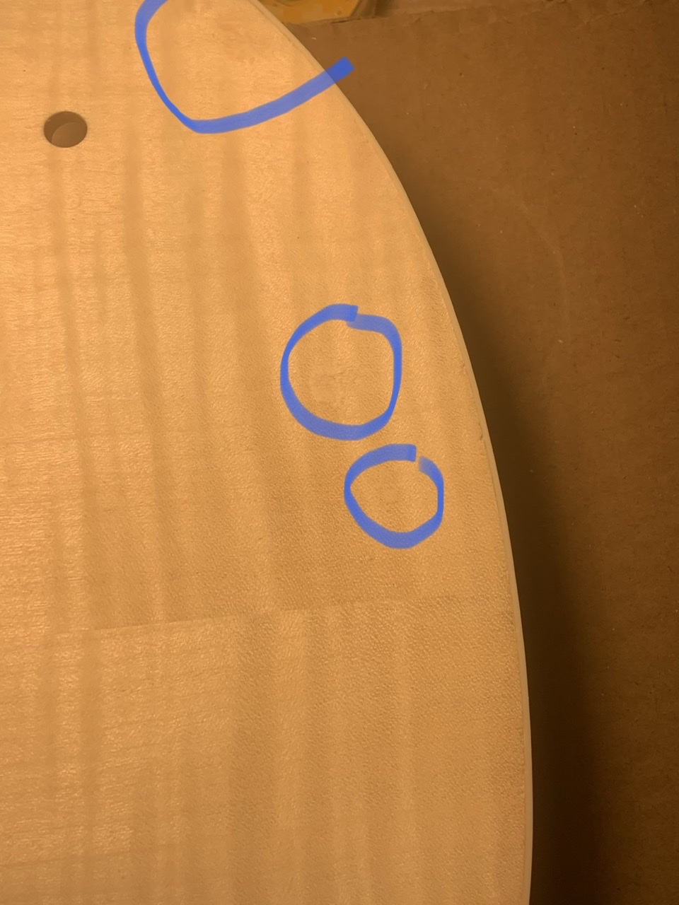

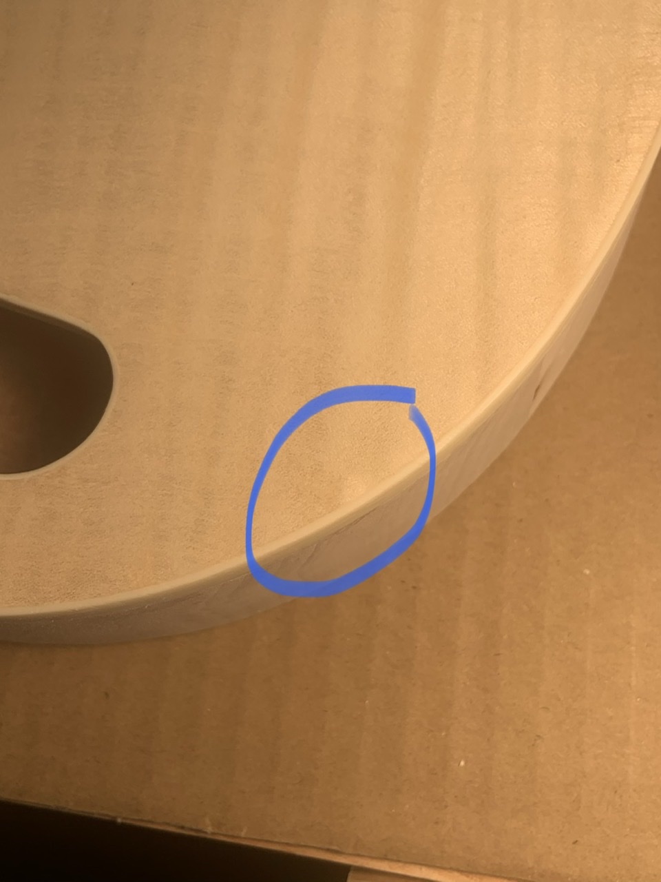

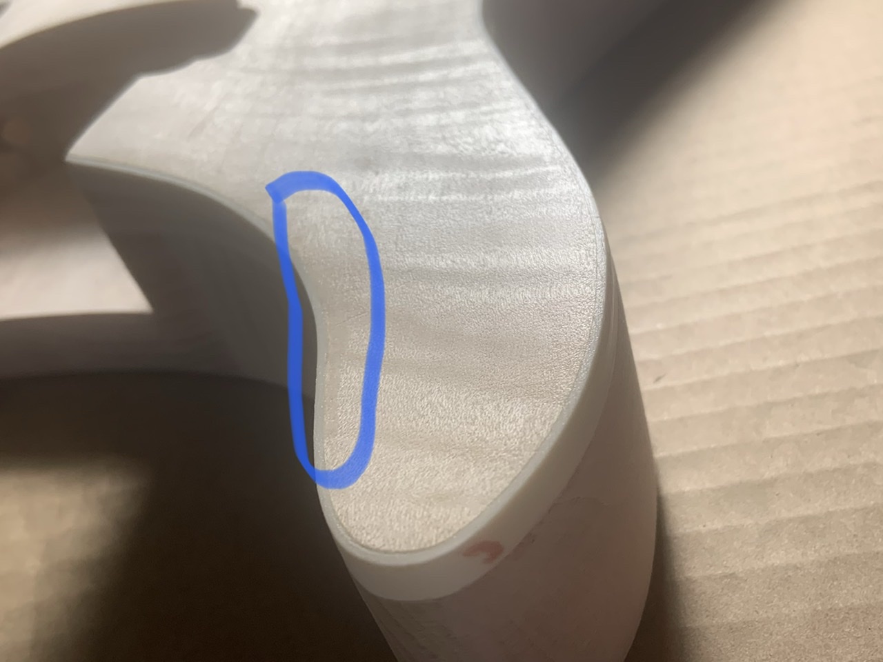

    I don’t see much glue. I saw basically nothing with alcohol, and see this with water. I’ll address what I see, then maybe do a very dilute stain coat to detect other glue spots. Please let me know if you have a better idea or suggestion.
ID:	35799Click image for larger version.
ID:	35800Click image for larger version.
ID:	35801Click image for larger version.
    *Pictures may be rotated due to my proximity to the equator.

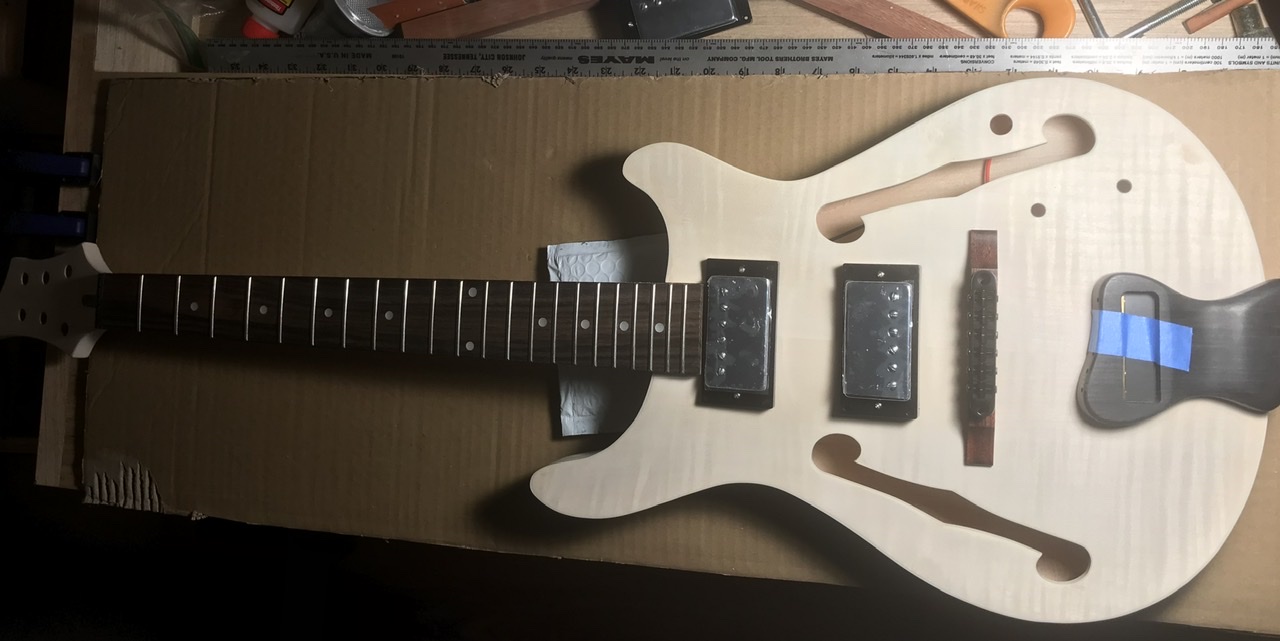

    It’s really beautiful. Well Andy, I can’t just copy your guitar now, can I?!
    Maybe I will have to do something like this:
    Uh oh...
  14. Liked by: Andy40
  15. #30
    Apr 2020
    Honolulu, HI
    229
    To use that tailpiece I’ll need to a) adjust the neck angle, and b) find a suitable hinge to mount it. B) is a lot more challenging than a).
    It would end up with a fairly steep neck angle but not unlike a Les Paul. I can also reduce that by lowering the wood bridge base a little.
    The guitar is obviously drilled for a wrap around bridge with 82mm post spacing. The bridge covers the holes but it would be nice to have a locating feature, though not absolutely necessary. I’m thinking a dowel to plug the hole, friction fit or just a drop of white glue, and left just below the surface so I won’t need to sand around the veneer. I can then drill a hole in the plug, and in the bottom of the bridge, for a pin or similar.
    I guess I can try without all that first and see how it goes. Real wooden bridges float, so.... I thought it would be nice to have the bridge on more of a solid top, but this guitar isn’t very hollow (top is very thick) so it’s really all for looks anyway.
    Oh and I will stain/dye the bridge. Maybe even the ebony tailpiece to see if I can match the fretboard.
    If I can’t find or make a robust hinge, none of this happens.
