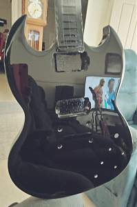

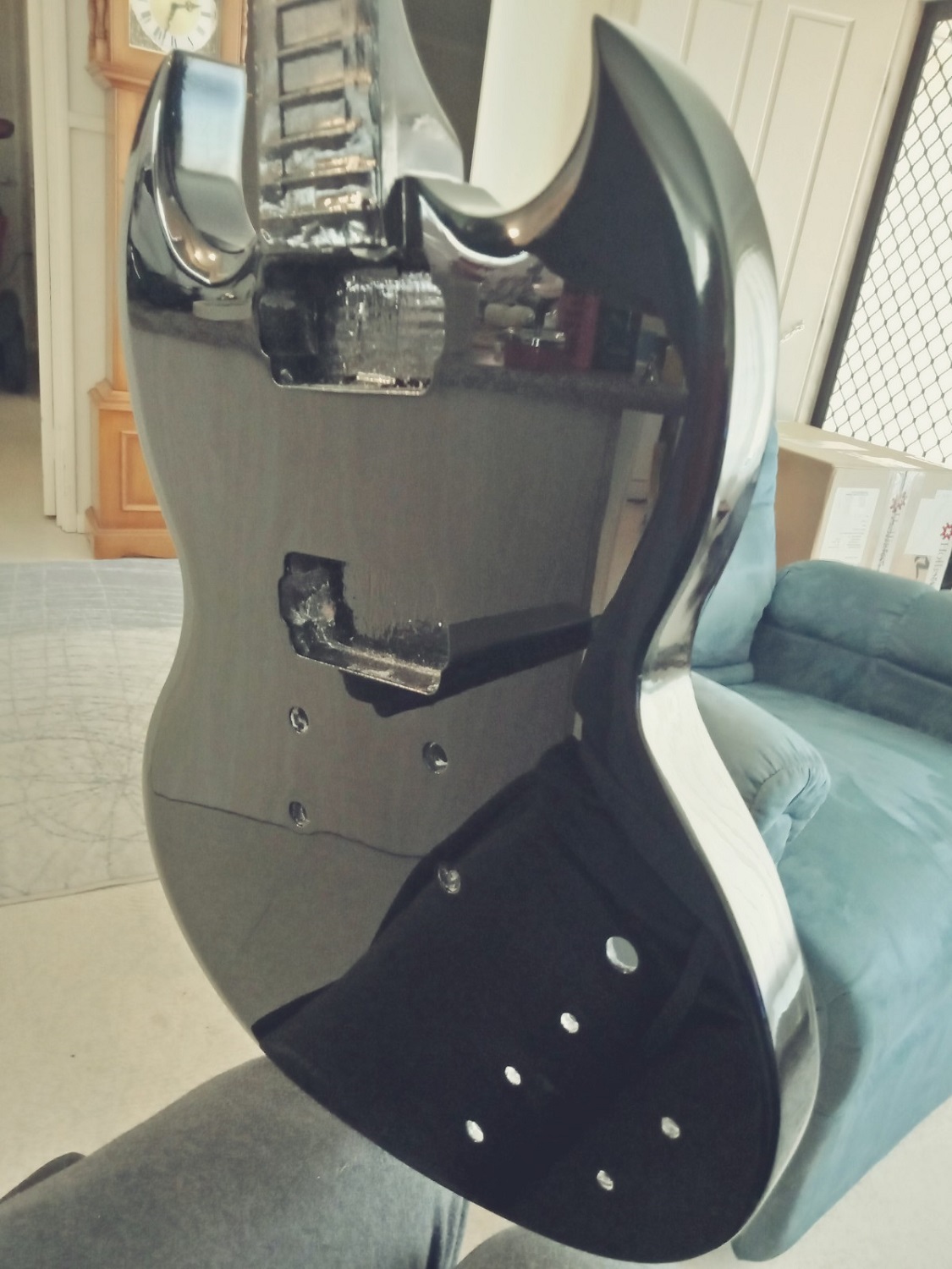

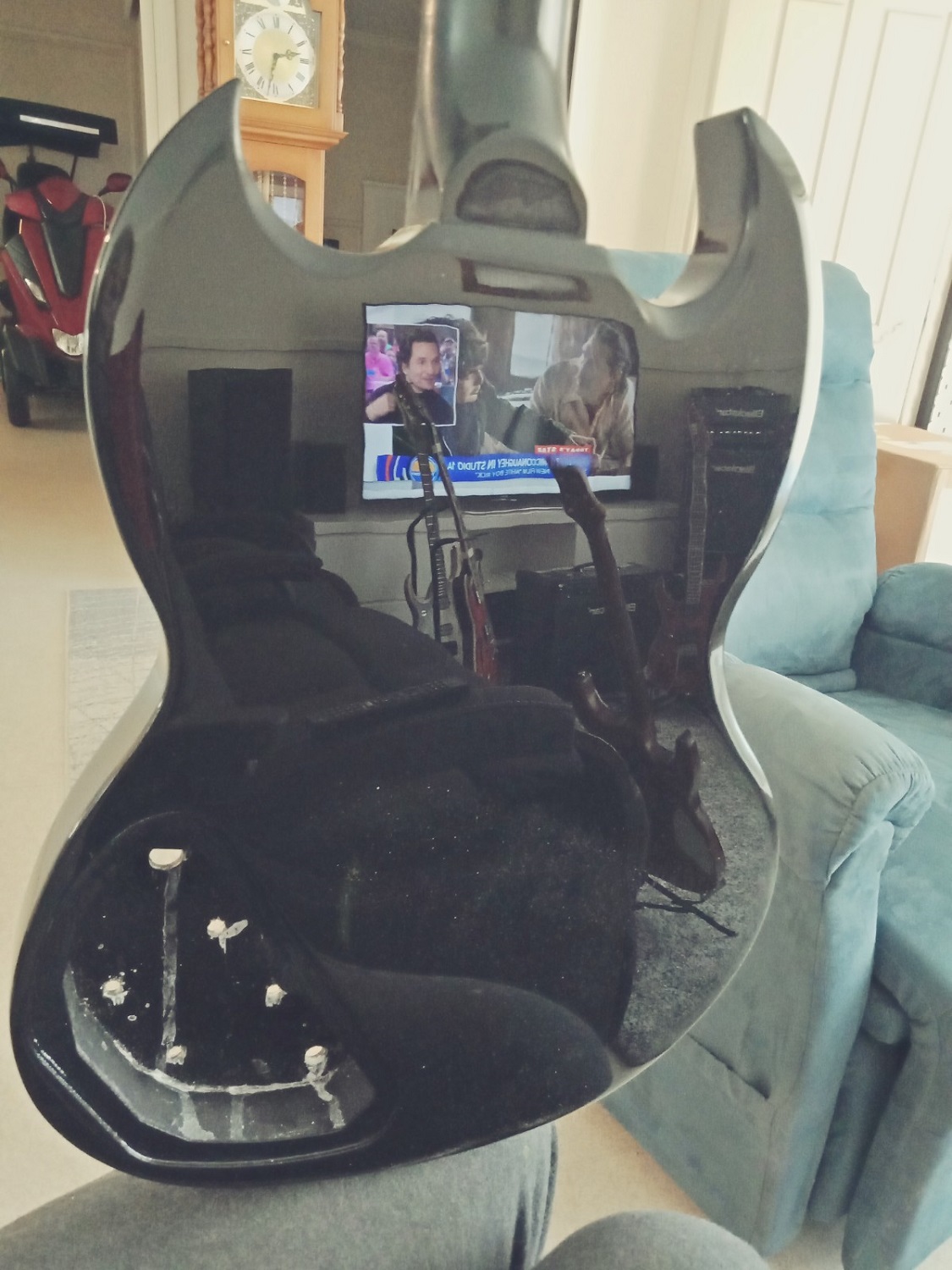

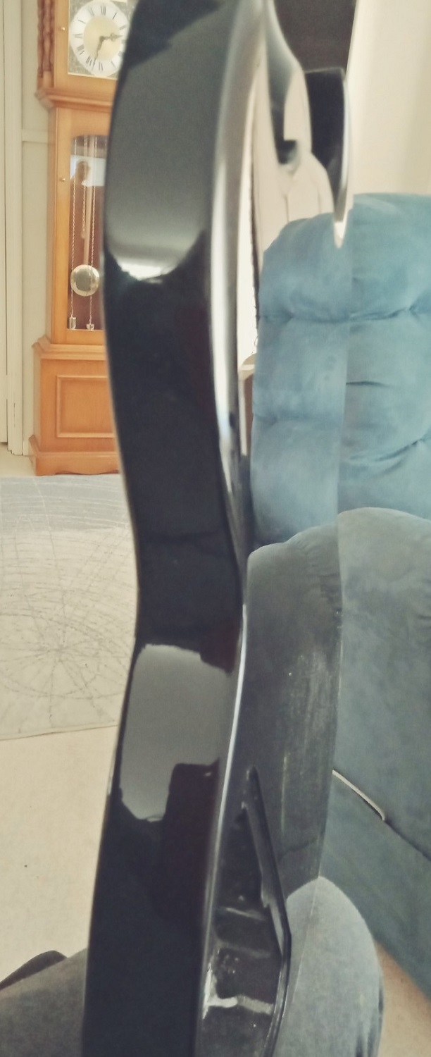

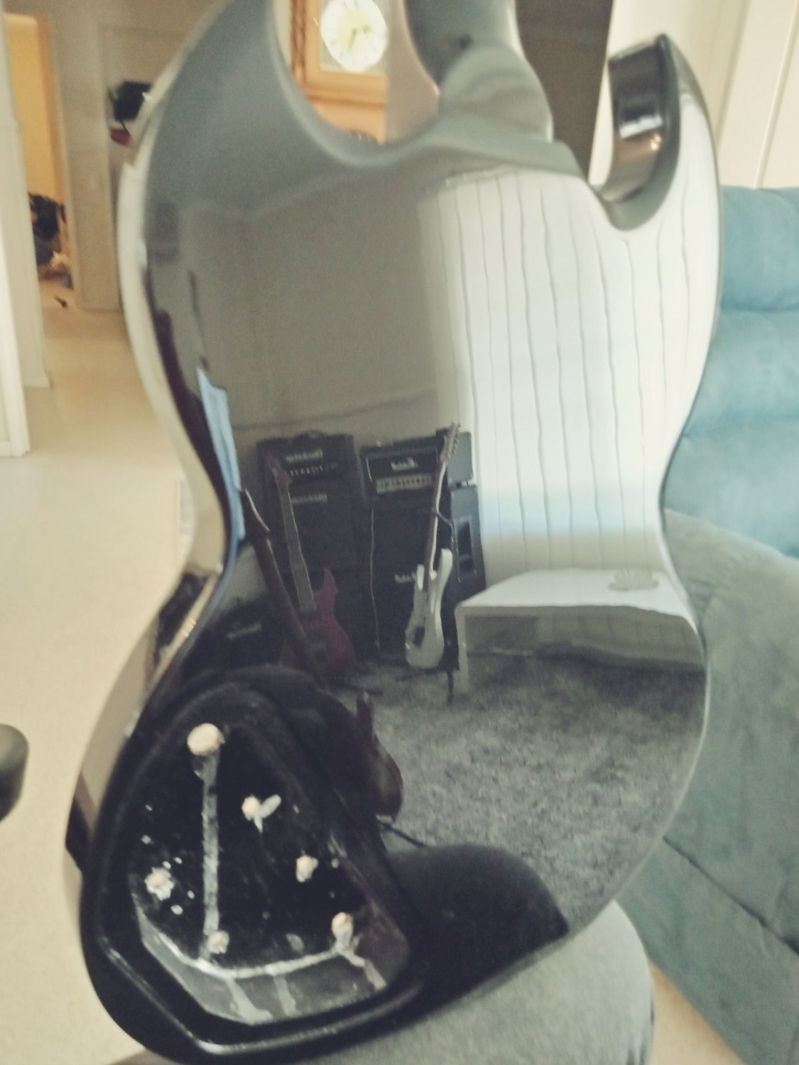

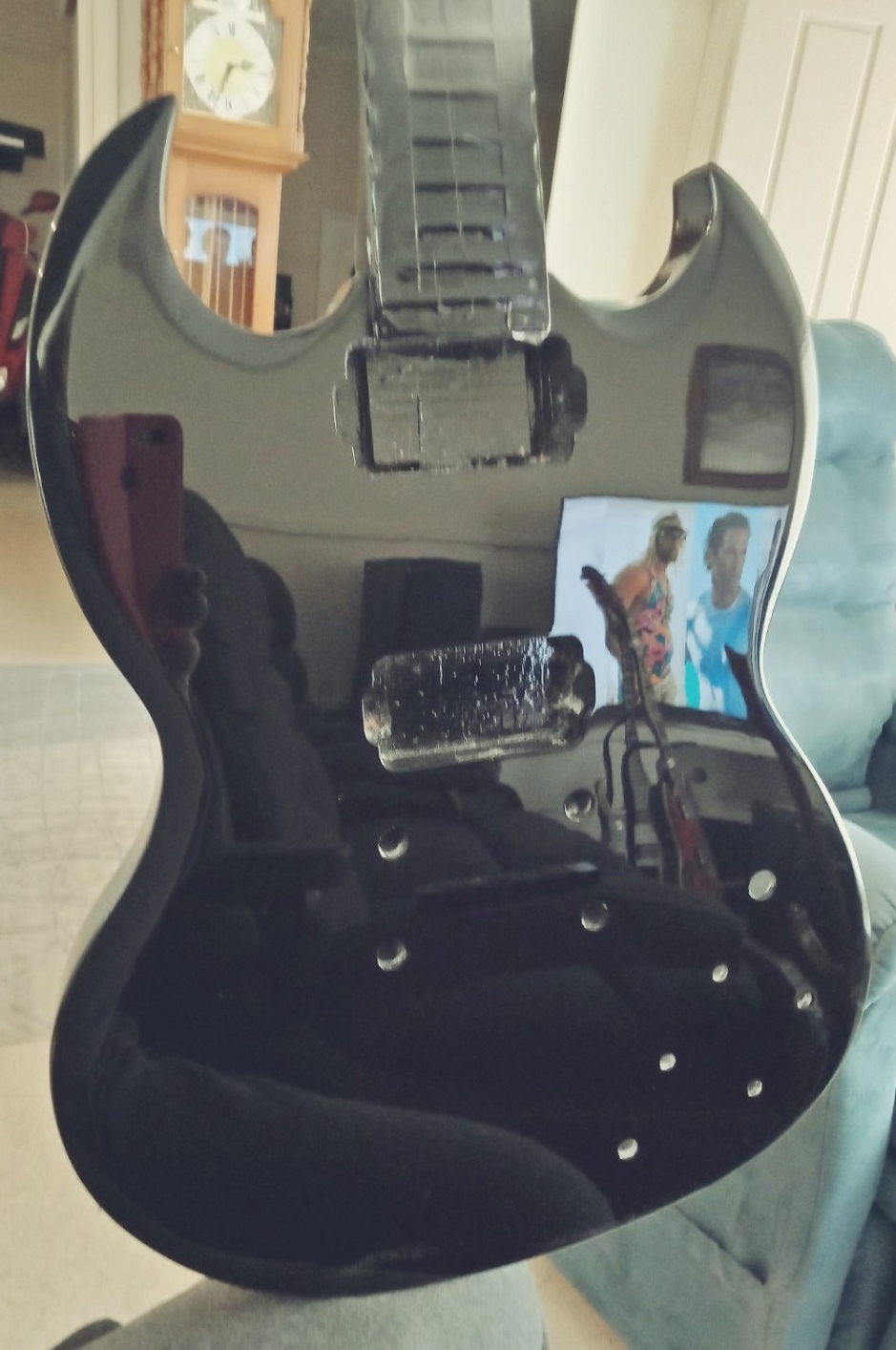

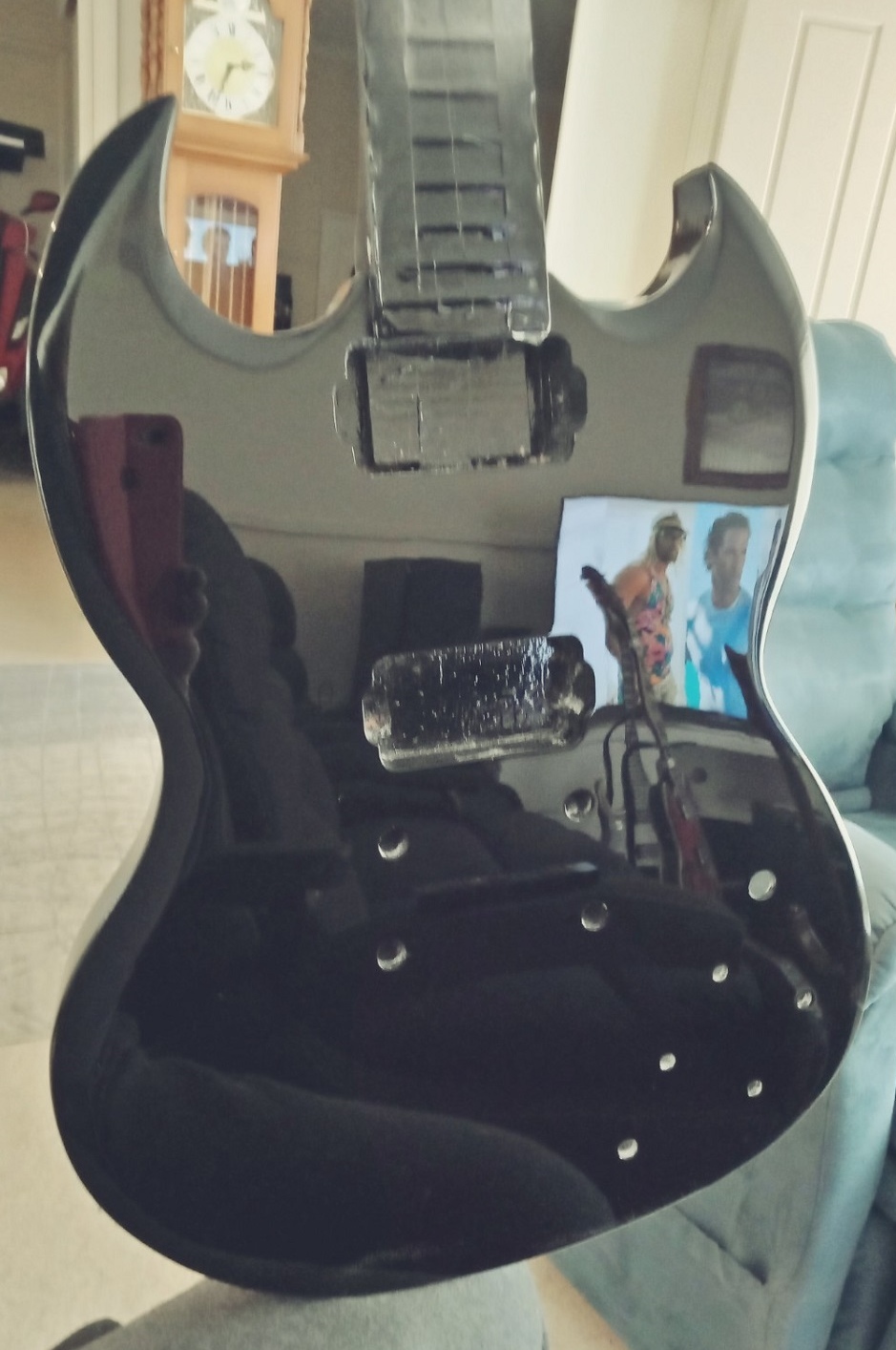

    this is a AGM-1 this was also used the SCA primer/filler, black and clear and the same sanding sealer pretty straight forward has dried for a week then polish still to do head stock decal

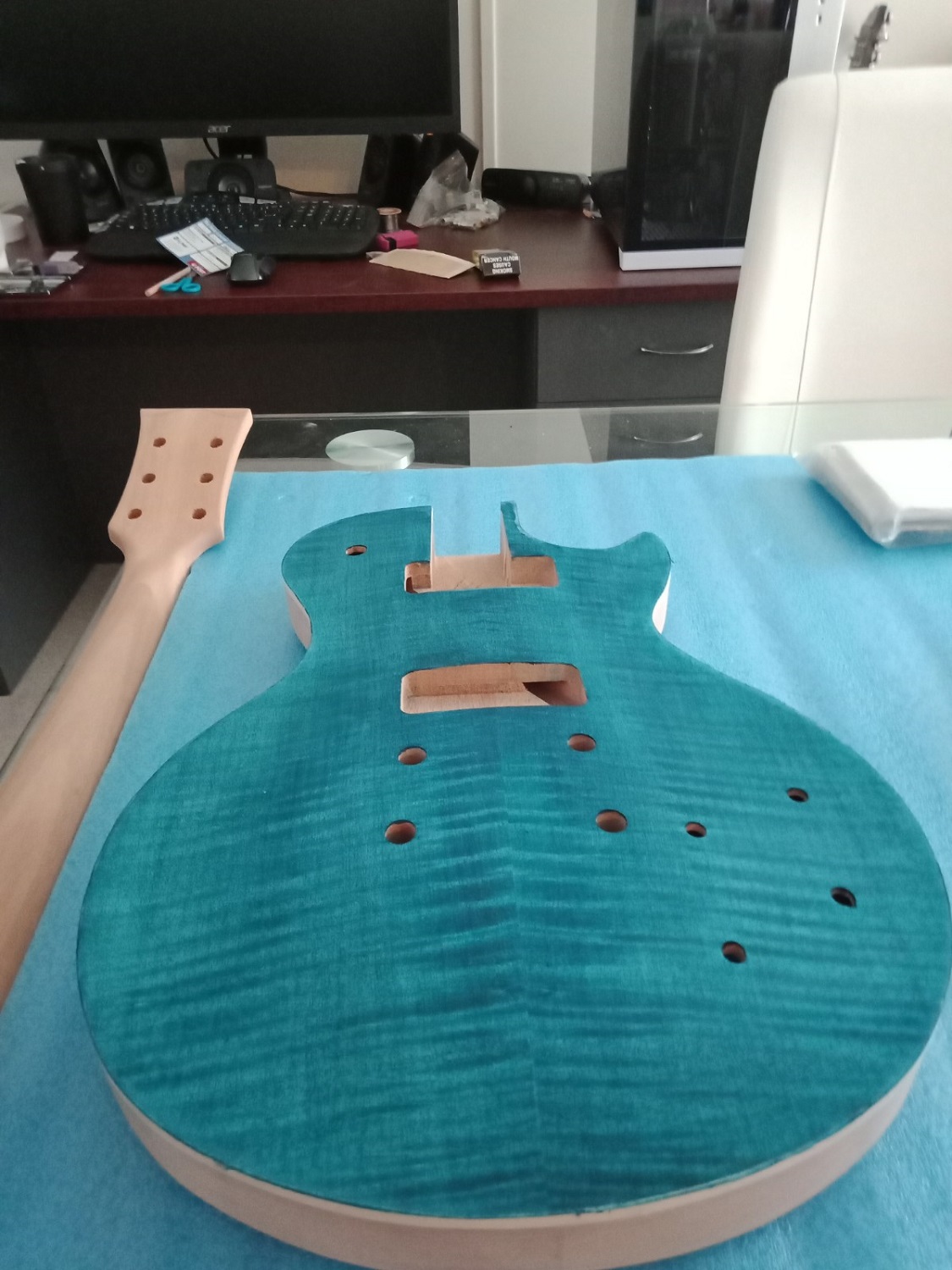

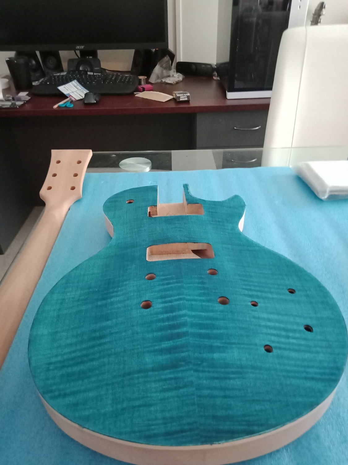

    i have just started this one i have used Rit dye colour is teal 2 coats mixed 120ml to a pack will be cleared in 2k as i have upgraded my compress to a 100lt 17cf and new mini gravity fed gun which is ideal for doing guitars

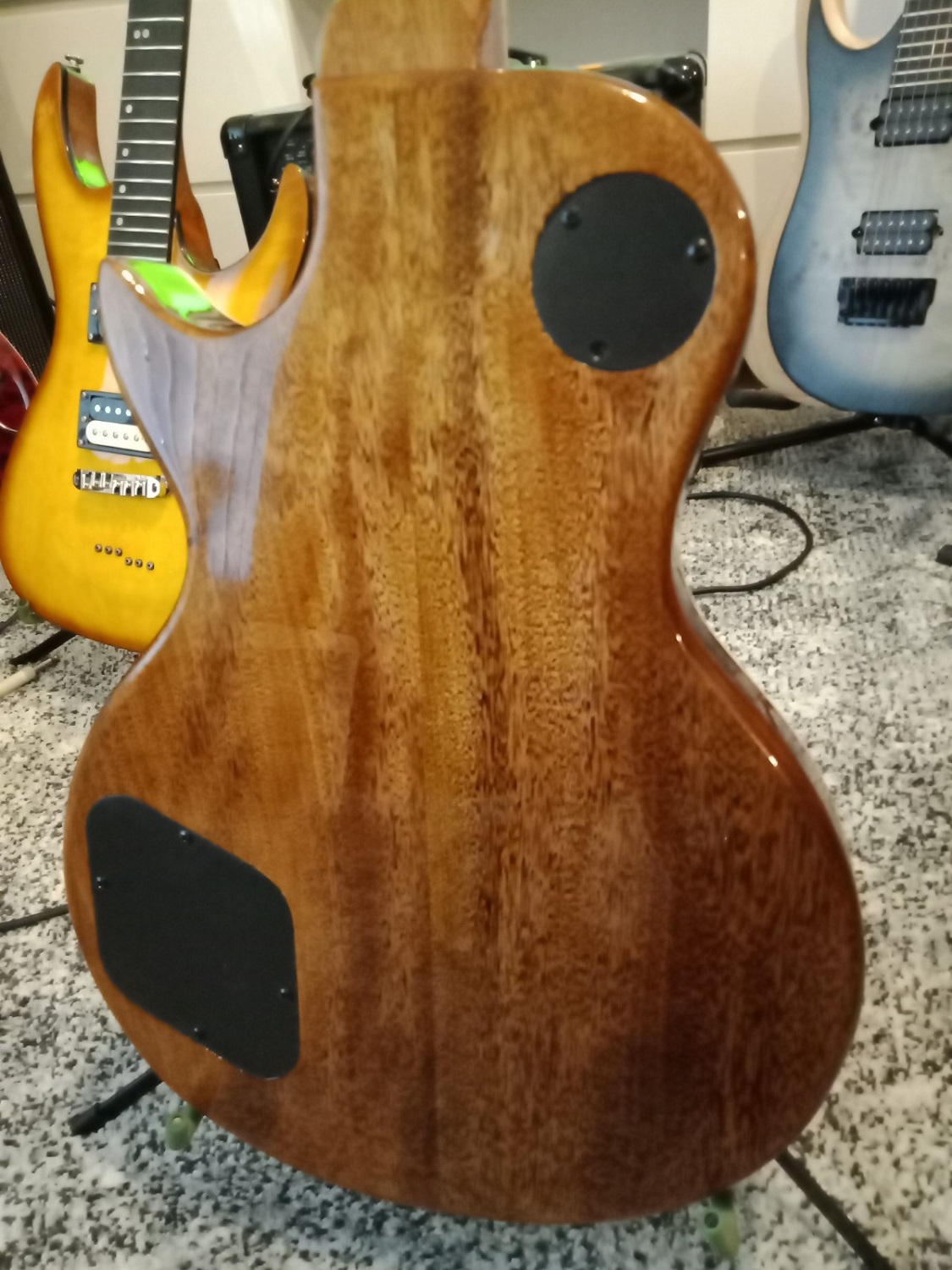

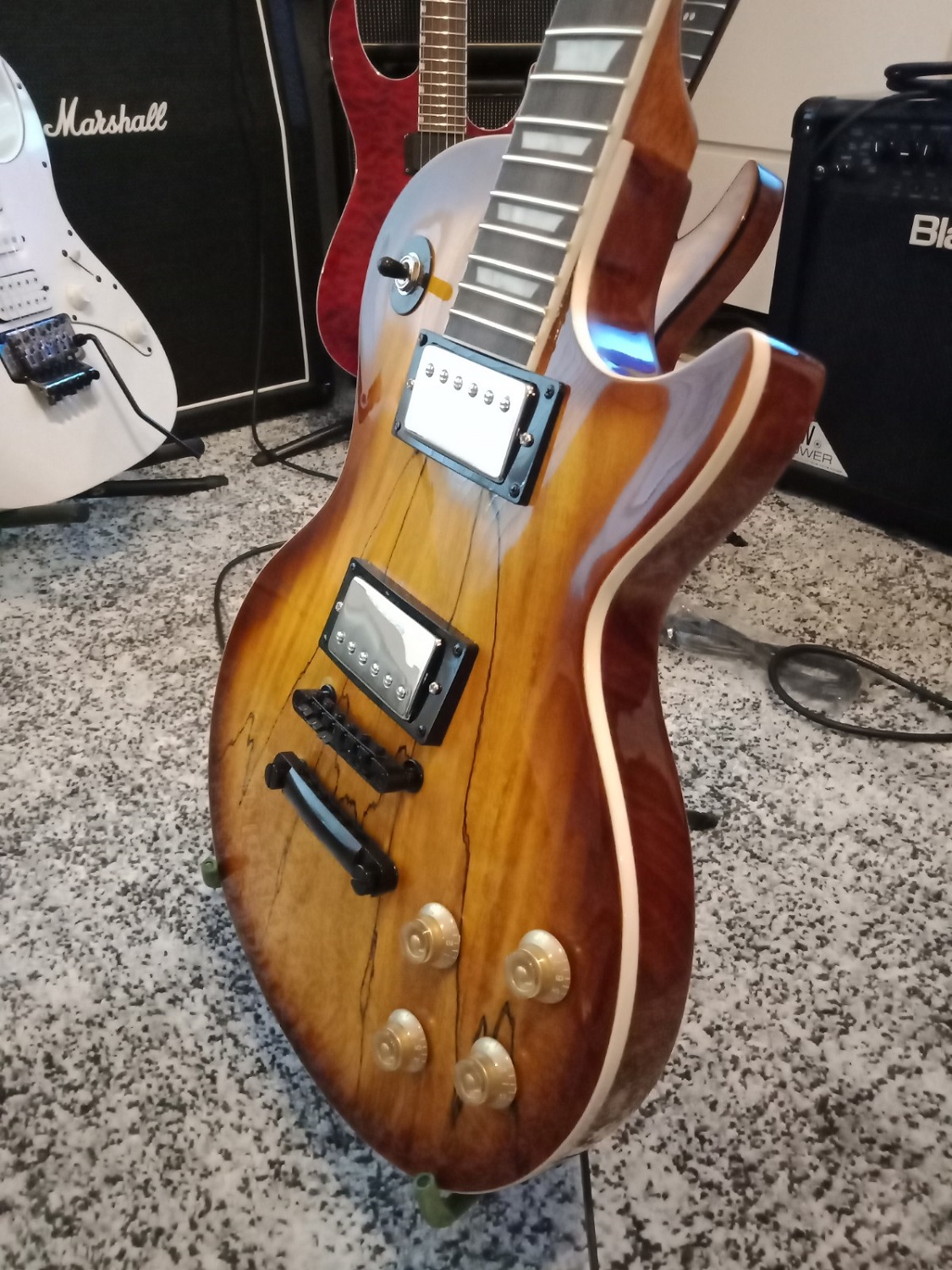

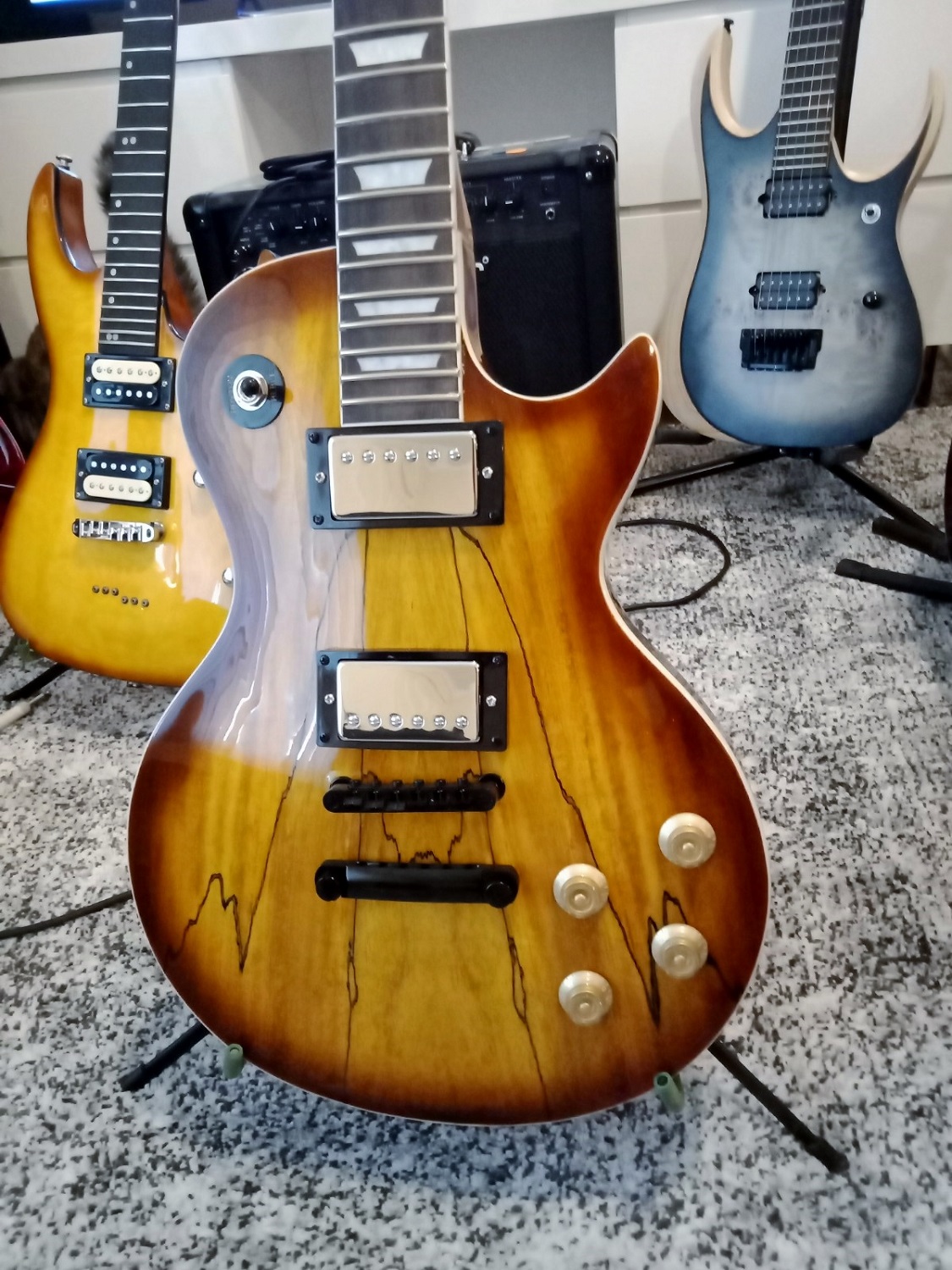

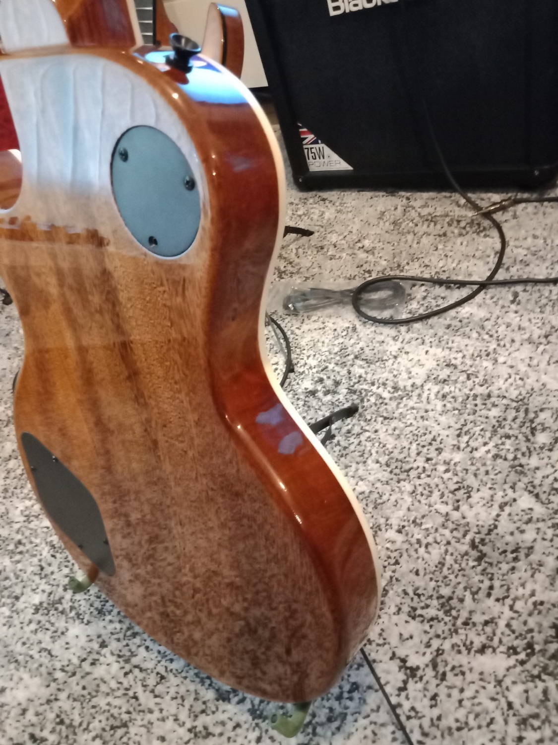

    pretty much finished just waiting for headstock detali done in 2k pretty easy one

    I saw those Marshall stacks in the refection!

    lol Andy got 2 stacks Marshall and a blackstar my house is full of bloody guitars and amps but everyone who has a les paul need a Marshall, i got me self a shed my lad put him up for me just need the floor done and then he's going to set it up as a work shop for me as soon as i can shoe horn him off his xbox

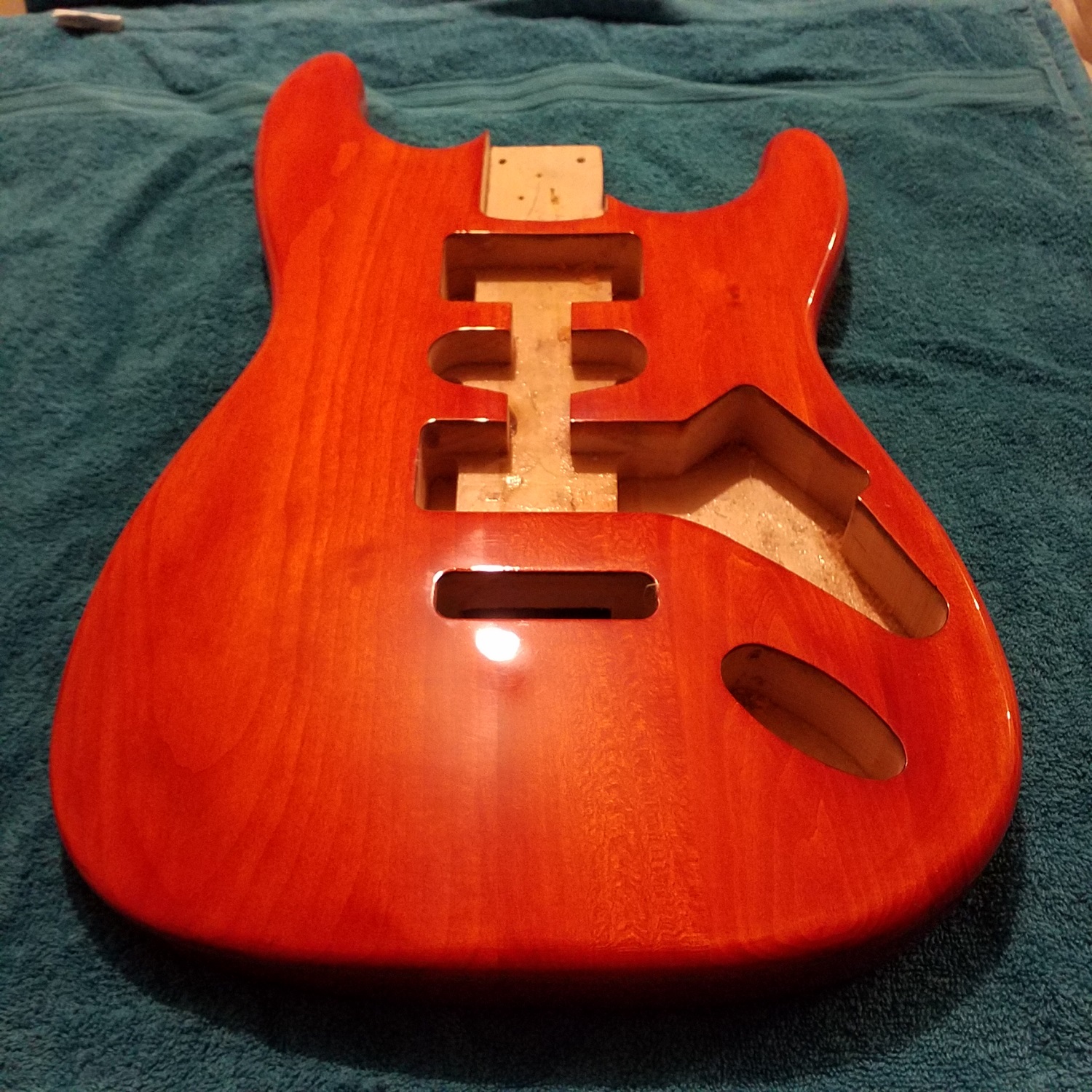

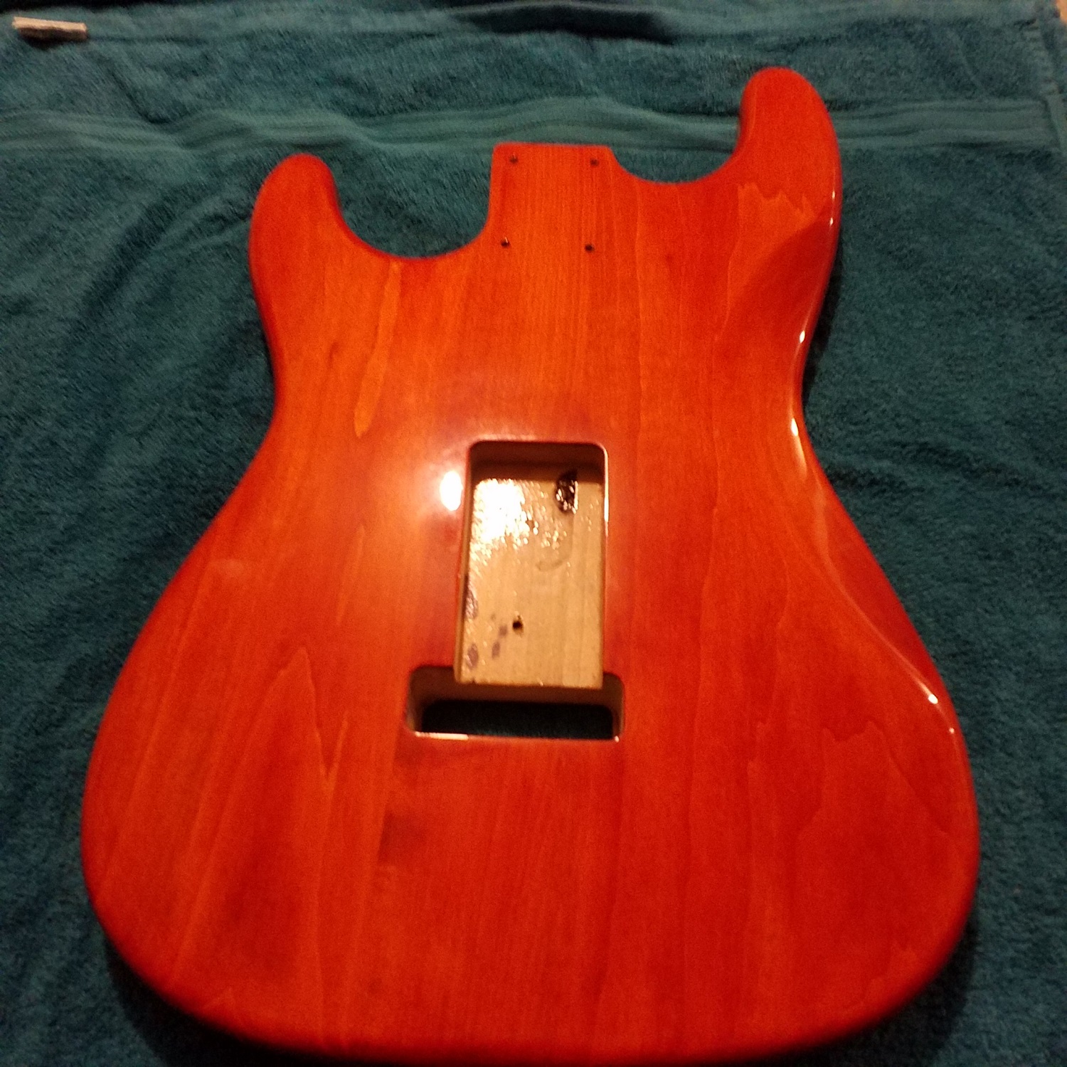

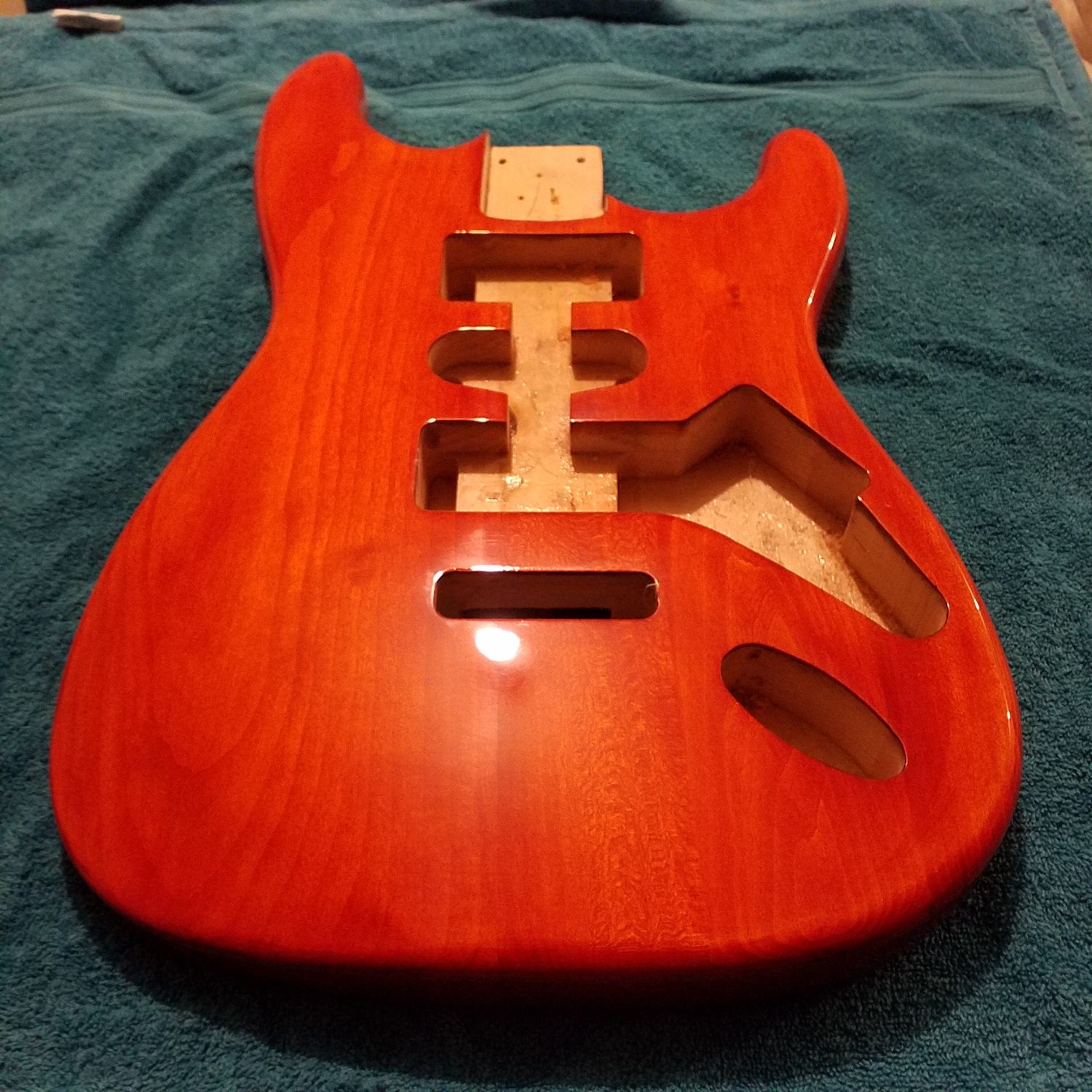

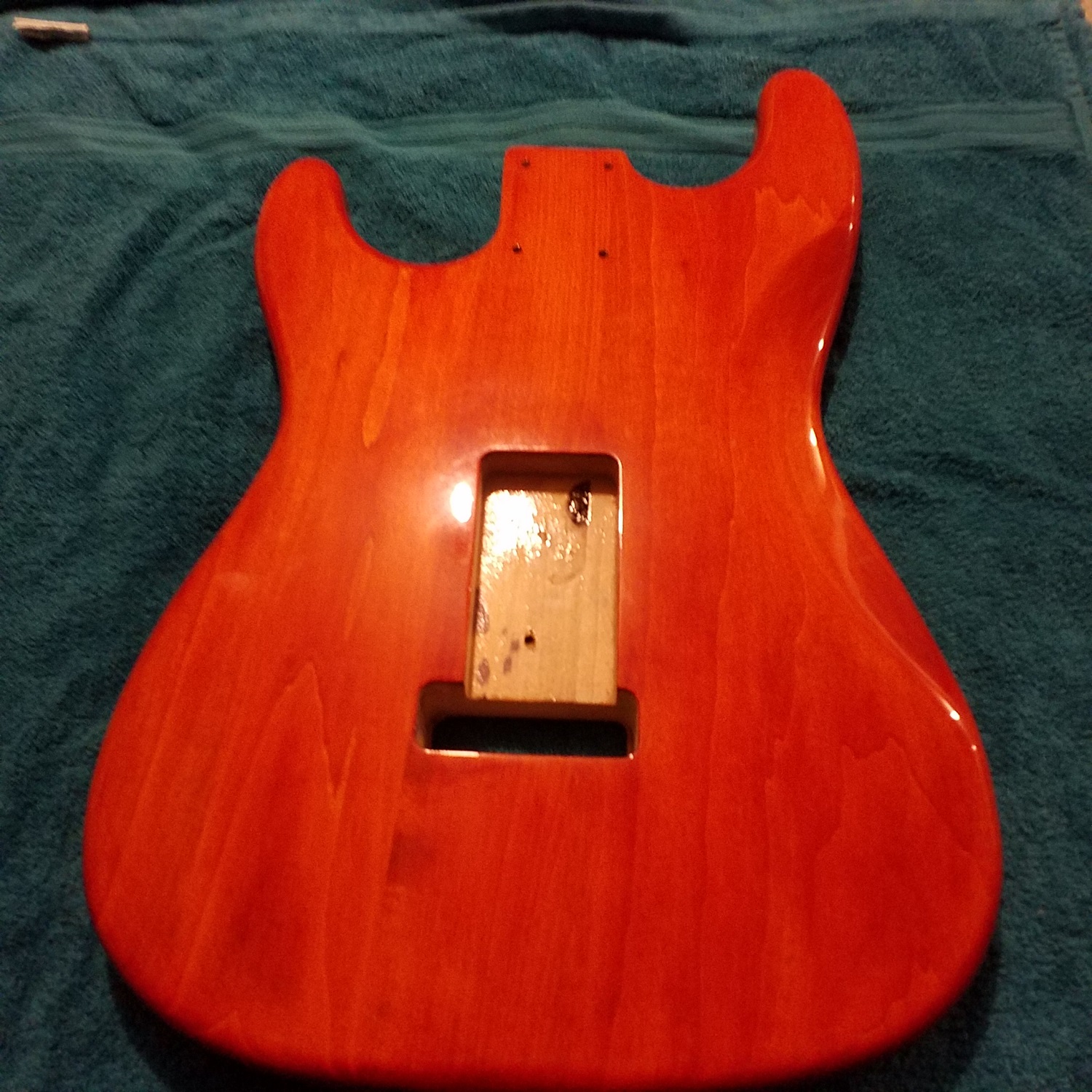

    hi guys here's a new colour i have been trying its rit dye orange mix was 1 box to 120ml of water i am currently working on 8 atm a couple i will be polishing in the next couple of days a strat tele, prs hollow body, jaguar, sg, jem and a hollow body
    here's a strat half way through polishing

    Nice Proz! I've got a box of the golden yellow I was going to try on a Strat neck. Curious to know how it keeps when mixed up?
