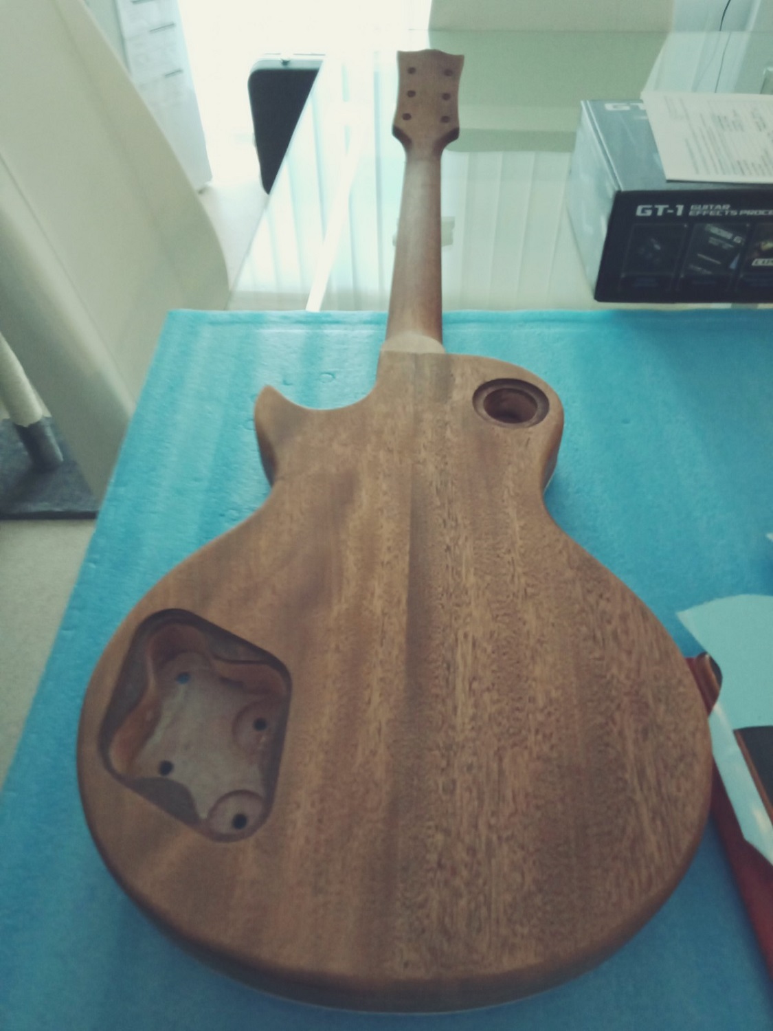

    my latest kit im doing, doing 4 kits atm its a PB LP1SS its rit yellow with brown burst and brown back its just about the clear stage couple off things i want to tidy up, ill probably clear it in the next day or so pretty simple one to do, not 100% sure if ill clear with lacquer or 2k leaning towards 2k atm

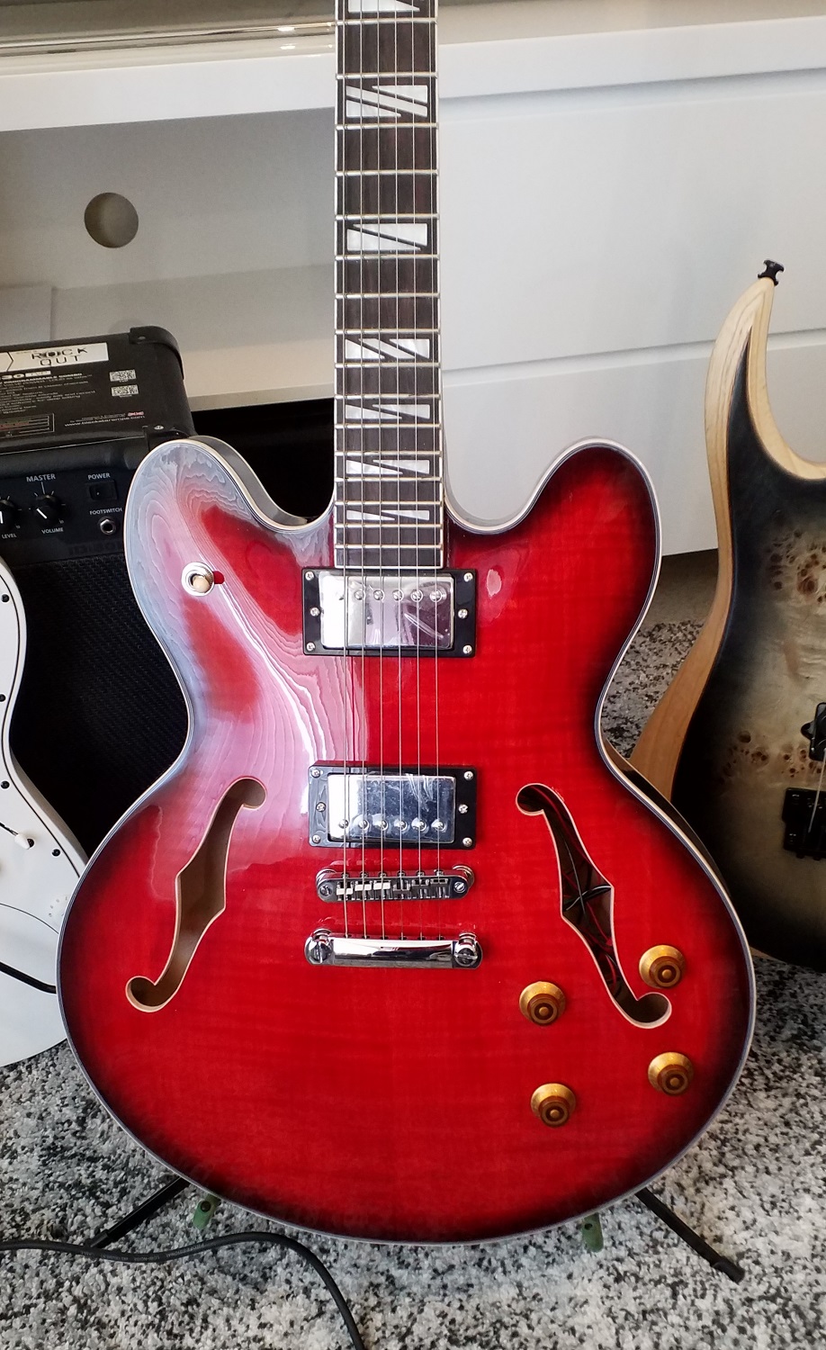

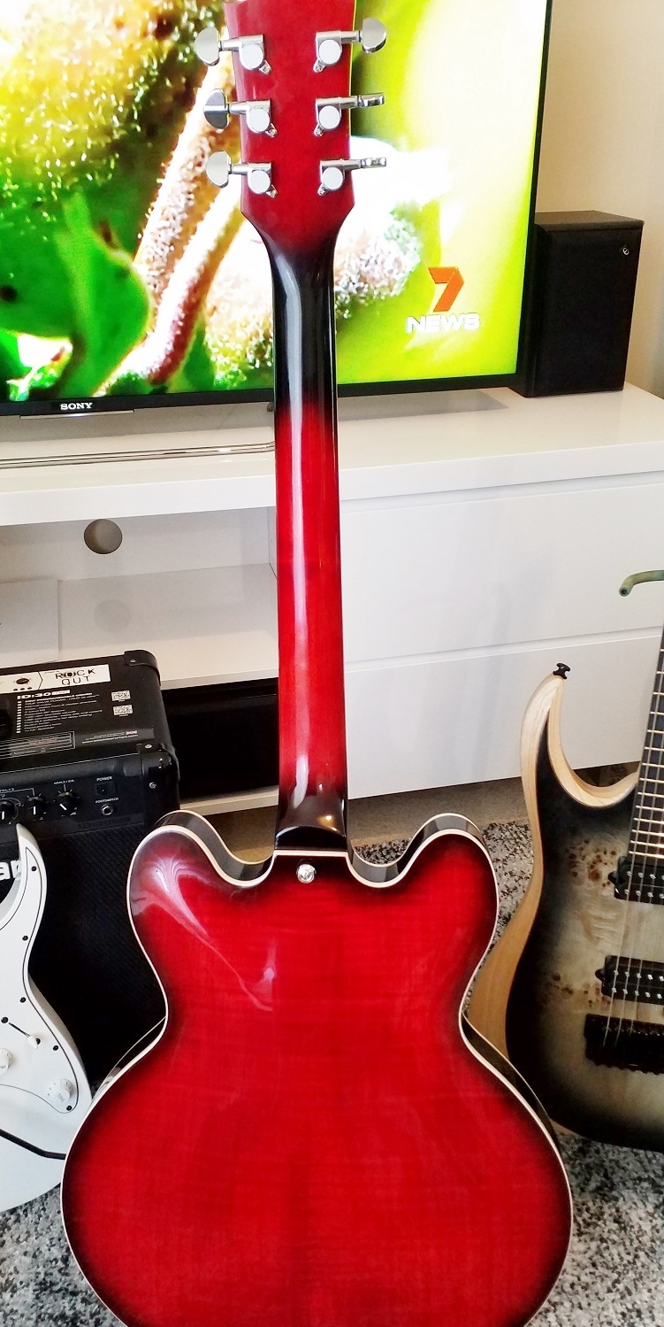

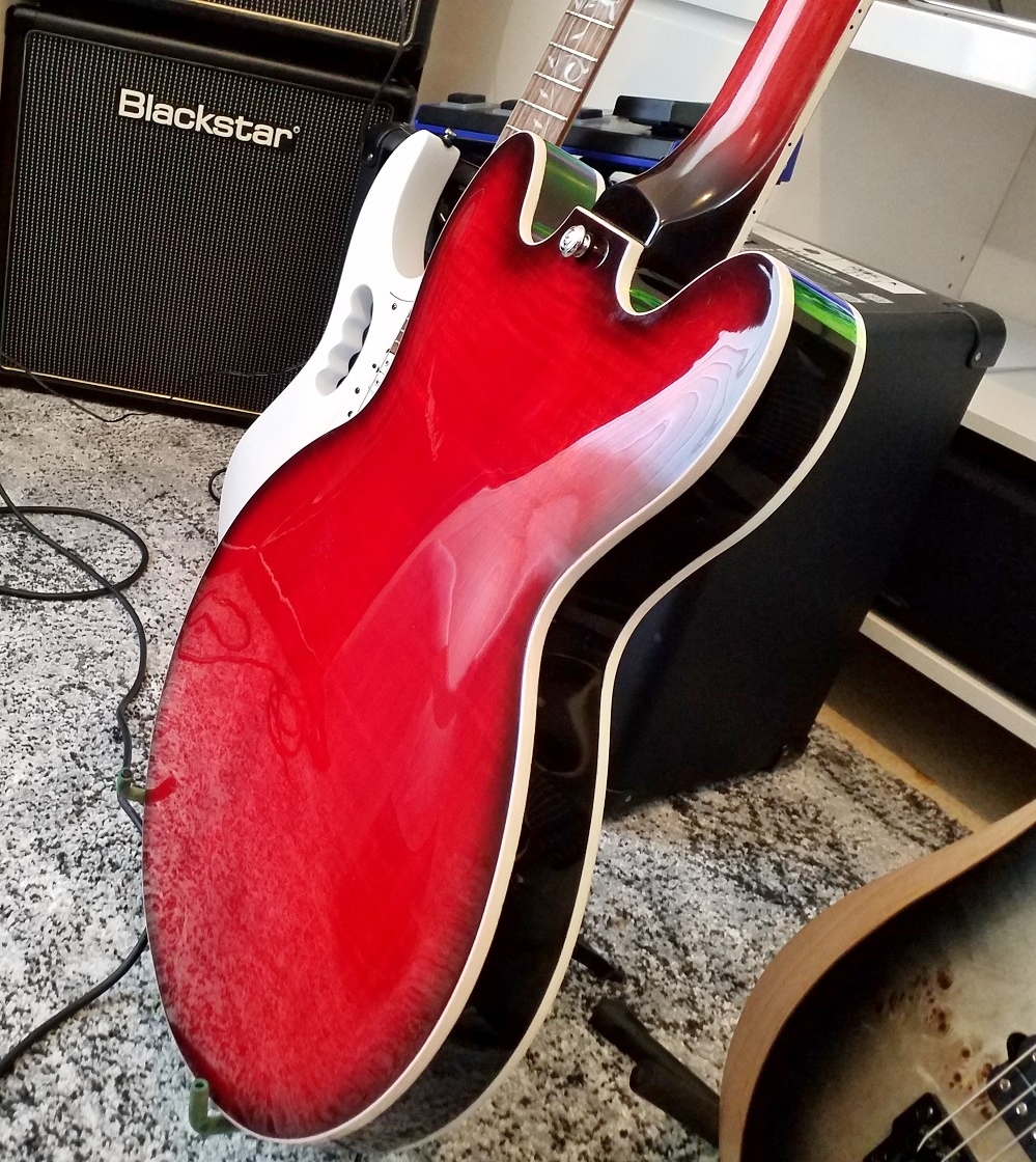

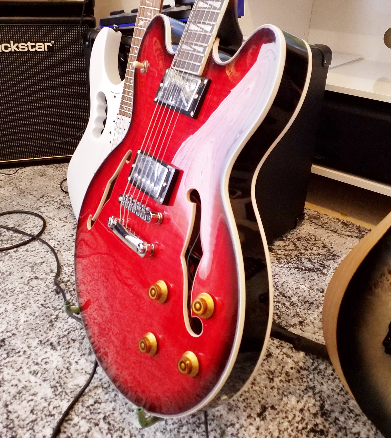

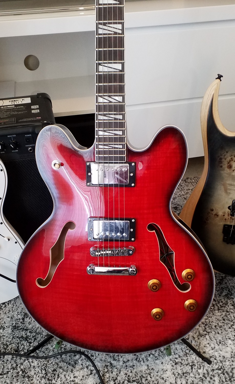

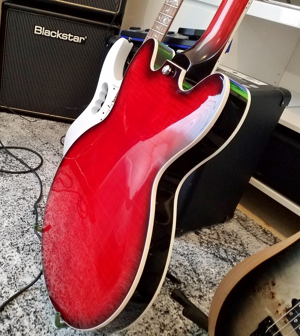

    Hi guys finally finished the hollow body has been a real pain, got 2 more almost finished SG and a jem this one has had its final polish and assemble getting the controls and things in the holes was pretty frustrating i got a nice even penetration of the dye clear was done with gun
    its rit dye scarlet with 50/50 black and clear burst 12 coats of clear pretty run of the mill but happy enough with it

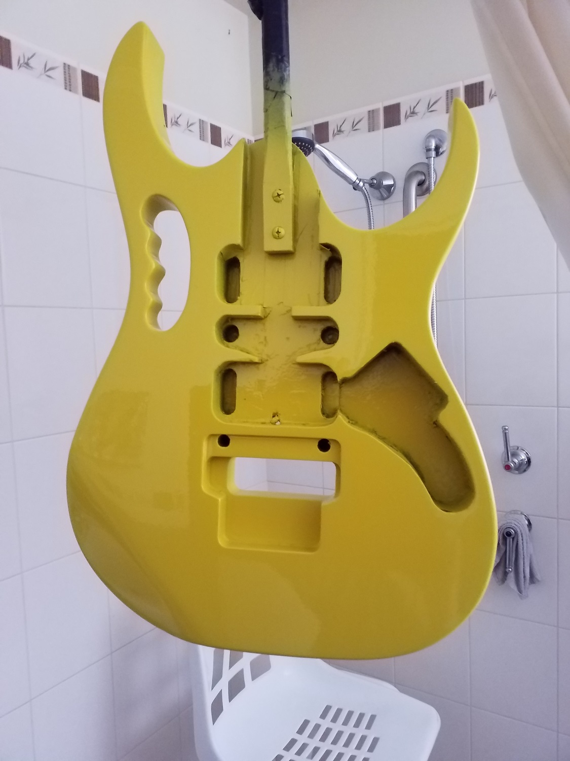

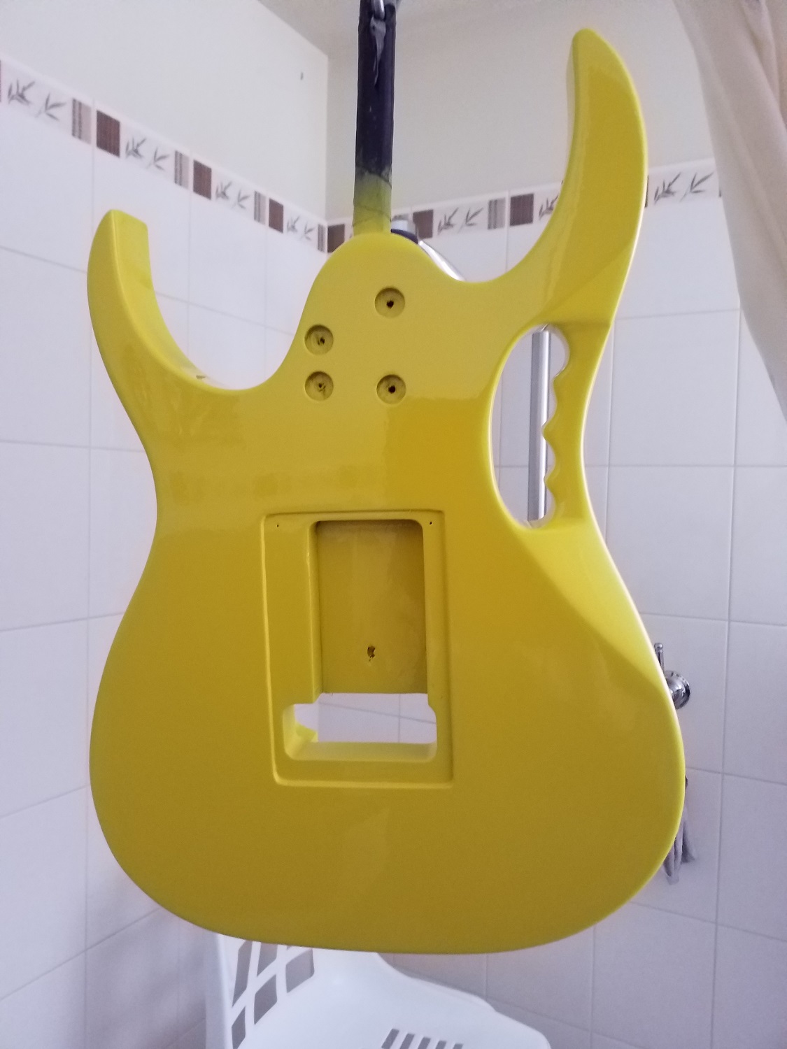

    here's a few i have been working on today first is a SV-1 jem it's done totally with rattle can used SCA paint yellow and clear paint has all been done 3 coats of yellow and 12 coats of clear i used bunnings sanding sealer then primer filler rattle can of SCA have got a black pearl pick guard
    heres the paint i used
    https://www.supercheapauto.com.au/p/...gment=1&page=1
    https://www.supercheapauto.com.au/p/...cgid=SCA011004
    and the sanding sealer which i got really great results with really good grain filler
    https://www.bunnings.com.au/feast-wa...ealer_p1564778
