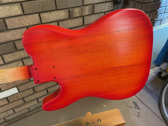

    Today the weather has been a bit cooler, so I have sprayed a red burst and got some final coats on. The red for the burst was Ubeaut water-based red dye mixed in with Cabot's water-based Poly. This seemed to have worked!

    Thanks Fender3x. I have put down another 5 coats today - that should be enough!
