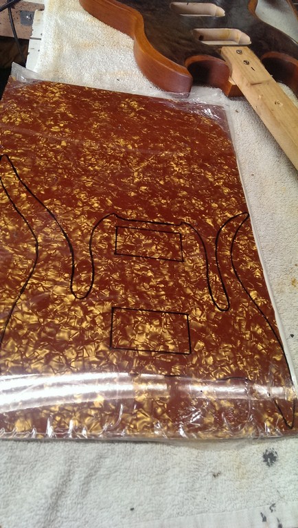

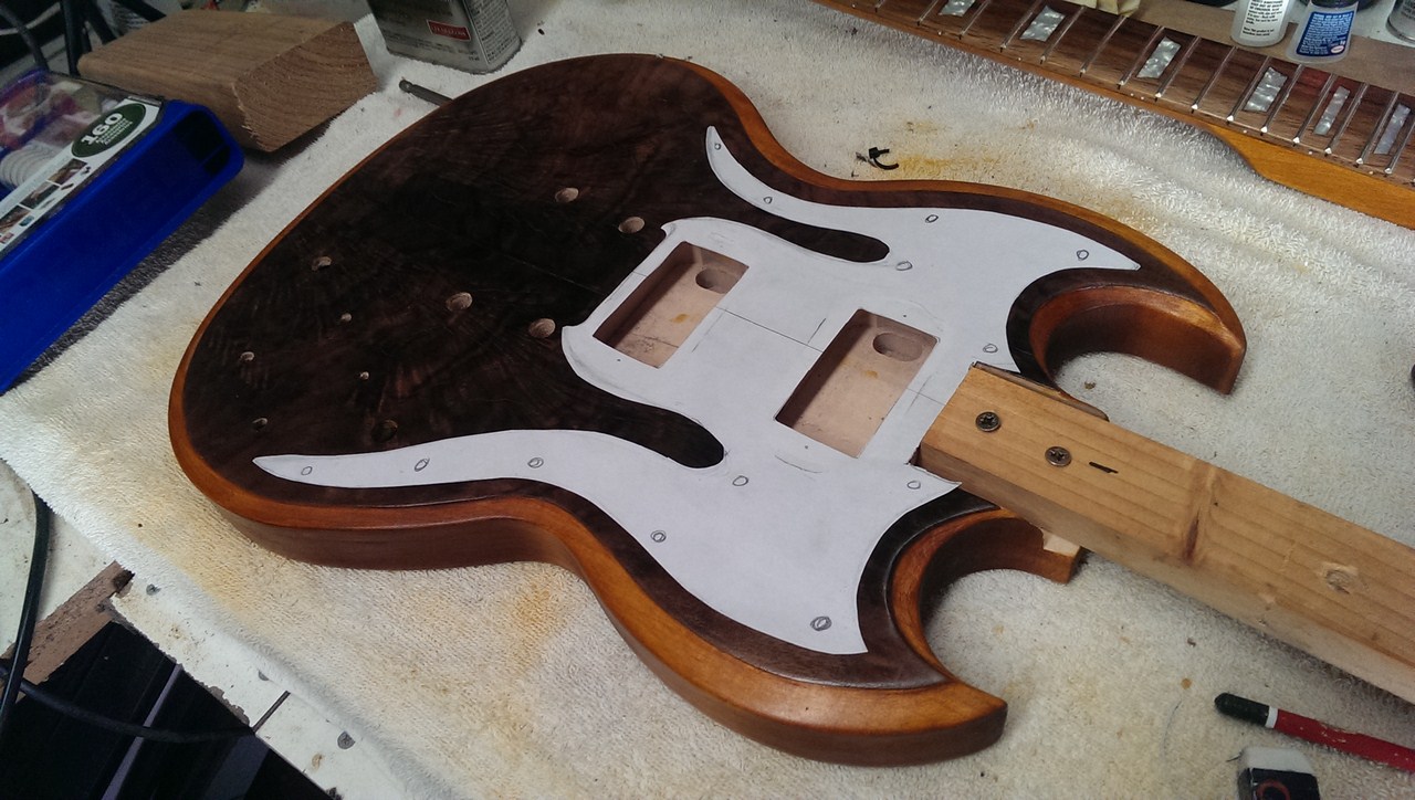

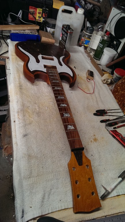

    Traced out the modded pickguard shape onto paper and cut it out. Placed it on the guitar to see what it will look like. Think it will be ok. very different.
    Comments welcome before i cut it out for real

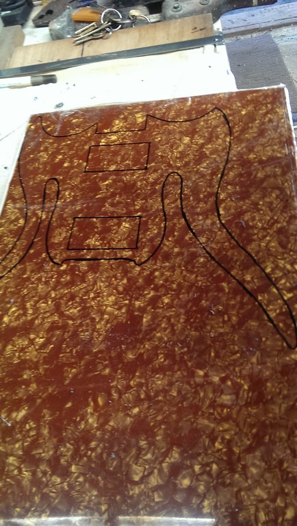

    Traced out on the pickguard blank.

  5. #225
    cool shaped pickguard Nitro, is there any way to make it a bit smaller as you are covering a fair bit of that veneer ?
    mock build looks great
  6. #226
    My thoughts as well. You've spent a lot of time on that veneer and now you're covering most of it up. You could simply loose the top wing, unless you now need some pickguard there to mount the pickup selector switch.
  7. #227
    Your axe but I would go naked after all the hard work doing the veneered top. Could end up with too many competing patterns on top that may detract rather than enhance. Sometimes less is more if you know what I mean?
  8. #228
    Jun 2016
    Mount Gambier Australia
    1,171
    Ok will play around with the design tomorrow, cheers
  9. #229
    Jun 2016
    1,171
    Yes Simon i will be mounting the 3 way selector switch at the top of the pickguard like on a Lez Paul, but i can reduce the size by cutting back the wings
  10. #230
    Jun 2016
    1,171
    Would love to do that but because the routed holes for the pickups were to big for the sort of pickups im mounting, it was easier to add a custom pickguard than to partially block the holes
