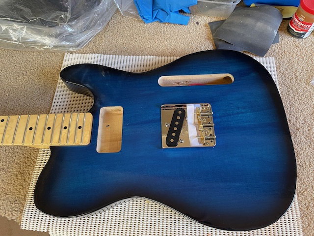

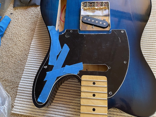

    Today I have added the neck and the bridge (a Wilkinson Ash tray). Checked that the strings will be aligned down the neck, and that I can get the 648 mm scale length. My other tele builds have string lengths of 648 for the high E, to 654 on the low E - so I just set these from the start and hopefully they will not need much changing for the final setup.
    Also decided that I'm using a black pickguard (I think I made this originally for my TLA-1). It needed a bit of filing, sanding, and scraping to get it to match the shape of the body.

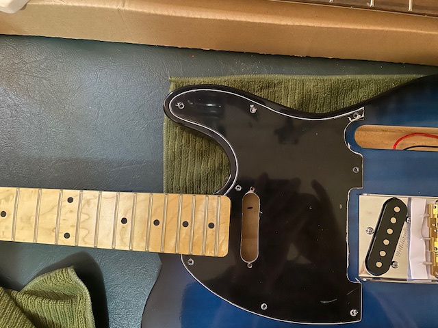

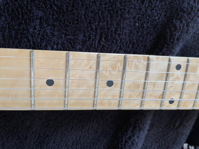

    The blue tele has now been assembled, and rough tuned to allow the neck to settle.
    The neck was finished with tru-oil last year! It was originally meant for another build. The logo is vinyl sticker from Cricut Joy machine. It looks like the maple is quilted slightly.
    The body is stained with Ubeaut Blue dye. Then 4 coats of Cabot's water-based polyurethane, a black burst of 2 coats of Cabot's water-based black stain and varnish, then 4 more coats of clear poly clear. (I should do more final coats of clear next time).
    Bridge is a Wilkinson Ashtray. Custom Pickguard is 3 ply.
    Besides the bridge, this build was basically from left-overs and spare parts. I really wanted to trial the blue dye on basswood, and practice spraying a burst!

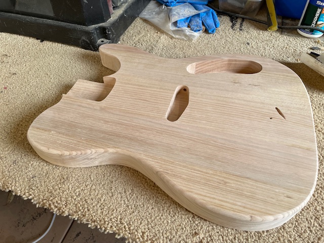

    Started the last tele bass for this thread. This one is having the Victorian Ash body that I laminated last year. The neck is a PB maple neck with a rosewood fretboard. I have shaped the headstock and changed the nut to a bone.
    The plastic nut was well stuck in - I scored the edges, light taps with a block and hammer, and pulled it out with pliers but it left a big section of plastic in the channel. I ended up having to use a precision screwdriver as a chisel and chisel the old bits out. It worked

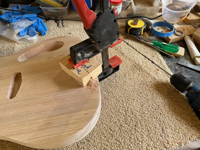

    Routed the neck pocket, pup cavity and control cavity. This one is not having the normal tele control plate - but more like the thinline pickguard and controls. Also drilled the jack socket recess, the channels between the cavities, and the channel for the bridge ground. Finally, routed a quarter round edge to the top and bottom and a bit of sanding to 240 g.
