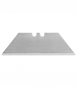

    I can try the razor scraping method too. But in india the razors blade look very different from razor blades that are available in america as I see in videos
    Do u think I can do it with ones available in India?

    With regard to the razor blade. I was definitely referring to the "American" type. We have what you call the "Indian" type too...but only for shaving. I would worry that it might be too flimsy for this usage. If you can't find the American-type razor blade how about a utility knife blade?
