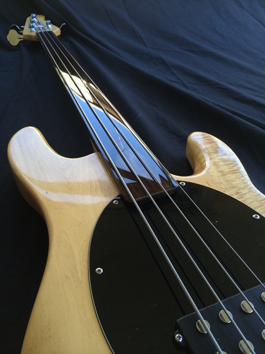

    Finally Finished.
    Although I am not 100% happy with her (never am) at least I now have a fretless bass.
    In line with my full disclosure policy, although the fingerboard looks OK, after only 4 or 5 hours of playing it is showing minor scuff marks. The main problem is that I am not yet used to using horizontal vibrato and I am still in the habit of string bending vibrato. My guess would be that as I can easily buff them out they are only cosmetic, but because of the high gloss finish ANY mark will show when caught in the right light. This is not a problem for me as appearance is not that important so when the scuff marks get bad enough I will rub down the FB with 2000 grit and give it a matte/satin finish which should hide these minor marks.
    Would I do the epoxy thing again? Most definitely! Just next time I will leave it as a matte finish. In my opinion there is no way that an untreated Rosewood FB would stand up as well as epoxy. At least she looks OK for the photo shoot.
    I just did a few minor mods to this one. Took the headstock from 4 in-line to 3x1, epoxy fretless fingerboard (obviously), string through body ferrules, a bone nut and some fairly serious modifications to the body cuts. All other hardware, i.e. bridge, pup and electrics are all kit standard. The only thing added was the non-standard 4th machine head.
    As my bass amp is on full-time loan to my church I have not been able to hear her in full song. At home I usually practice my guitar through an fx pedal and earphones and through these cans the bass is distorting quite nicely, so I guess that I am getting a good strong signal. So I am looking forward to trying her out in the near future. I will decide then whether to upgrade any parts.
    It has, at times, been a frustrating journey but immensely rewarding. Whenever we try new things we run the risk of failure, but that is how we learn new skills. Bring on the next project.
    Cheers guys and gal and thanks for all the encouragement.
