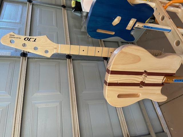

    Sprayed 9 coats of Cabot's water-based gloss Poly onto the body and headstock of the laminated tele bass. Also gave the neck 3 coats of gloss poly and 3 coats of satin.
    I'm starting to get a feel for spraying with a compressor and gun, the gun controls, the time between sprays, viscosity of poly, cleaning the gun etc. Still got a lot to learn though.

    Looks great. How are you liking the water based poly? Did you thin it at all? Also curious what the woods are that you laminated.
  5. #195
    2,025
    Thanks Fender3x.
    I am liking the water-based poly. It has very little smell, and easy to clean up! (But I have not sprayed any oil based, except from rattle cans). I have been thinning the poly by 10% (as per instructions) to about 20% (if the mix seems a bit viscous).
    The wood is radiata pine with Jarrah strips. I carefully selected the Jarrah to be quite red (it can vary to a dark brown also). The pine is soft but I like the patterns in it. In fact, I have used pine for my scratch explorer (now 30 years old) and all of my scratch tele builds, and also for lots of the furniture I have made (beds, desks, drawers, shelves).

    Wow, just looked up Jarra...it's harder than maple. Is it as hard to work as maple? Awfully pretty tho. Would make a nice fretboard....
    I only see Radiata pine here in high quality plywood. I have used it quite a bit for speaker cabs.
  9. #199
    fender3x: *most* of our hardwoods are harder than maple. good for fretboards and accents to bodies/necks, but way too heavy for a guitar body. hunting through piles of decking timber is a good source. With a bit of digging you can usually find a piece of quarter sawn
    My Epiphone has a radiata pine body. After the shoulder pain caused by the SX it was a welcome change.
  10. #200
    2,025
    I have normally used repurposed jarrah (most has come from kitchen renos!). It is hard to cut, but with a good saw it is fine. It is nice to turn. I have used it for small crafty things only. I do have a jarrah coffee table made by my Grandfather.
    Quote Originally Posted by Rabbit View Post
    A friend of mine purchased a jarrah bodied flying V from a local producer about 12 years ago. It weighed a ton! But, looked great.
