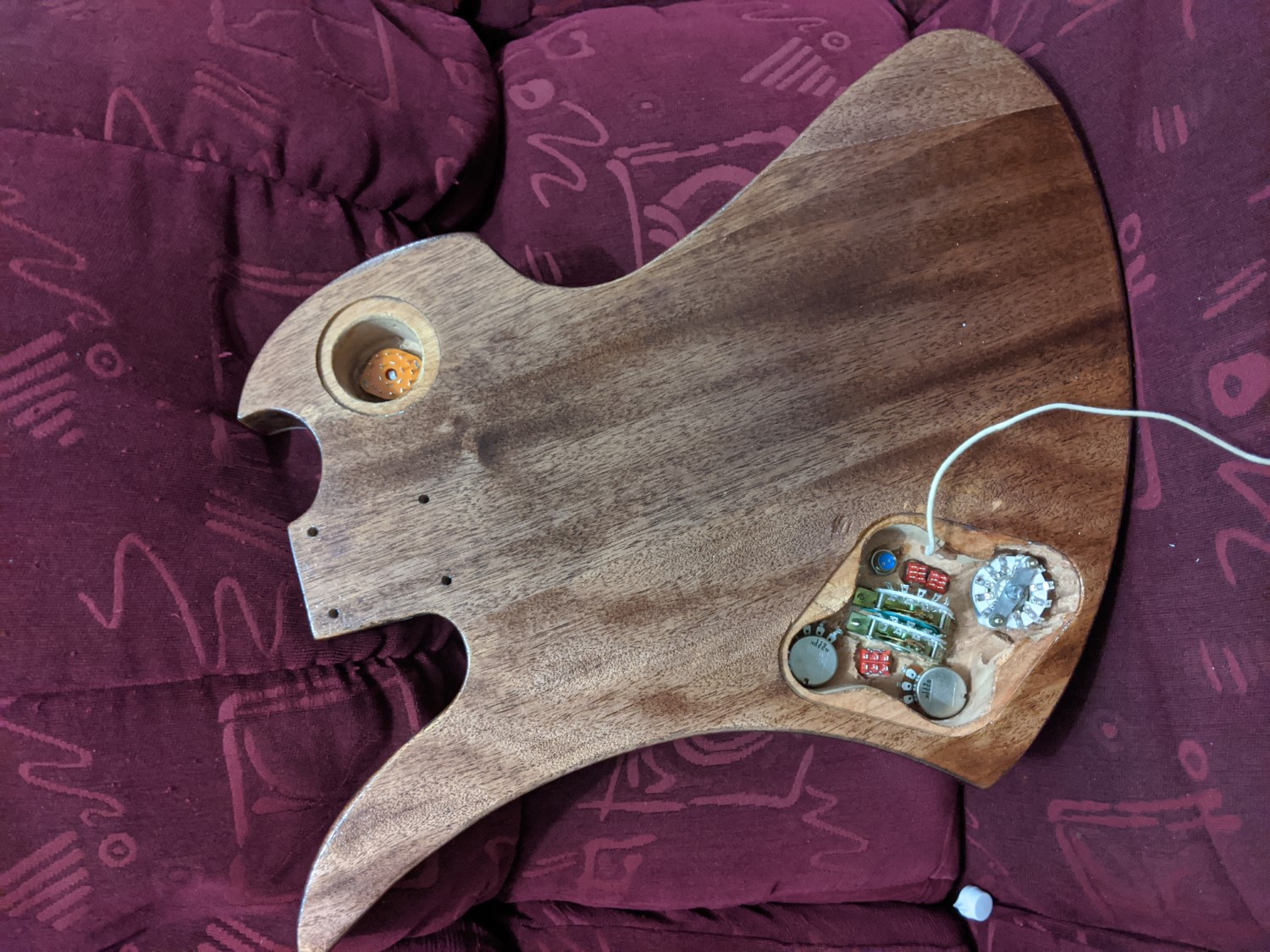

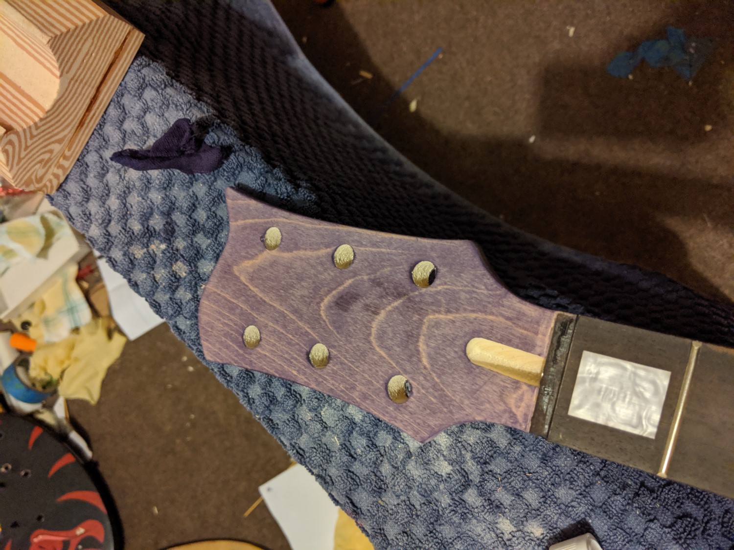

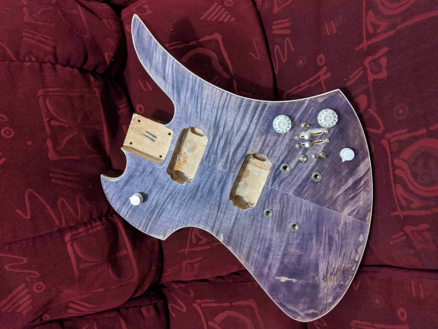

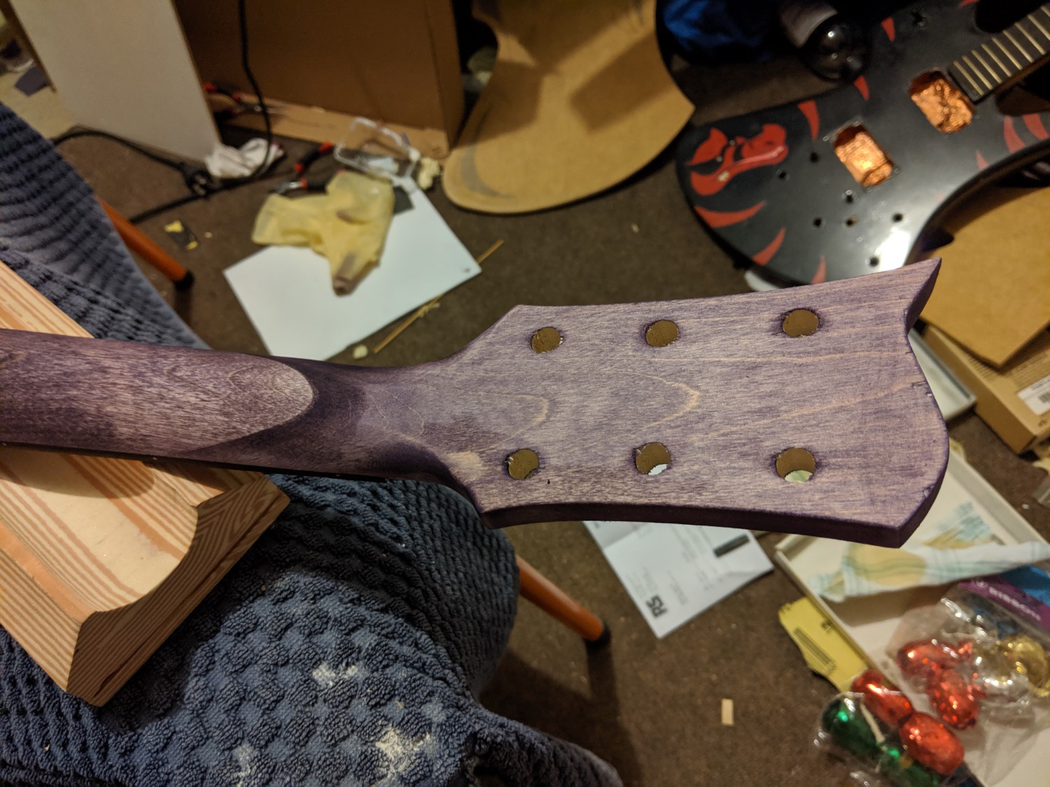

    And so it happened again. I had other plans lined up, and was thinking of either a Baritone Thinline Tele or a Singlecut Hollowbody, but then dangit, this thing came up. I haven't got it yet, but I'm excited to start this one so am starting the Diary a little early this time.

    I believe the listing was that it was a cancelled custom order. So with my penchant for Mockingbirds, the flamed top and headstock grain being really interesting, and since the Mockingbird STQ that I used to have didn't have a neck that I liked, I snapped it up, and thought I'd take cues from the STQ and play around with them.
