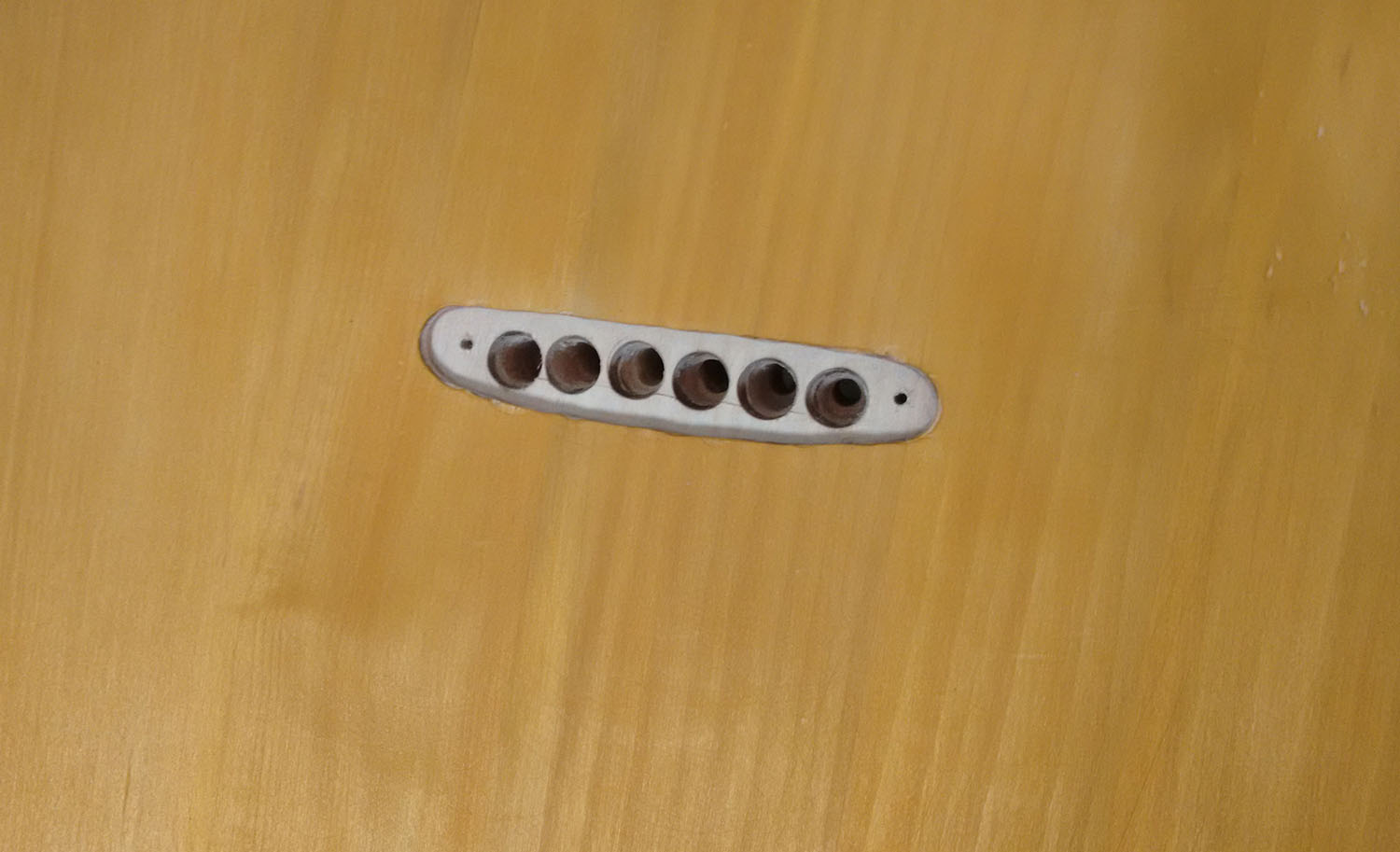

    Sexxi Phat curves!
    Cheers, Andy.

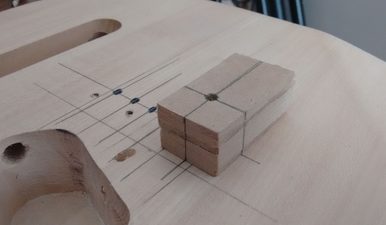

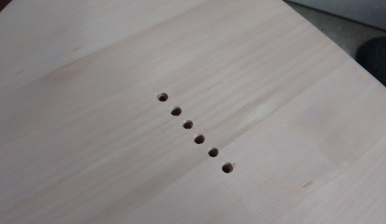

    I'm continuing the theme I used on the strat-tele build.
    Which reminds me, I made a pig's dinner of the string-through holes.
    Browsing the youtube, I came across this one....
    https://www.youtube.com/watch?v=5SZA03DVITA
    I may test it out on something non-important first.
    cheers, Mark.

    Brilliant video. I will need to do one of those jigs for when I plan to do string through as part of an upgrade to both of my Tele's.

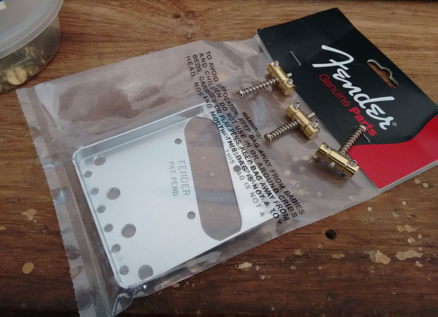

    A couple of items showed up in the post today.

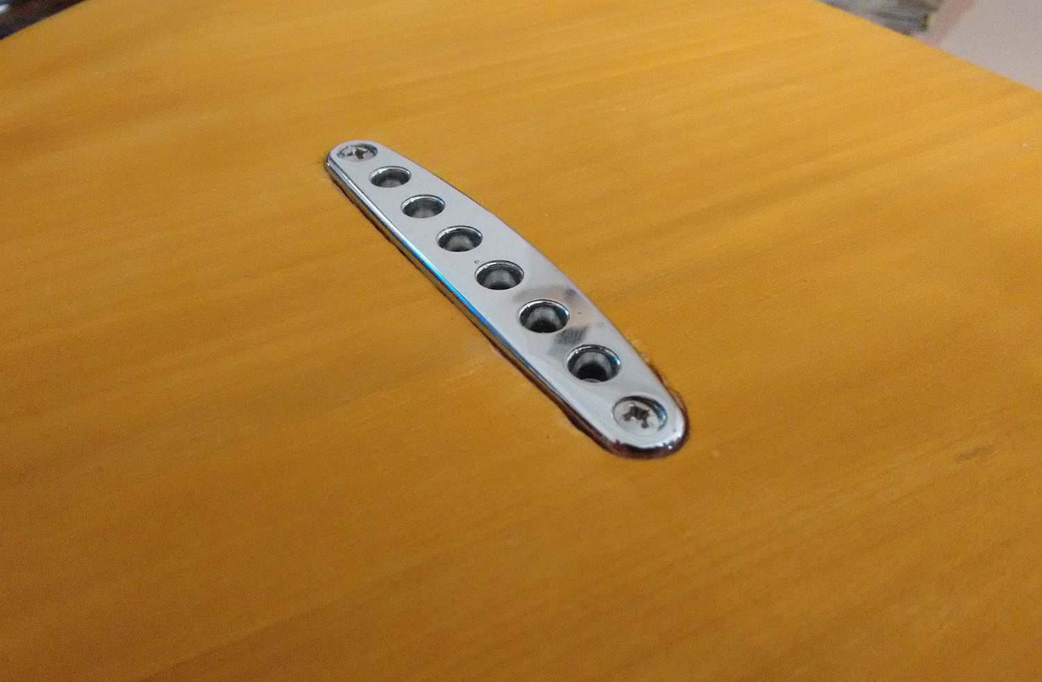

    The saddles from ebay were described in the main title 'compensated'.
    However when they arrived I found it not so. Going back to gander at the pictures and I should have moved on.

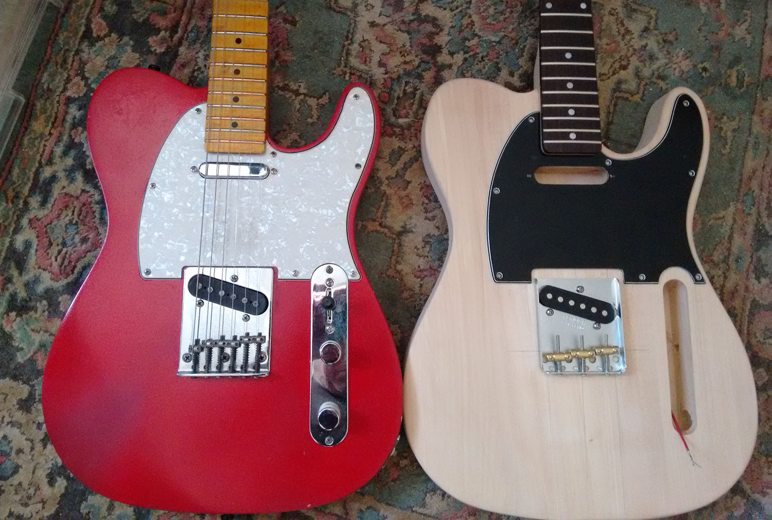

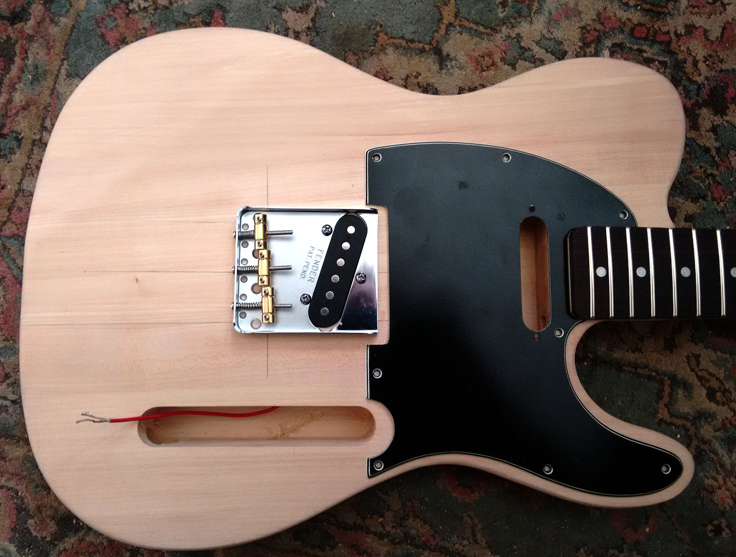

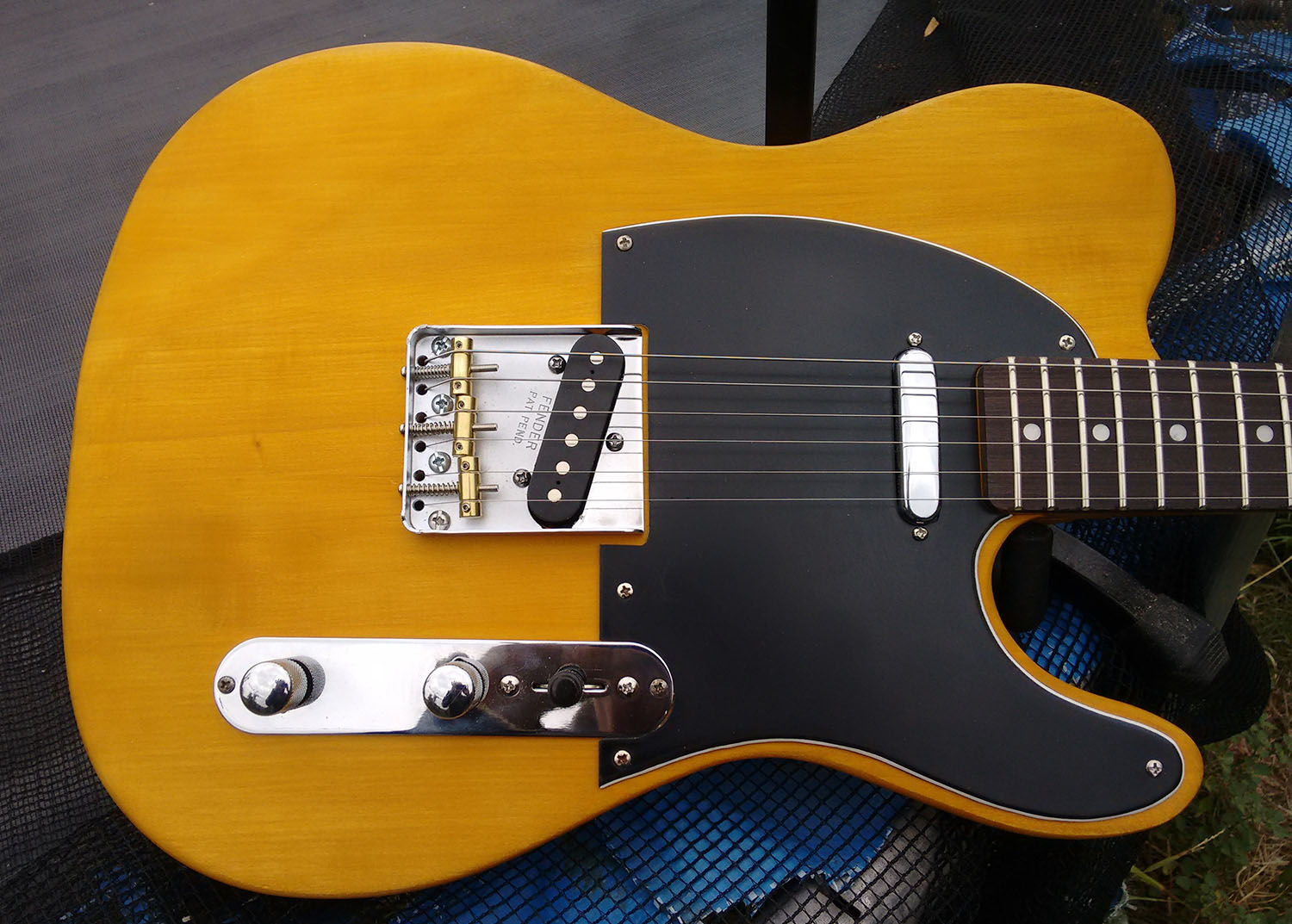

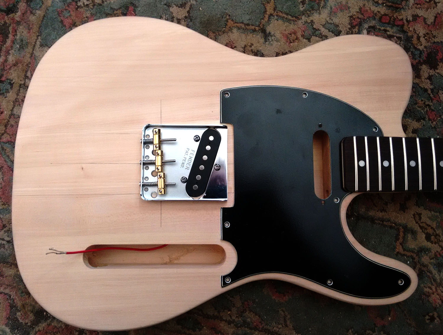

    Anyway I have had a look at the 'issue' some folk have with the bridge placing.
    Compared to the Squier Telecaster, this one seems about a centimeter longer.
    The black scratch plate is original Squier, yet when placed tight to the neck pocket, the bridge and controls are a centimeter further south.
    I've compensated somewhat by screwing the saddles further back than ideal.
    Probably cut a scratch plate a tad longer front to back also to bring things into visual proportion.
    cheers, Mark.

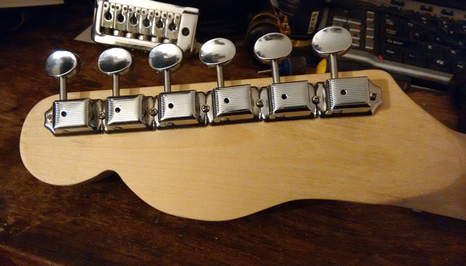

  12. #10

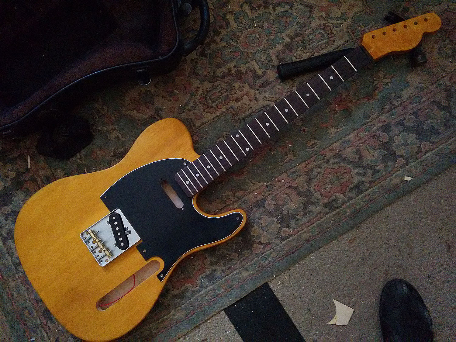

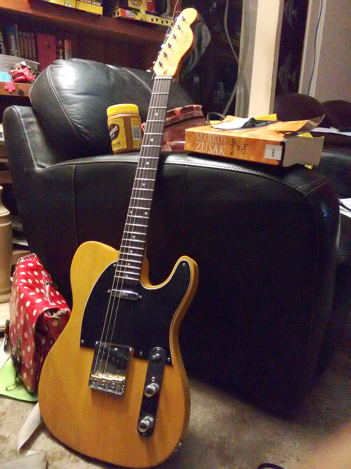

    One last one until some hardware arrives.
    cheers, Mark
