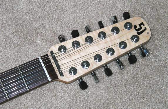

    what & where do these bits go???
    That is a bar style string retainer, it goes on the headstock in between the nut and the tuners. I'm more used to seeing them on guitars with Floyd Rose bridges and locking tuners, but I imagine on a 12-string guitar it will help with tuning stability

    String retainers are often on FR and other floating bridges to stop the strings popping off the nut on wild bends... on that 12 string, though, all I see is another friction point where you least want one?!?
