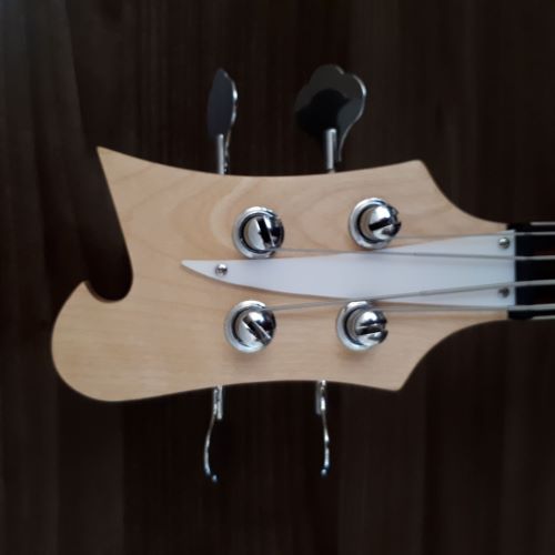

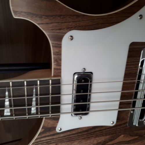

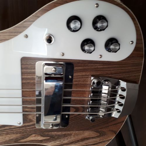

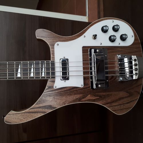

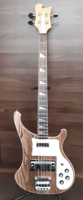

    Hello
    First of all I would like to give my special thanks to Pitbull guitars for the opportunity to
    work on two projects of RCA kit !
    Please find below some pictures and a specification of my second RCA project:
    *) Body - Ash ( Pitbull ) Oil wax satin finish
    *) Neck - maple + rosewood fingerboard - transparent semi gloss oil and wax ( fine satin finish )
    *) Pickups - Roswell ( both Neck and Bridge )
    *) Tail piece & bridge - All parts
    *) Tuners - Pitbull
    *) Pickguard and trust rod cover - redesigned by me. Made out of opal PMMA
    *) Toggle switch - Rickysounds
    *) Controls
    2 X volume pots - Alpha 250K
    1 x bass tone - Alpha 500 K
    1 x treble tone - CTS 500 K push/pull ( Changing Modern to Vintage sound )
    *) Nut - TUSK
    *) Output - Stereo + Mono
    *) LOGO - No logo by purpose !
    regarding the logo - my first project shown in Rocktober has got a comment that there is no any logo !
    Please kindly note that I feel unworthy to place any logo on such iconic model but if you wish to have a logo, then
    please consider it as "TOKO instrument")
    So far so dully Here comes the pictures:

    Nice Finish. Makes me double think my own finish options. Great job!

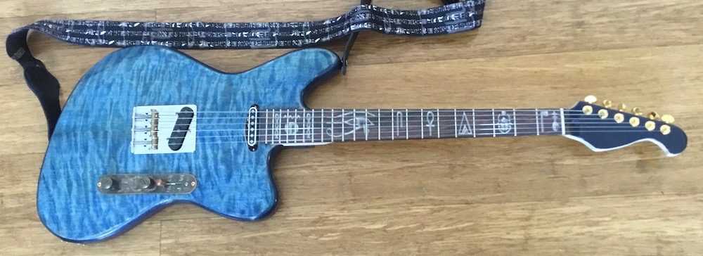

    The Sphinx looks so good Chris!

    Hi, Thank you for your comment ! I appreciate it
    I use oils OSMO oils + waxes for finish of my guitars
    https://www.osmouk.com/
    If you wish you may try them. They offer matt, semi matt and glossy oils with wax as well as different colors
    but you have to check whish oils and color suit to which kind of wood. It is described in OSMO catalogue.

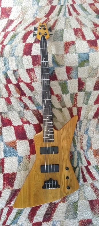

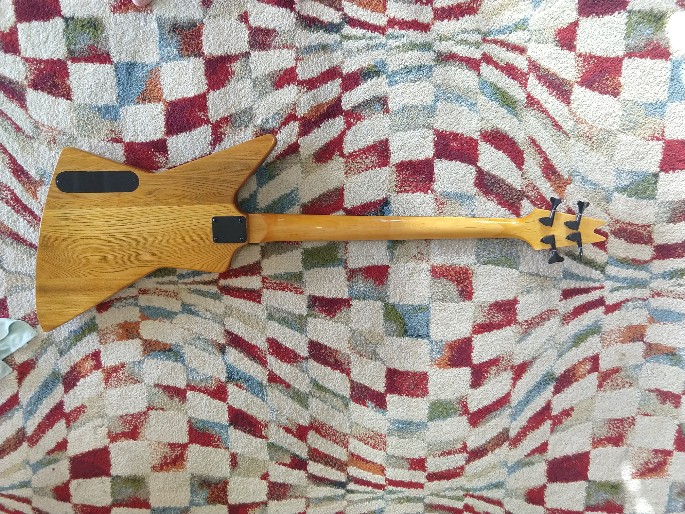

    Well it is said it takes a community to raise a child, so here is our bad boy, The Eliminator. Being a huge ZZ top fan I thought it would be fitting to do homage with an iconic explorer shape and even get the flying V headstock mod like Dusty had on many of his 80's basses.
    It has;
    standard PB humbuckers for now till I know what I want,
    full black hardwear,
    Standard PB TOM bridge
    Aftermarket TUSC nut,
    500k borne push / pull pots, 3 way switch and treble bleed with orange drop capacitor.
    The truss rod cover was fashioned from a peice of car bumper I found on the road and shaped to mirror the headstock.
    I didn't have the room for the name on the headstock, but I might hit Sonic up to do one on the reverse 😁
    Finish is Dingotone Coolangatta Gold with Feast Watson gloss wipe on poly topcoat.
    Due to the lifting of the engineer Blackwood timber on the fretboard it also received several coats of wipe on poly to help seal it.
    Huge thank you and kudos to Wazkelly, without him this would still be 2 bit of pretty firewood.
