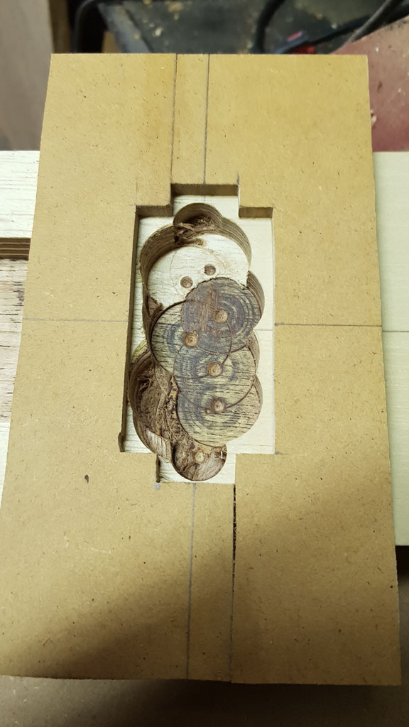

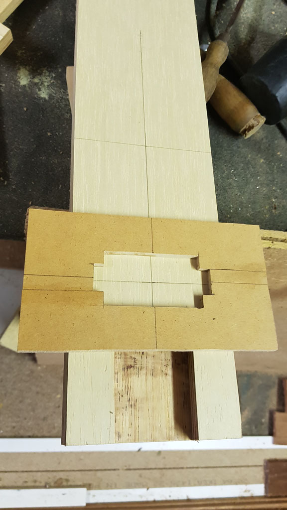

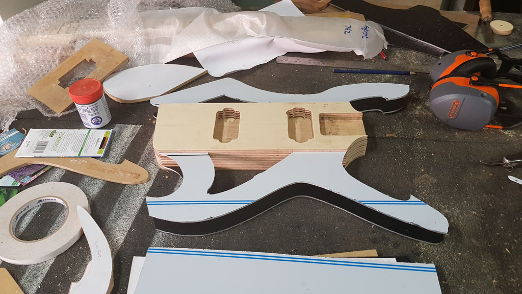

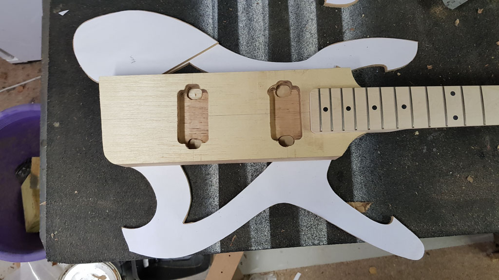

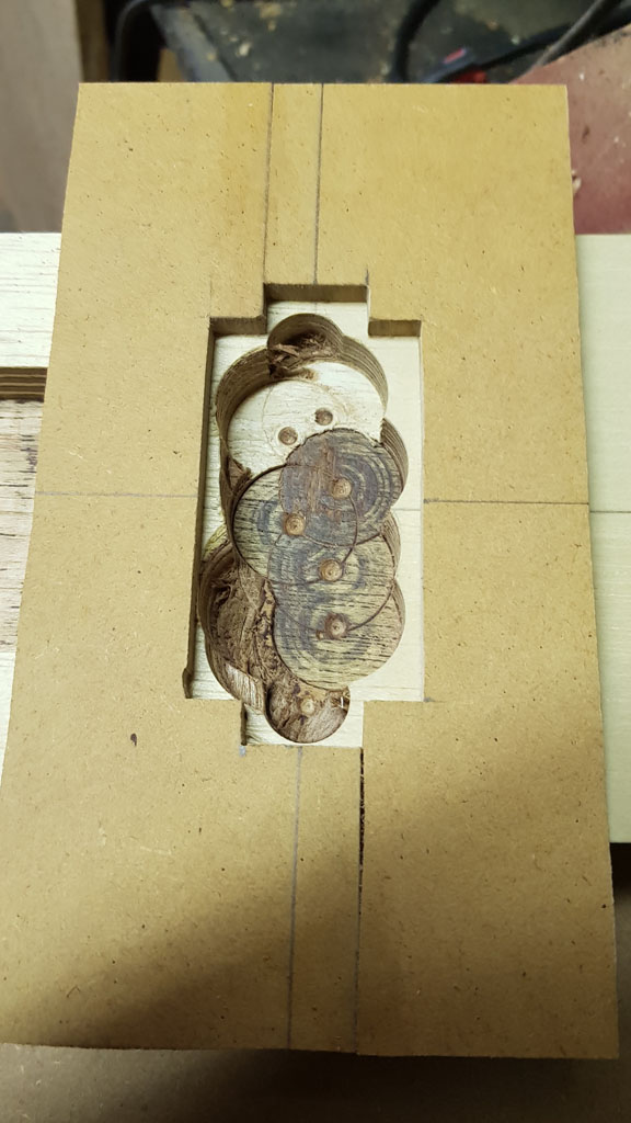

    And as luck would have it, even more progress today. With the glue set on my humbucker template, I measured and drew centre lines and went crazy with double sided tape.

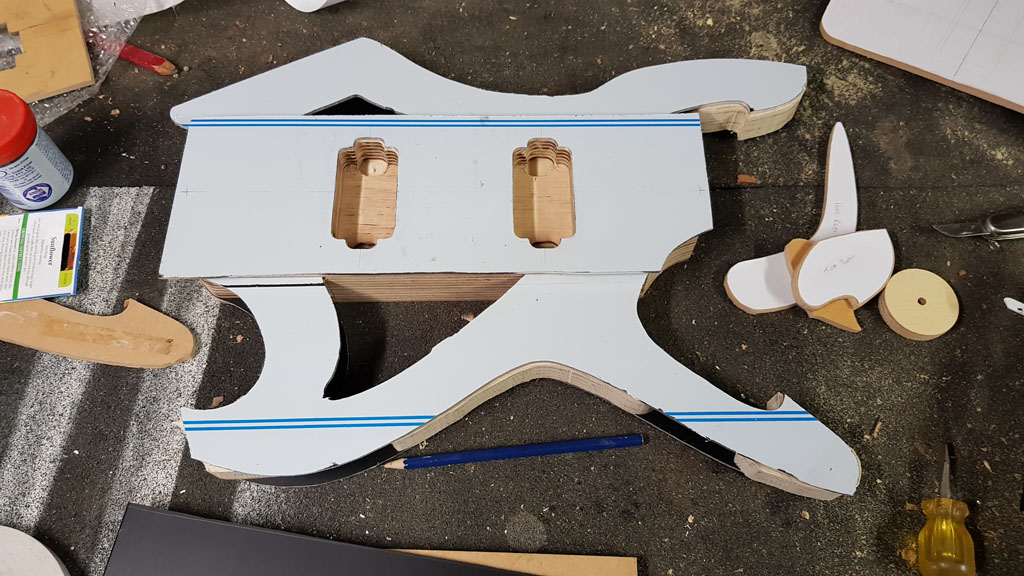

    Feeling buoyed by the success of my neck pocket, I wasted no time in attacking the humbucker routs, firstly with a Forstner bit on the drill press, and then with my template bit.
    The neck pocket turned out great... until a momentary lapse in concentration saw me chew out a chunk from the side of the neck pickup hole while lifting the router, and apparently waving it in all directions. Sucks, but it won't be visible, and won't cause any structural issues. And I've learned a valuable Christmas lesson.

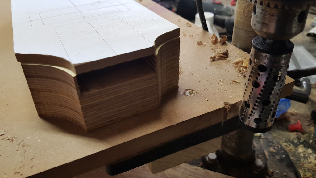

    I took the bridge pickup with a bit more care, and it turned out much better. Nice clean lines, no tear-out, just a few overhanging fibres from the top ply layer that will clean up with some sanding. Anyhow, satisfied that my top routs are complete, I figured I'd shape the body with some rough cuts on the bandsaw, and I was eager to try out a new toy:
    But as it turns out, it's not the right tool for this job. All it wants to do is dig it's teeth in and try to pull my plywood monstrosity out of my hands. So I may need to rethink how I shape the arm rest, as I'd planned to use this little beast, but it seems like it might be better suited to thinner stock or softer timber. Or parmesan. We'll see. On the plus side, my 80 grit homebrew sanding drum made short work of it, and I now have a guitar body that just needs some routing for controls. And a whole lot of sanding.

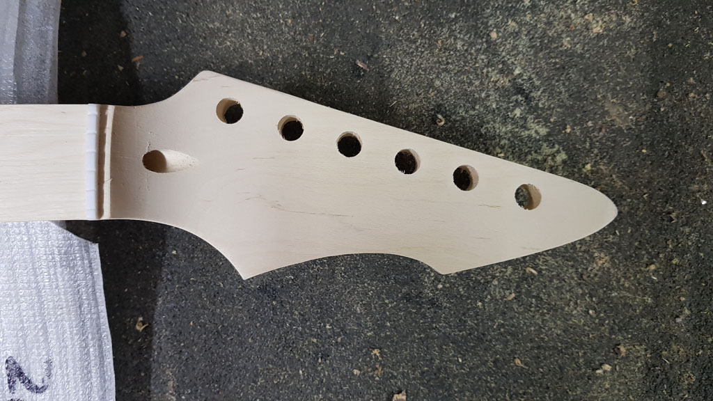

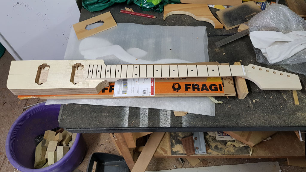

    And more progress. I've shaped the headstock, and I'm pretty happy with the result. I wanted more aggressive lines than your typical 6 inline, but nothing quite as pointy as a Jackson, and somehow landed at "baby shark". Or "Flying V with a bite taken out of it"
    I'm also very excited that my aluminium sheeting arrived today, meaning I'll be able to really get stuck in over the Christmas break. My aim is to get everything cut, routed, filled, sanded, stained and oiled over the next month while I save up for some schmick German hardware.

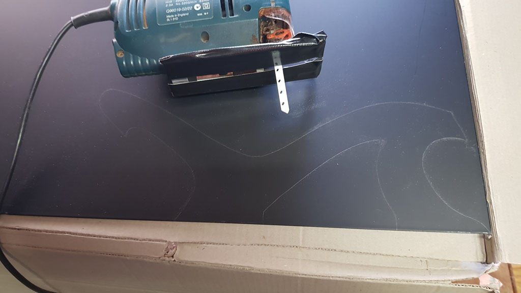

    The plan was to rough out the shapes in my 3mm aluminium with a saw, and then template rout. My first instinct was to have a go at cutting sheet on the bandsaw. But then I second guessed myself, and figured I'd go out and get a fine toothed carbide jigsaw blade instead since precision was not key at this point. Here's the back of my aluminium sheet (the front has a protective film) and my "scratchproofed" jigsaw.
    Turns out, that was a mongrel of a way to work with it. Aluminium filings immediately bounced in and under the gaffer tape, and cutting was somehow more difficult than it would have been with a hacksaw. But it did get the job done.

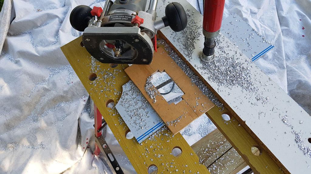

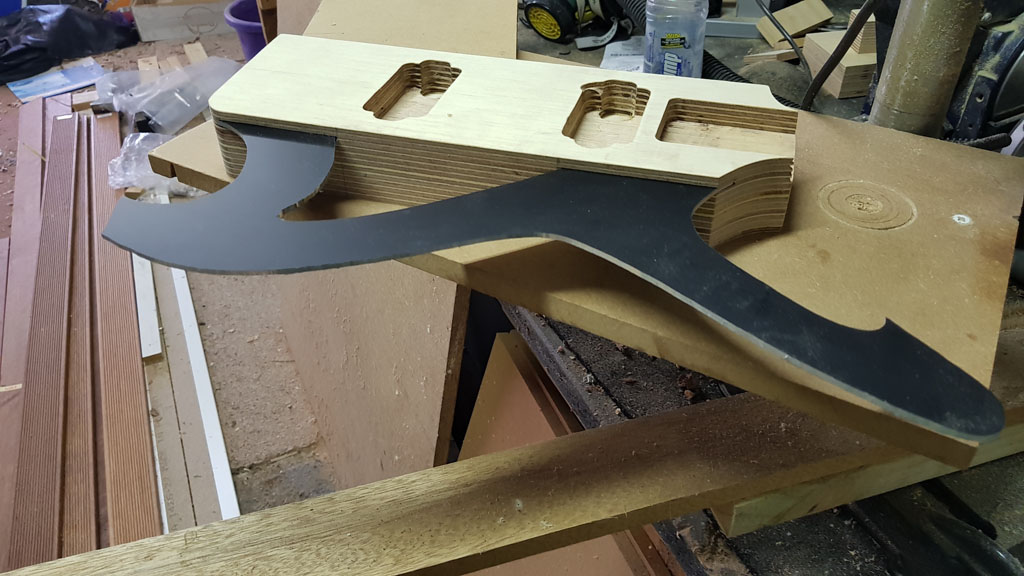

    My first "wing" was a proof of concept, so as soon as it was rough cut, I stuck one of my MDF templates onto it and very carefully routed around the edges. This was probably the most stressful part of my build thus far, and a clear indicator I need to invest in a router table so I don't have to try and keep a router level on a skinny, flexible bit of MDF. The edges are still a bit rough, but nothing that a bit of sanding won't fix. You'll have to forgive the smudges and double-sided tape residue, but it gives an indication of what the matt black finish will look like:
    Feeling like there might be an easier way, I took one of my offcuts over to the bandsaw. Lo and behold, it cuts like butter. It's going to signifcantly shorten the life of my band (and probably the whole unit, given the metal filings) but what the hell? I managed to knock out my next three wings much more quickly - the bandsaw gives me a much finer and more controlled cut, with less excess to rout, and within the space of a morning, I've got this:

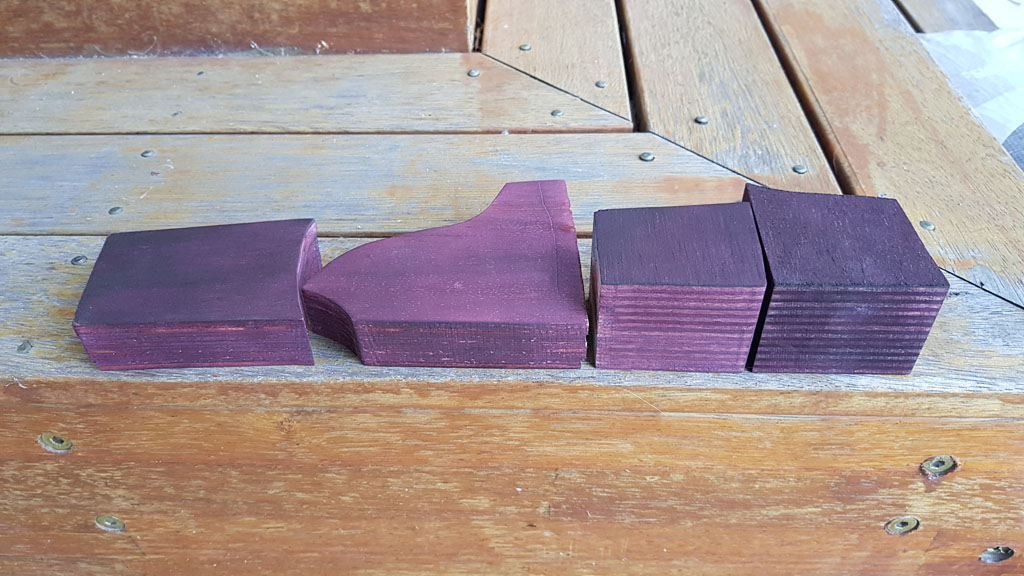

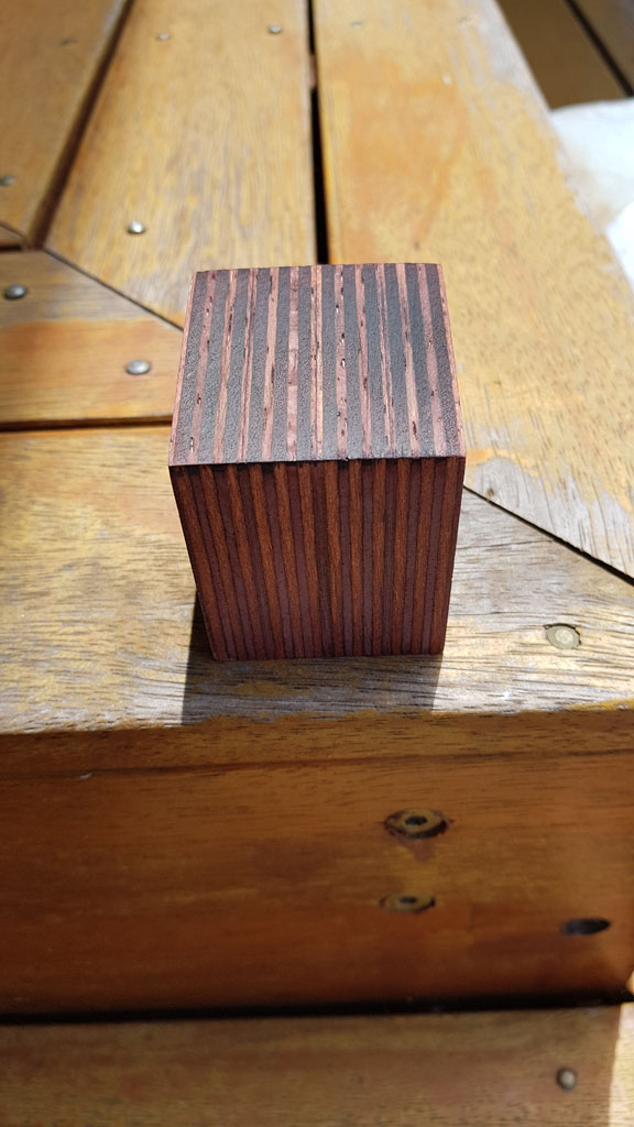

    The last little while has been all about experimentation. My first experiment was to get some Feast Watson Mahogany Prooftint. My first instinct was Jarrah, but after look at colour swatches online and in the green shed, Mahogany seemed closer to my vision. What could go wrong? It's not like it would weirdly turn purple, right?
    So that was weird. Really not sure what's gone awry with this, but I'm reminded of my school days, when someone thought planting a mulberry tree at a school where the kids all wear white shirts was a good idea. Doubly disappointing, the 4x7mm ply blocks I created don't have much of a stripe to them.
    But not to worry, I still have a bit of my original centre block left, just enough to recut my odd shapes - but with a bit of extra work to get them from 48mm down to 28mm using my poor man's thicknesser - a bandsaw. I'm pretty happy with the results, but didn't have my phone around to capture it.
    Anyway, after another trip to the green shed, I've grabbed a tin of Jarrah stain, and a little bottle of black. I'm very keen to highlight the striping in the ply, and I feel like getting some black into the end grain, sanding back a bit and then staining in jarrah will give me what I want:
    I'm much happier with the colours (black + jarrah top, just jarrah sides) and I'm really happy with how the black is accentuating not only the end grains but also the other grains, pores, scratches, etc. It's going to be really interesting to see how it looks on a curve, with the direction of the end grain changing.
