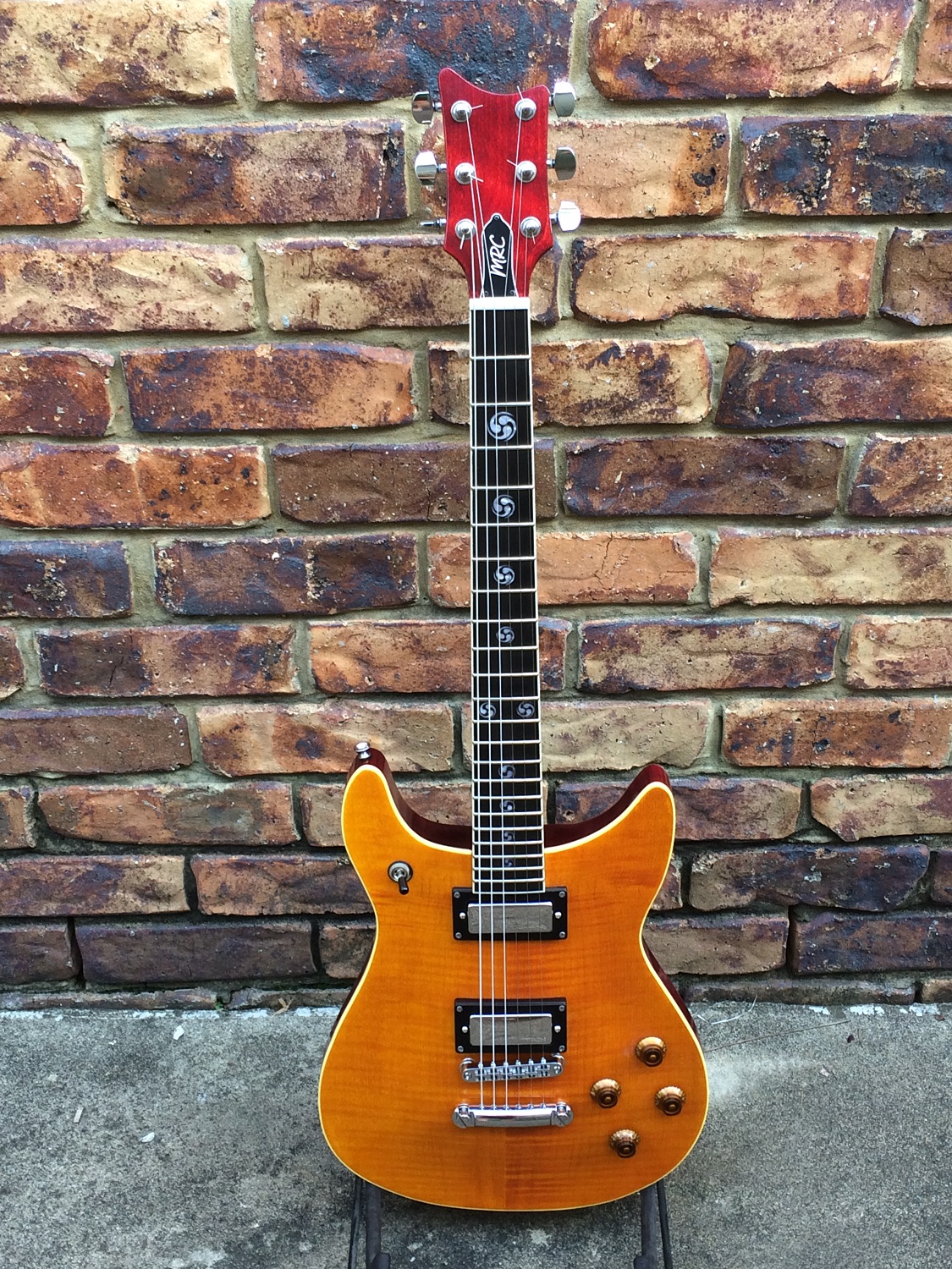

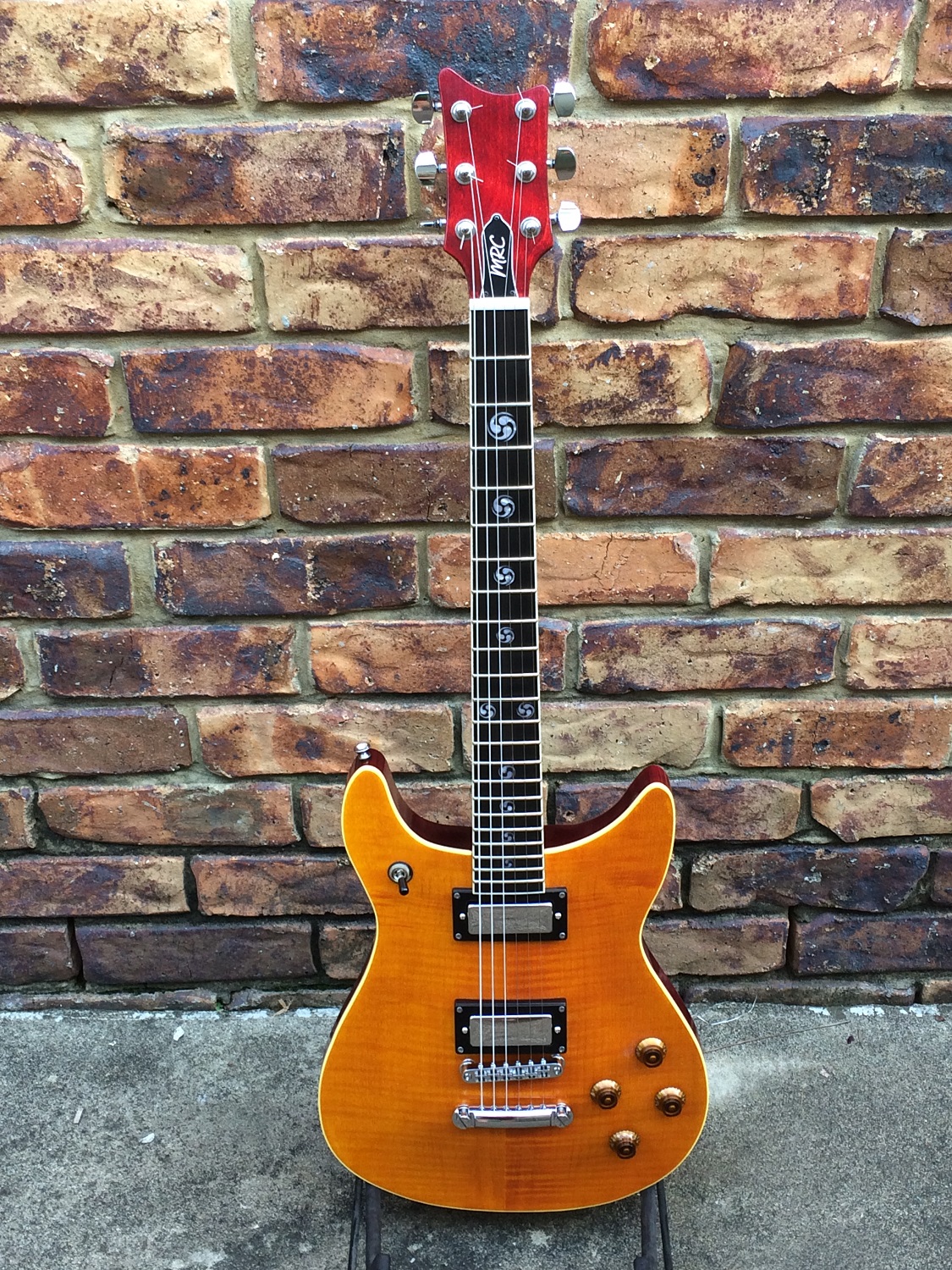

    My second PBG kit build was the same model as yours. It was my first set neck build and I learnt a thing or two and I've been mucking around with this stuff for a while.
    Here's mine -
