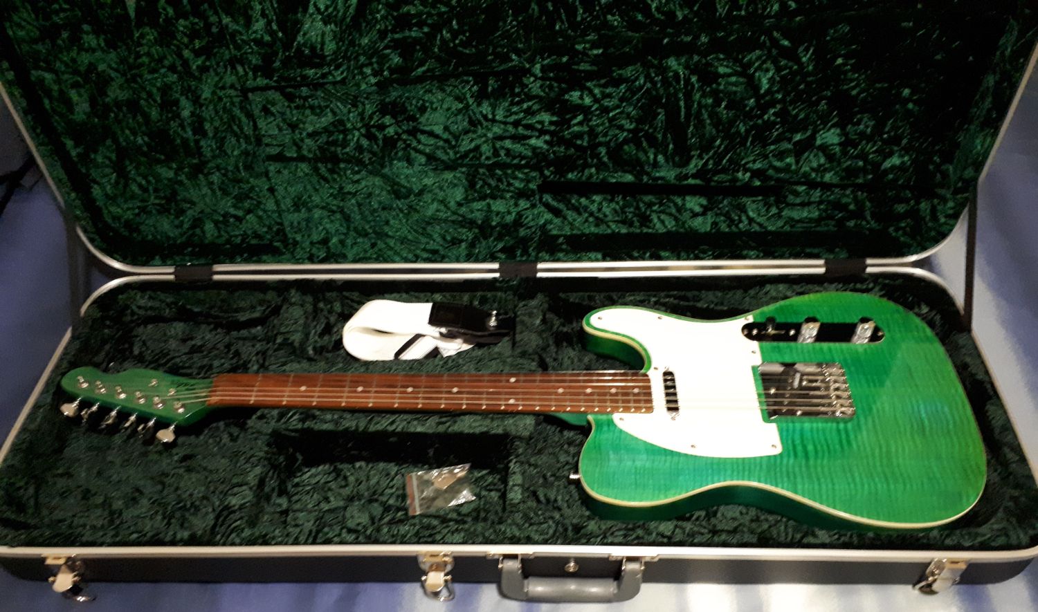

    I have used Tru Oil on all my builds and mostly over the top of a dye, stain or natural finish. As layers build up it eventually does fill the grain but wouldn't recommend using it first if you plan to add any colour to the finish. Why, because Tru Oil is like a varnish or lacquer and stains will just sit on top and not soak in or adhere thus making it difficult when trying to add subsequent layers of colour and top coats.
    Wouldn't recommend Tru Oil over Blue as here is a shot of what was once a turquoise blue Tele that is now more green than blue due to the amber tint in Tru Oil that tends to age fairly quickly. Upside is I don't need to do a green guitar as this one is now close enough.
