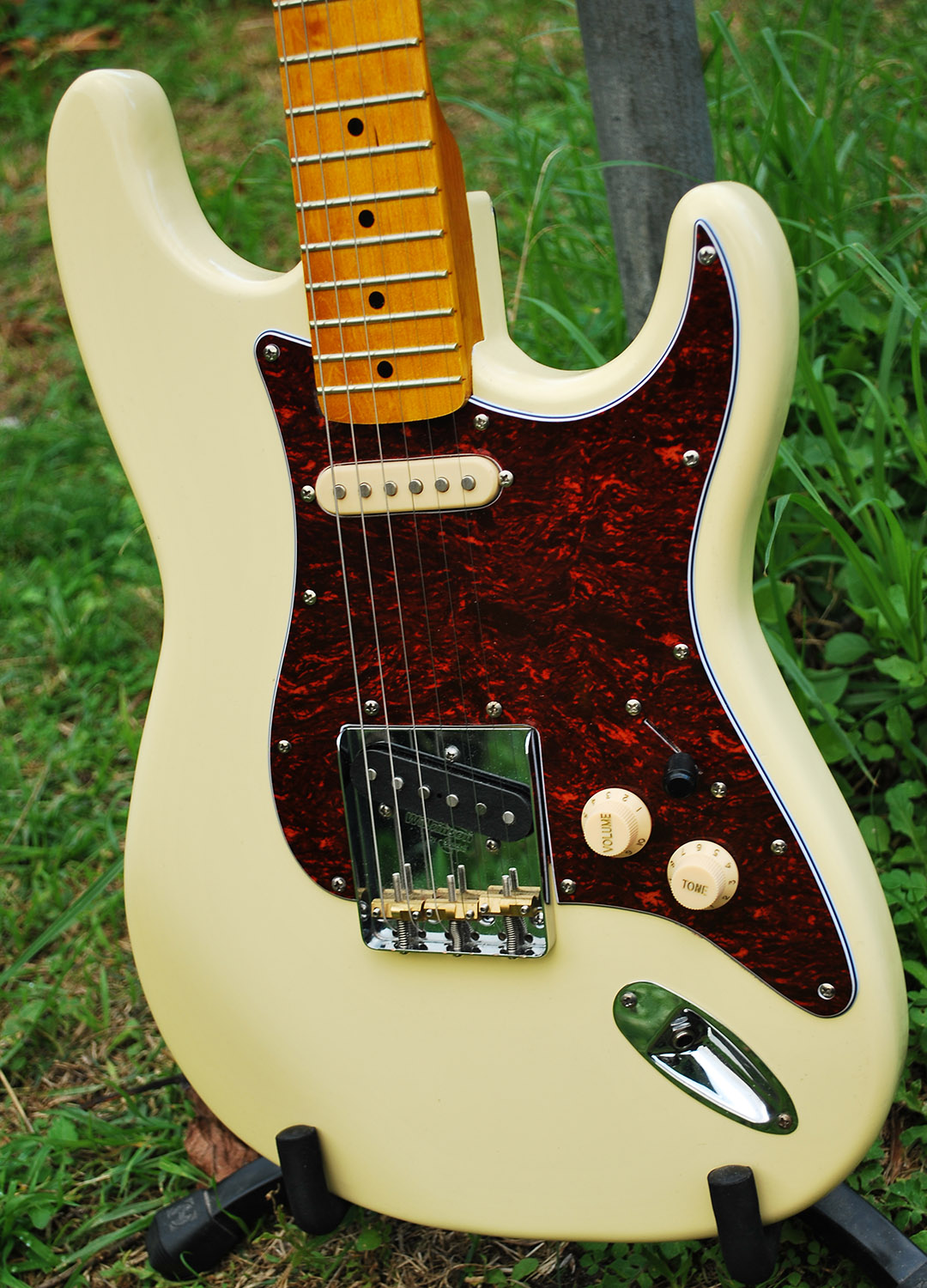

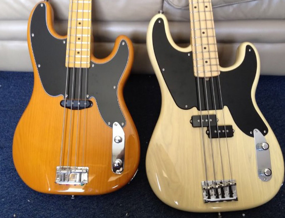

    Thinking of extending it somewhat to mimmic the Telecaster P basses
Name:	P basses.jpg

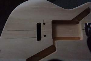

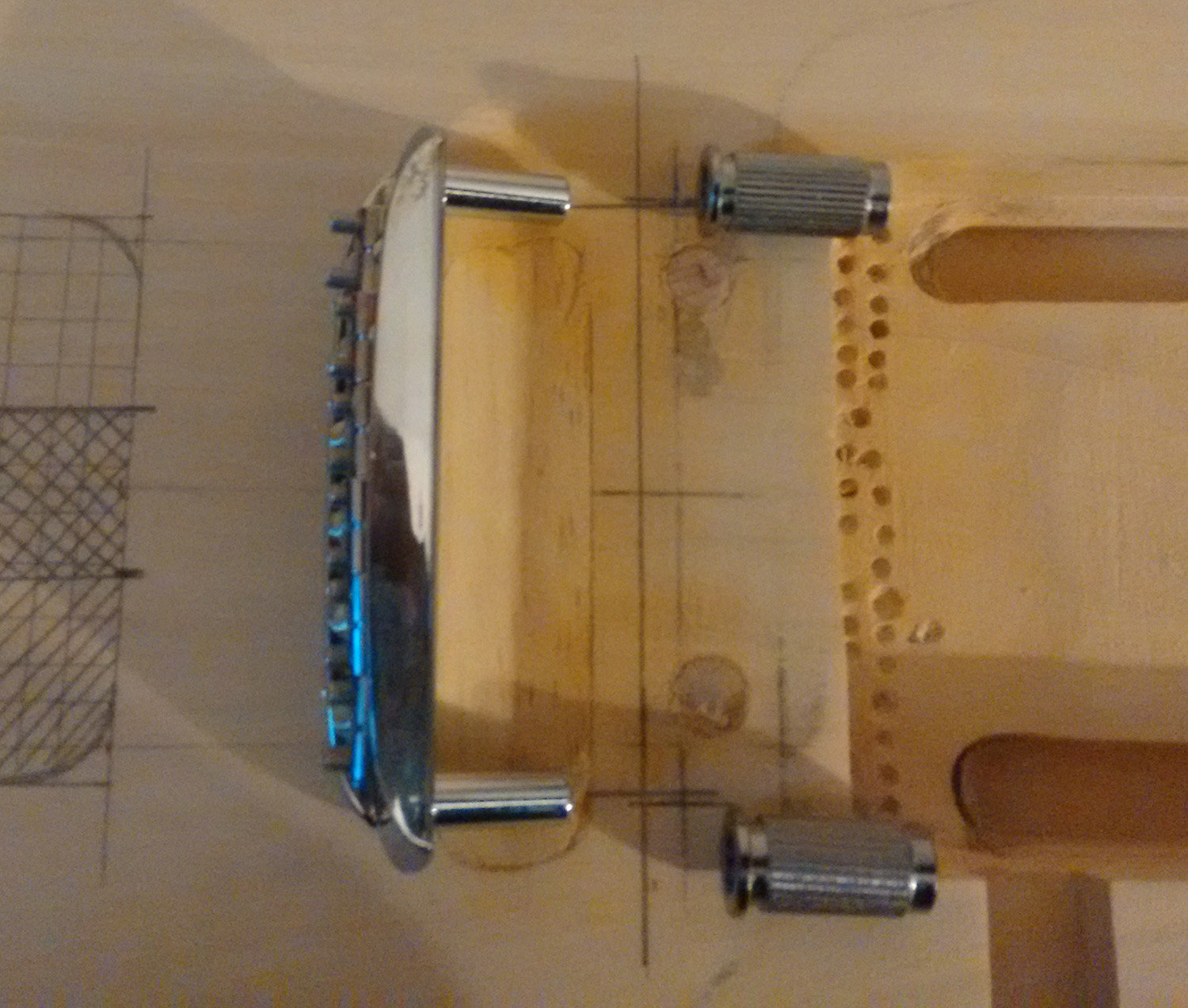

    Moving along ....marking out the centre line and the scale length
Name:	07 scale centre.jpg
    cheers, Mark

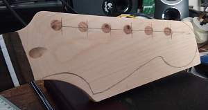

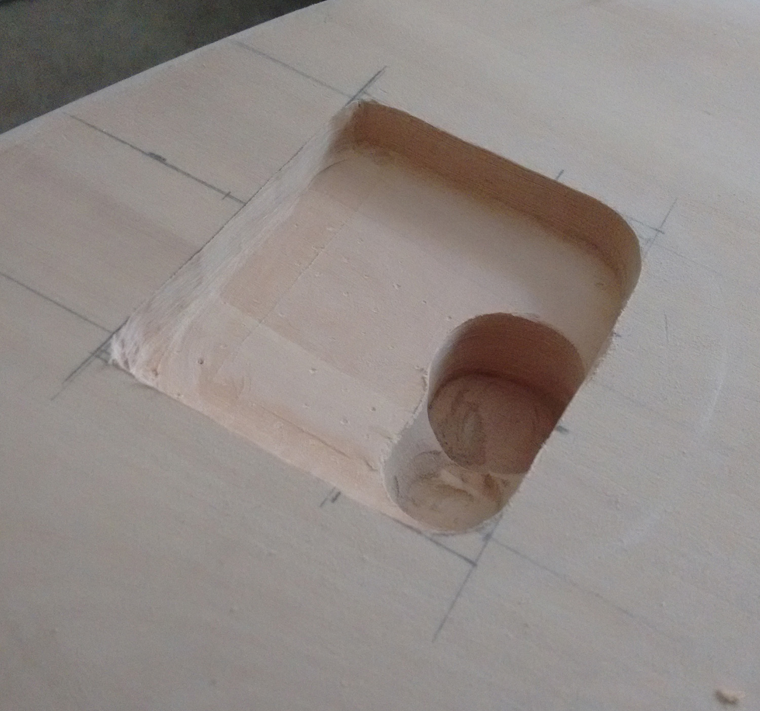

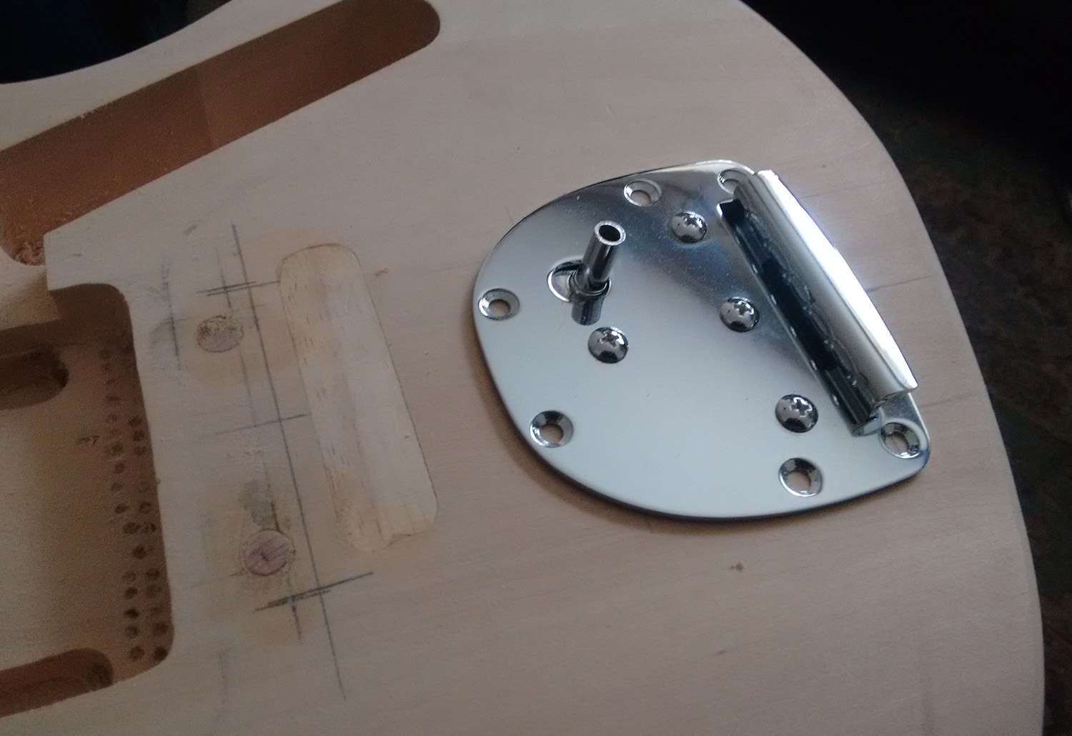

    Speaking of which.

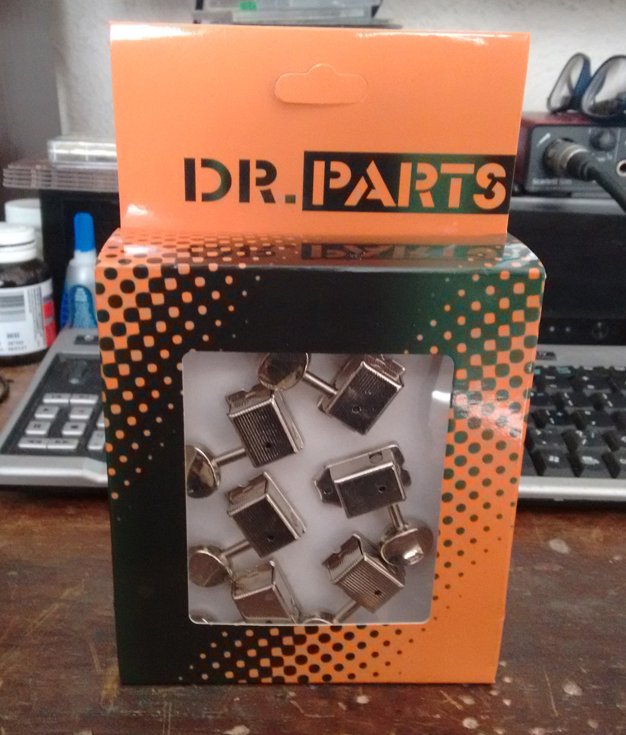

    Inspecting the headstock tuner hole placement...alas one was further away from his brethren...so.
    Have had these suckers sitting on the shelf unused for quite some time.
Name:	09 Dr Cheap.jpg
    Can't remember exactly how much but under $20.
    Thing is they require an 8mm hole.
    Fortunately I have a good supply of dowels left over from Pitbull build one.
    cheers, Mark.

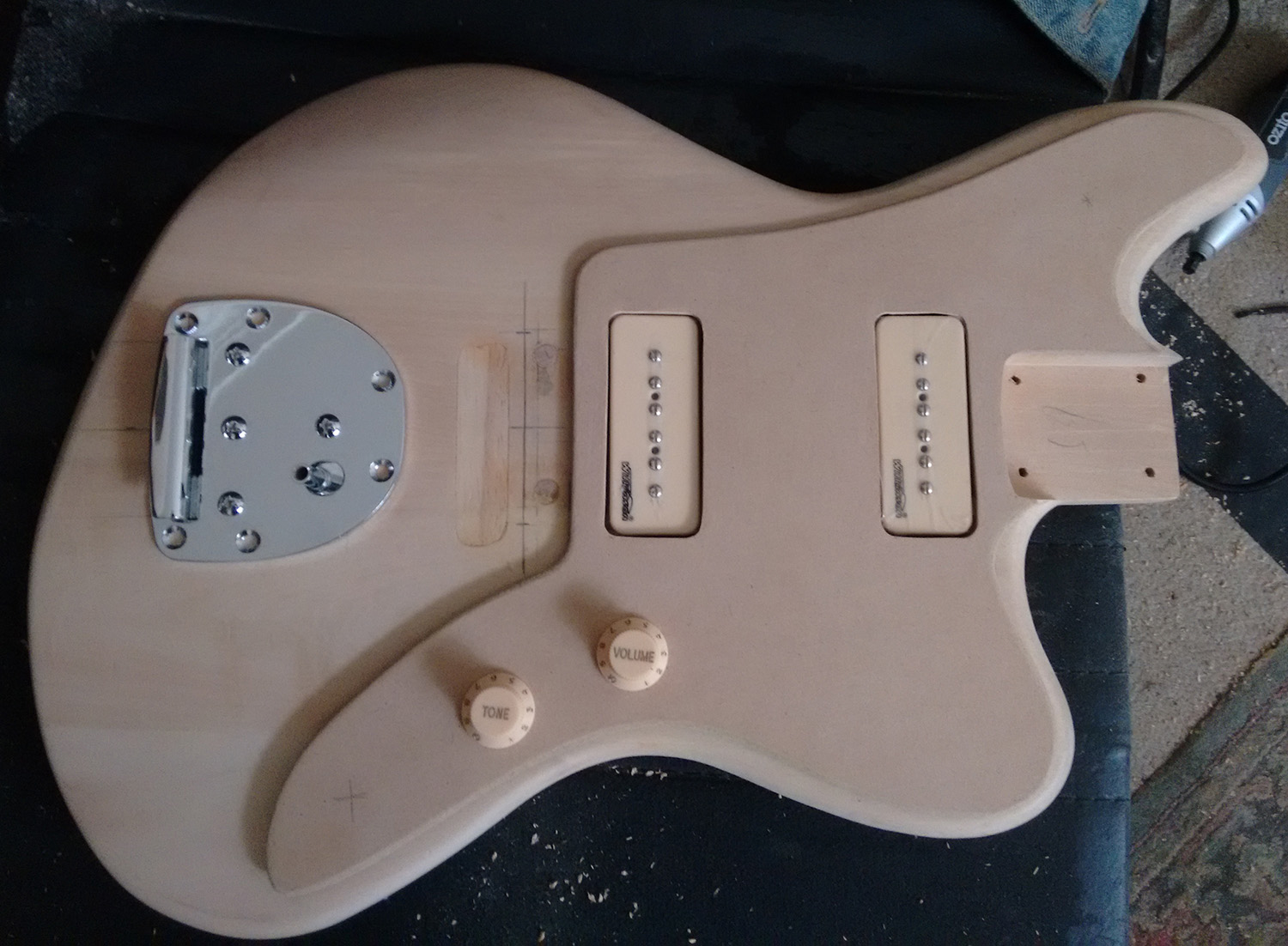

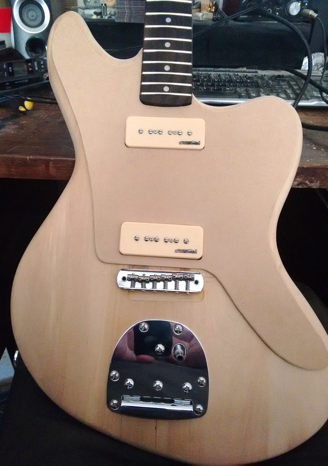

  7. #17

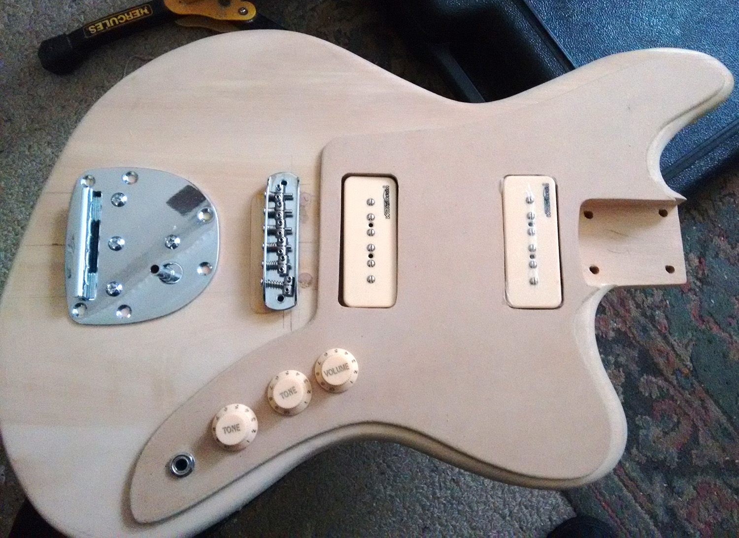

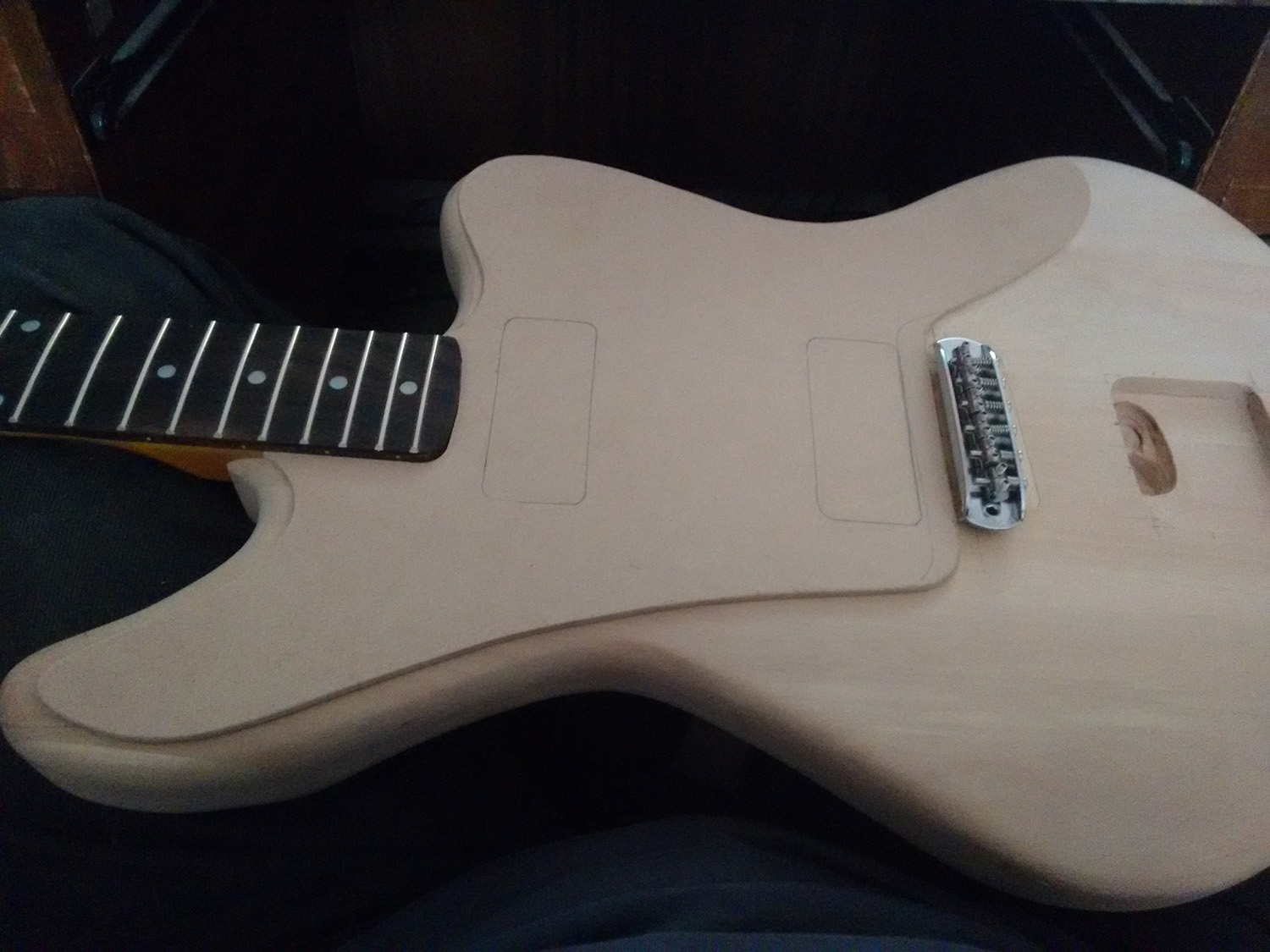

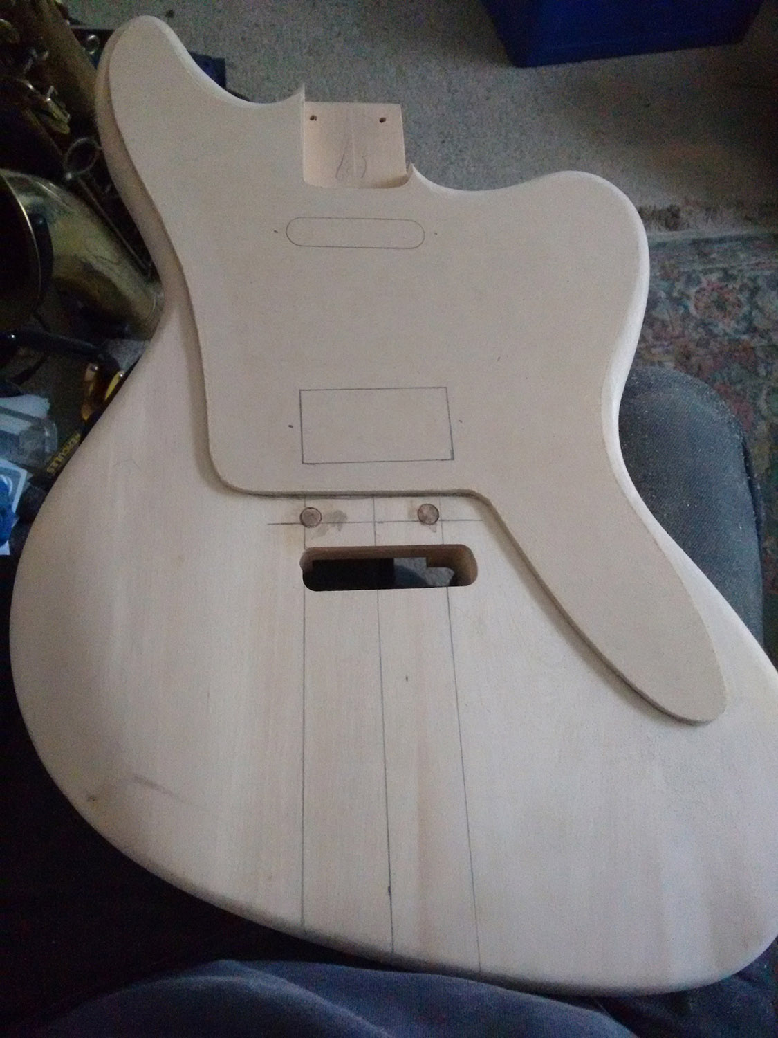

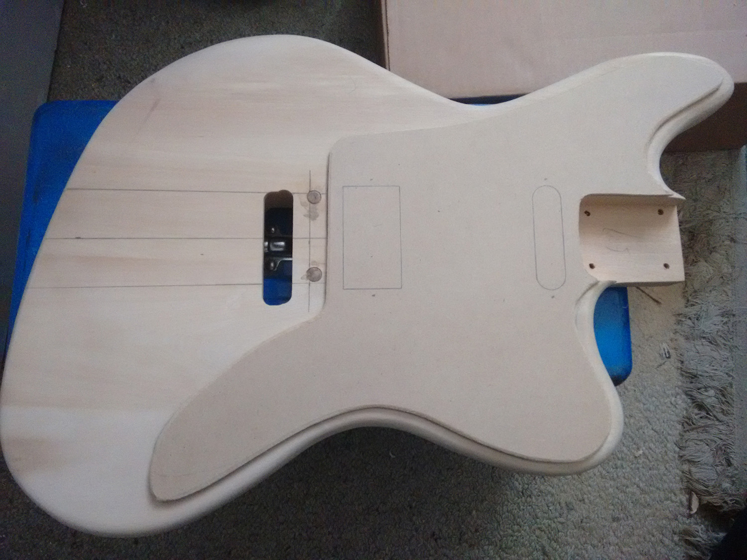

    Trialing the pickguard with MDF.

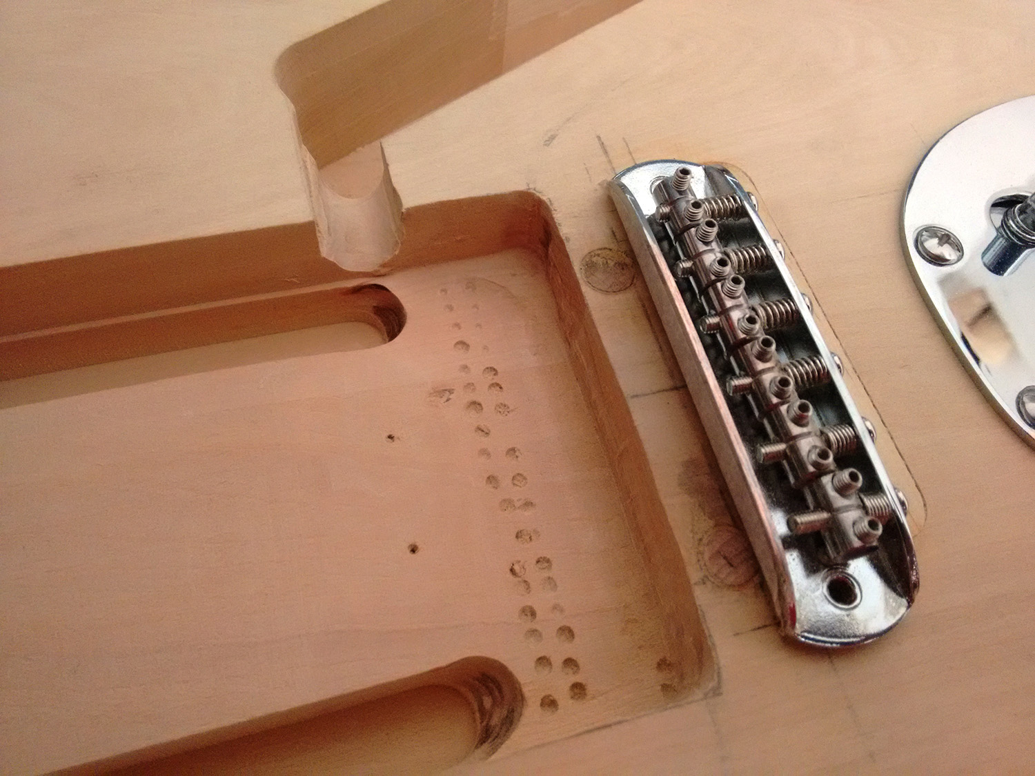

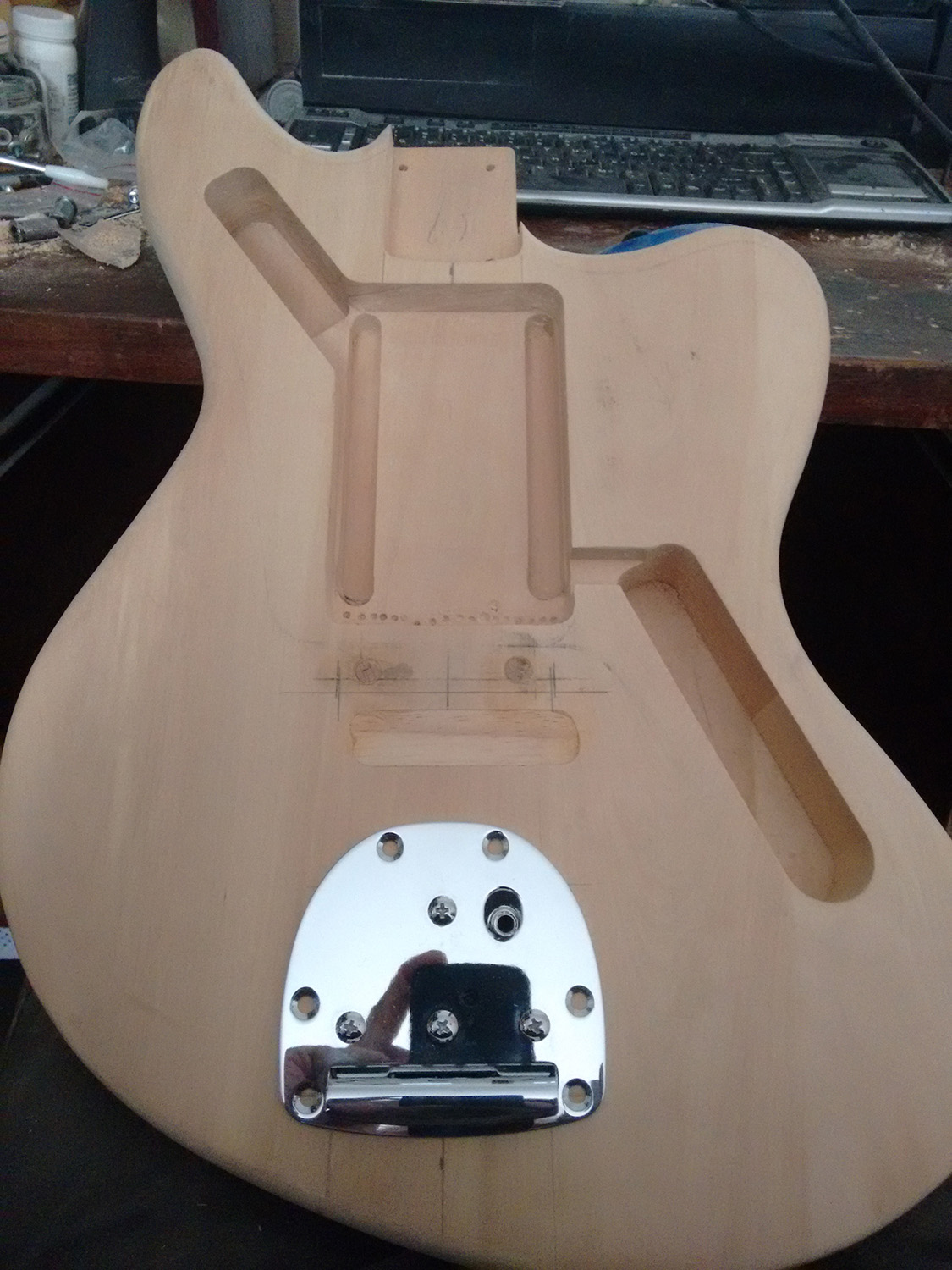

    Dowelled the bridge holes.
    Next task would be to fill the original tremolo cavity.
    cheers, Mark.

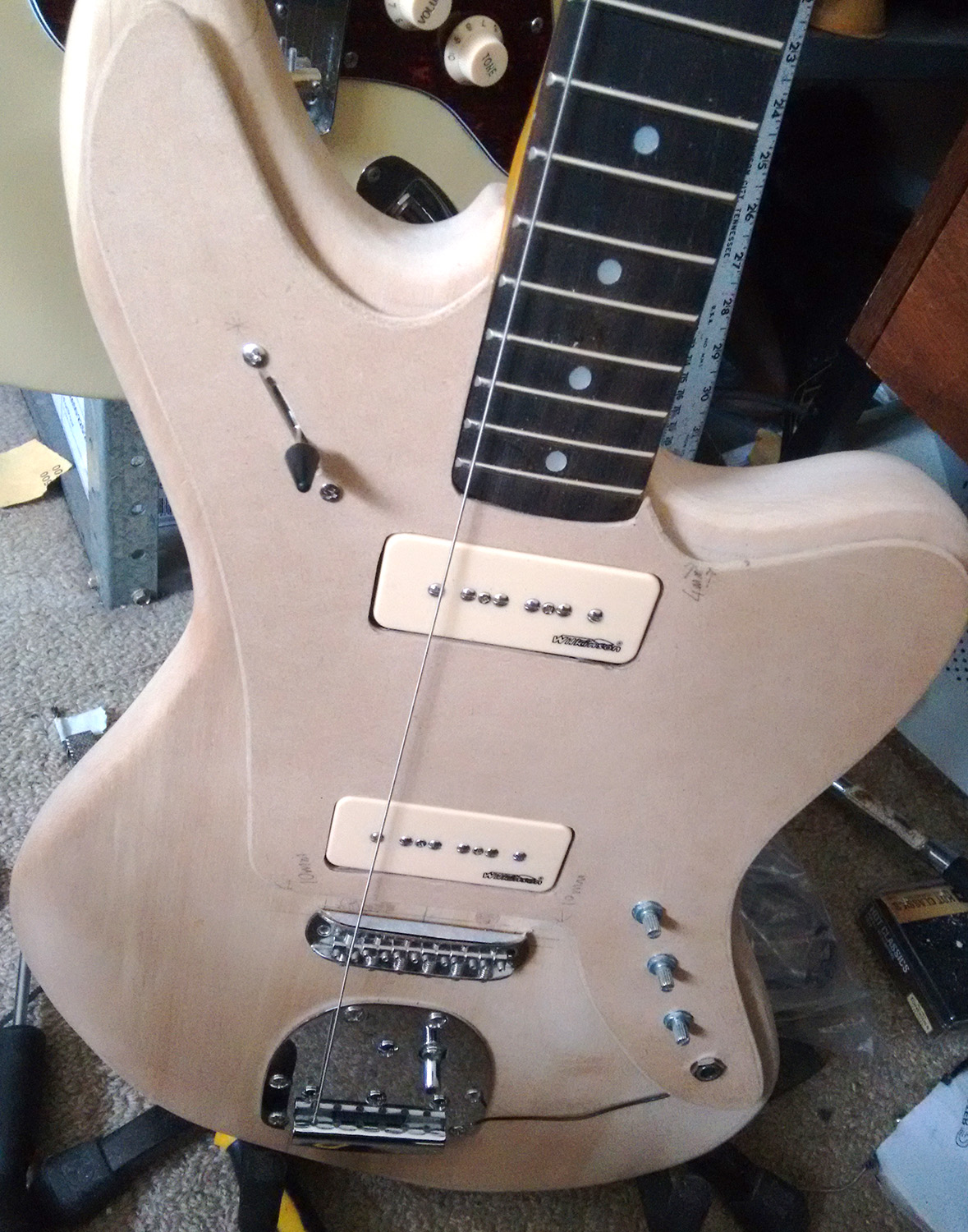

  8. #18
    Yes, I like the way your MDF template sits and IMO the shape suits better than standard kit stuff.
  9. #19
    Right again Waz.
    I think the Jazzmaster one-piece is the direction to take.
    After sleeping on it, I've decided to have another go...the lower rear section should follow the edge of the body.
    I'll leave out the upper controls for the first iteration, however I'll change the 'Fender' style selector switch for the 'Gibson' style toggle.
    cheers, Mark.
  10. #20
    Take 2.
    Doh! Still not quite there. Pretty close to happy though.
Name:	13 redone.jpg

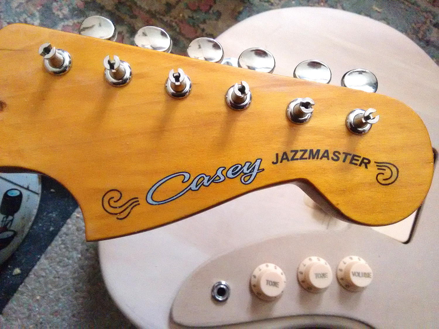

    Marked out the Jazzmaster headstock template
    cheers, Mark.
