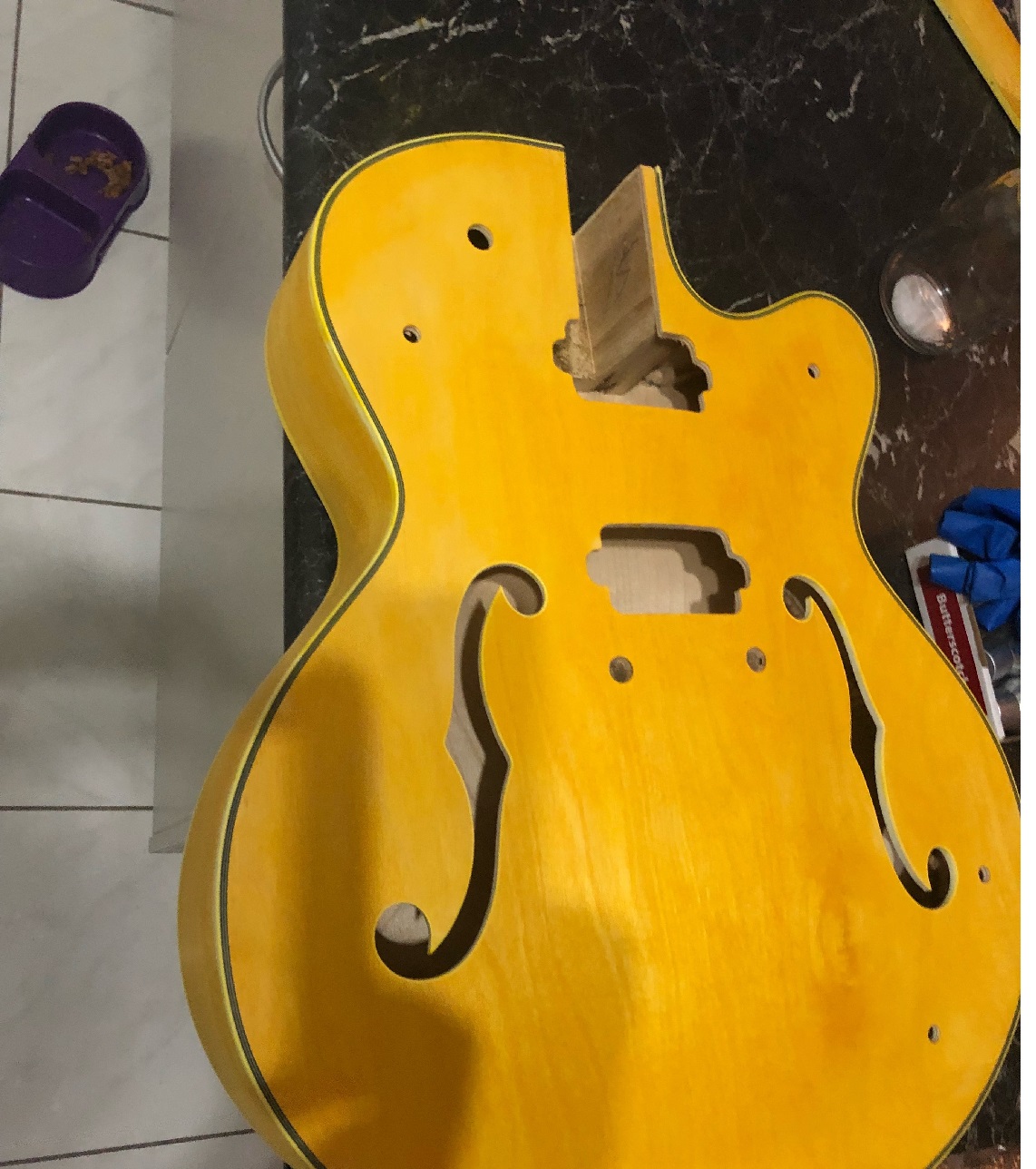

    Got a couple of hours yesterday so did some sanding and put on first coat of DT butterscotch.
    Happy with the colour. Couple more coats and i think this could look really good.
    Presume 0000 steel wool or acetone can be used to take the stain marks off the joint strips?

    Nice colour. If 0000 doesn’t work you use a sharp razor blade and carefully scrape the binding and you will remove any stain.
