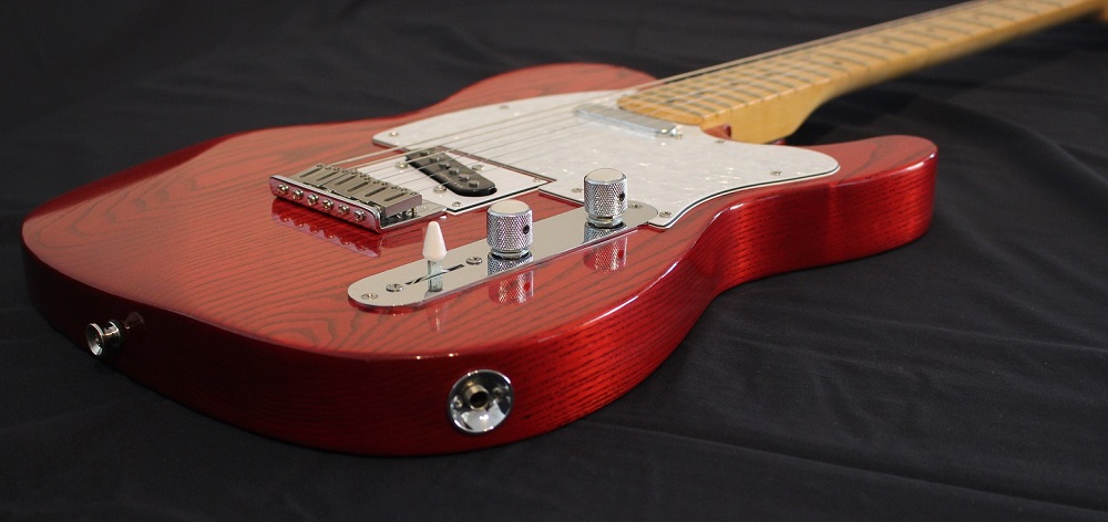

    That tele was done with a combination or ColorTone Cherry Red and U-Beaut Red (both water-based dyes).
    It was a PBG TLA-1 kit with Ash body.
    The reason I used two different dyes was the ColorTone I bought was just too small an amount and when diluted (to recommended ratio) it was just too pale (more pink than red). I used the remainder of the CT neat and it wasn't enough to cover the whole thing so I switched to the U-Beaut and the end result is what you see now.
    Here's a better pic of that guitar: (glamour shot )

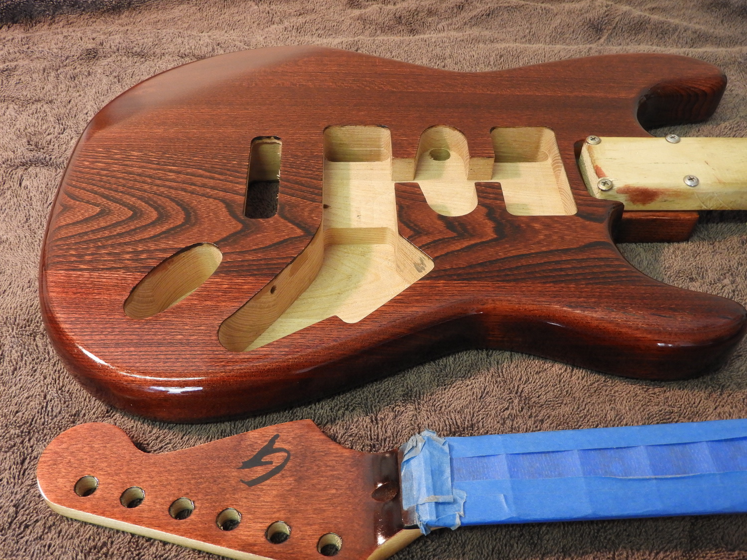

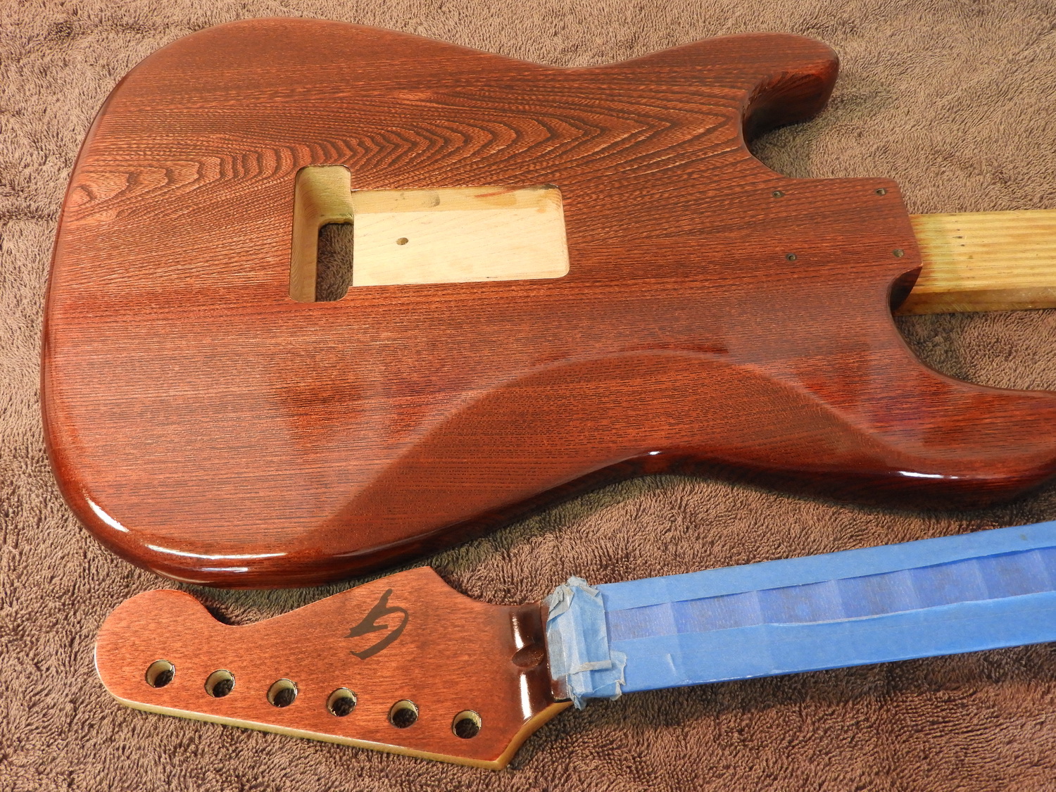

    Run out of Tru Oil after 38 coats and awaiting new supply.
Name:	DSCN2143 1500pix.JPG
Name:	DSCN2146 1500pix.JPG
    It is 3 weeks since my last report and I have been tru-oiling and sanding for 38 coats and reckon I will need maybe another 10.
    I sanded the guitar down to 340 grit and then did two wet wipes with meth to lift the grain (I don't like water with wood). I noticed the black v grain lifted surprisingly high so sanded smooth again. Then another wet coat of metho and up the black grain came again but nowhere near as high so sanded smooth again.
    Then I applied three coats of black Timbermate, sanding with 340 between coats.
    Then the first coat of ColorTone Mahogany Red mixed in metho 15:1. I noticed the black grain liftted a little but expected that it could be filled with the planned 30 coats of Tru-oil (needed 30 on the LP). Two more coats of stain and grain looked great but the large v shaped grains lifted further. But too late now. Expected that they would fill with the tru-oil
    Away I went with the Tru-0il. Three good coats and the first sand off with a dry Scothbrite Grey. The ScotchBrite is 600-800 grit but I have found it much gentler on the finish than 1200 wet and dry. From the third coat it did a light sand with Scotchbrite between each coat. After about each 10 coats I found I needed the 1200 wet with turps for an extra flat smooth off.
    The smaller grain was not filling as quickly as I expected even after the Timbermate. I think maybe next time I will sand the Timbermate with 600 to leave it smoother. Others might like to comment on this idea. I have noticed there is a bit of a different view on the forum about much bite you need to leave for the finish.
    The valleys between the raised big v gain were not filling. So after 18 coats I decided to just pour the Tru-Oil into the valleys to fill them. Had to do that three times but now I had an almost glass finish. By the time I got to 30 coats all the valleys were nicely filled
    The small grain had almost filled after the 38 coats.
    I don’t have 38 layers of tru-oil on the high spots, only in the grain because I have had to sand down quite heavily to get closer to the low grain.
    My next issue is that during my finishing process I put the scratch plate on for a look. I thought ‘I can’t cover all that beautiful grain with a big Tele scratchplate’ so I have decided to cut off the lower horn and shape the plate with a curve from near the switch to the lower screw near the neck.
    I really don’t think I need the router for such a short cut. I was thinking of shaping the plate with drum sander on the drill press and then filing and sanding the bevel. I would appreciate any advice on this idea. I will do some testing shortly.

  9. #19
    Greg, that's looking outstanding!
    I like the simplicity of your G logo too. It's understated yet elegant. Is it engraved, then filled with something?
    re: Sanding the Timbermate with 600, I see where your thinking is with the finer grain, but not sure it would achieve what you trying to. I guess it's worth a try. I think 400 is the lightest I've ever gone.
    However, how much did you thin the the timber mate when you applied it?
    My feeling is that too "dry" a mix will make it harder to fill the finer bits of grain, and too wet it won't have the proper adhesive properties and lift out easily with sanding.
    Another observation I've made is sometimes it takes more than 3 applications. I know a glass-smooth natural finish looks great, but grain-filling is my least favourite part of the process.
    re: your pickguard, I did a similar, but more conservative thing on mine (see earlier photo).
    For doing custom pickguard shapes or mods, I rough it out with a medium hobby saw (saw blade fits in my Excel hobby knife handle) fine tune it with my drum sander (in drill press) and do my bevelling by scraping with a Stanley Knife blade. I do a combination of holding the blade in hand as well as in my DIY binding scraper tool.
    Last I clean up any tool marks with a flat jeweller's file and 1200 sandpaper. I've even gone so far as to polish the bevel with Micro-Gloss polish.
    It's time consuming, but way cheaper than ordering a custom guard, and I find it quite therapeutic...
    and you get exactly what you want!
  10. #20
    Member GregLane's Avatar
    Sep 2016
    Nelson Bay NSW
    221
    Hi McCreed
    Thanks for the info on the pickguard cutting. I will be taking it slow an easy.
    The guitar is actually redder and blacker than the photo. The flash turned it brown/orange. Try again when finished.
    The G for Grandpa, Grumpy , Guitar , etc hihi
    It is nothing so clever as a filled engraving. It is just a laser printed transfer well covered with Tru-Oil.
    I agree the Tru-Oil may have been a bit dry. I purchased a large bottle with the kit and took over a year to start using it. In fact I added a little bit of turps to what I had left for the last 10 or so coats and it was better to apply. It will be interesting to see how the new bottle feels when it arrives on Thursday.
    I did have about 1/3 of a bottle left from the LP which was couple of years old. It was quite good still. Lived upside down in the refrigerator for two years.
    I finish with two coats of 50/50 Tru-Oil and turps. Really shines. I have never polished the LP and it is still great.
