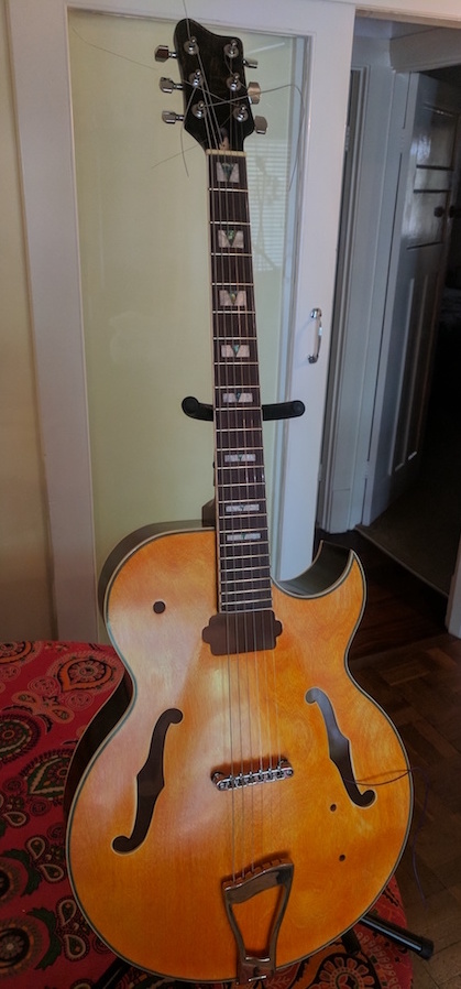

    Spent last weekend sanding & sanding. Turned out it still wasn't enough!
    This weekend I started adding some colour, the pics are early on, it's looking better now. I used UBeaut water based stain for the front & back & Feast Watson jarrah for the sides & neck. The water based dye is very forgiving but it does raise the grain a bit. I found it wasn't a good idea to follow the instructions to wet the surface first, it pulled the grain too much. It worked much better to add the dye to a dry surface in sparing amounts & really work it in.
    I was a bit disappointed when I first added some colour to the neck, the 2 different types of wood either side of the skarfe joint absorbed dye at wildly differing rates making the joint really obvious. I always intended going really dark so after a few more coats it doesn't look so bad now.
    I'll leave the dye to dry for a few days now before glueing the neck to the body. I'm thinking of using tung oil for the final finish, i've used it on some cigar box project & liked it. Has anyone else used it?

    It's true confession time! The colour was meant to be jarrah, I went to the big green shed and picked a bottle from the jarrah shelf, took it home & slapped on the guitar & after a couple of days noticed that I had actually bought a colour called Brown Japan. Probably a fortuitous mistake as jarrah would have been too red & I wouldn't have got the same contrast. Thanks for the kind remarks.

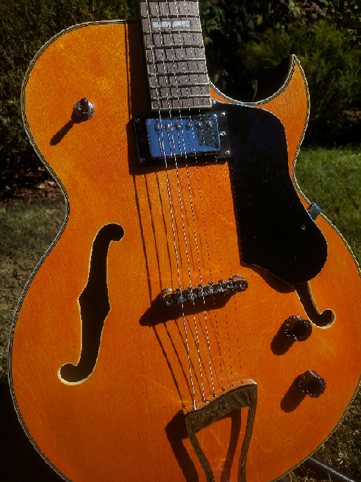

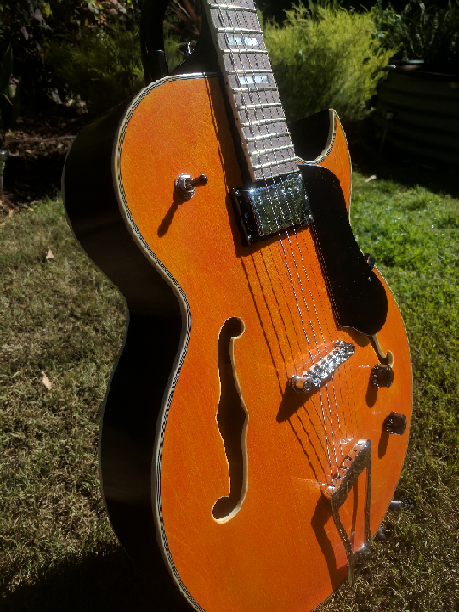

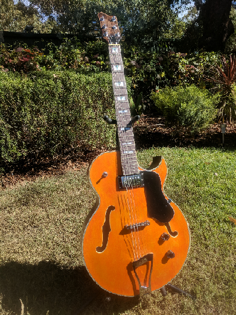

    2 weeks later and about 15 coats of Tru Oil on the body, less on the neck. Rubbed it back with 000 steel wool & polished with gun stock wax. I'm now playing with the setup before I decide about upgrading the pup. Action is too high at the moment, i've obviously got a lot more to learning to do but fingers crossed i've not stuffed up yet!

    Just about complete! Just waiting on some nut files. I'm quite pleased with the result and providing the nut files achieve what i'm hoping for I will probably take Simon's advice & upgrade to a PRail to give the switch something to do!
    There was such a wealth of tips & advice on the forum without which i'm sure I would have stuffed up so thanks to all.
