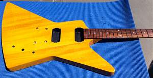

    Yes, after doing the dummy assembly, there is a bit of a gap between pickup and the pickup cavity... I think I will extend whatever finish I go with into the cavity and see how it looks... I do like your idea of making it black though....
    As for mounting the bridge, maybe lay some quality masking tape as I did to protect the finish whilst you mark out and drill the bridge?

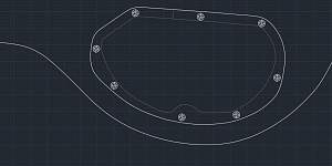

    I plan to recess the cavity cover plate, so I have drawn up a new one which should follow the outer contour of the body a little better than the original cover plate...

    I have an idea to use the same (slightly more fancy) material on the cover plate and truss rod cover plate to continue the theme throughout....

    After a bit more thinking and review of the tools on hand, I opted to clean up the internal shape of the stock control cavity and then run around with the router to create a 10mm wide, 2mm deep rebate around the cavity opening. From this I can copy the shape and cut the new cover.

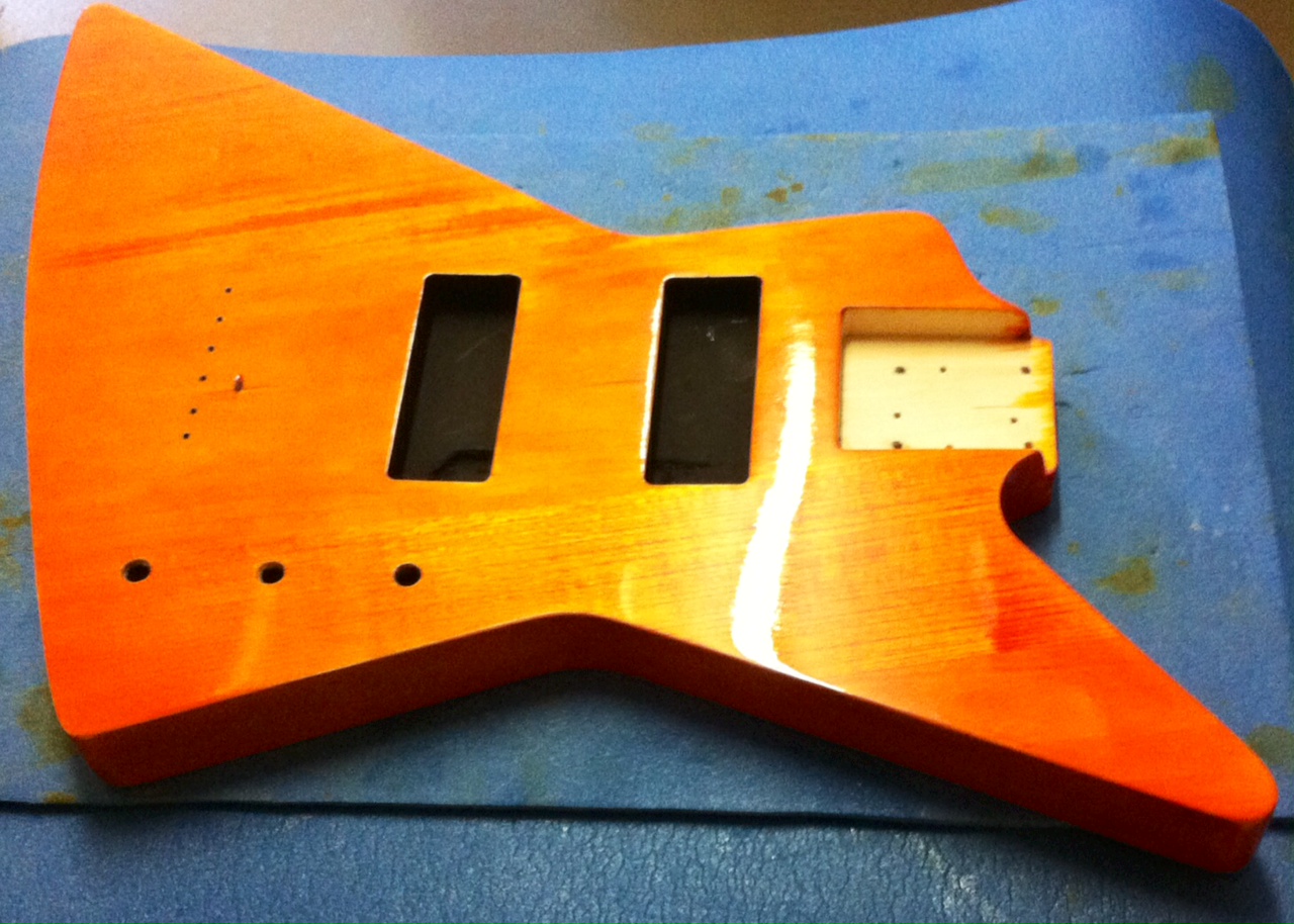

    I’ve found the copper shielding tape goes onto timber fine, as long as it’s a clean surface and not too rough.
    No real issues with longevity, once it’s in, it’s staying put.
    Have to agree with Frankie. No point putting any finish inside the control cavity.
    Underneath the soapbar pickups you may want to consider using matt black paint or use a conductive black shielding paint that can be bought on eBay. I used the stuff on both Explorers and also in the J Bass too, however copper tape was eventually put in the control cavities as an extra level of hum protection. On my current MMB-4 build I will also use the shielding paint again. Didn't bother using it on the Tele's as they are notoriously noisy at the best of times and copper taped everywhere just to be safe.

    Great info, thanks guys..... I'm guessing the copper tape can be painted black too....
    I didn't get as much progress today.... Just attached a dummy neck/handle in preparation for application of the black Timber mate to fill and pop the grain....
    I did the damp cloth thing with water to see the if there was any glue or other weird stuff that I needed to address first and, lo and behold....
    There are a few spots that I'd assume are glue between the sections.. sounds like wire brush or goof-off may be required there...
    But more unusual is some quite large areas at the tail end of the body both front and back that have me a bit concerned..... Seems like there is something that's preventing the water wetting the grain.
    Seems there is more hours of sanding to be done

    Glue joint near control cavity which is quite common on most bodies as they are made from several planks of timber. Behind bridge area looks strange and does appeat to be a bit like thin film of glue? More sanding or have a go with goof off should remove that.
