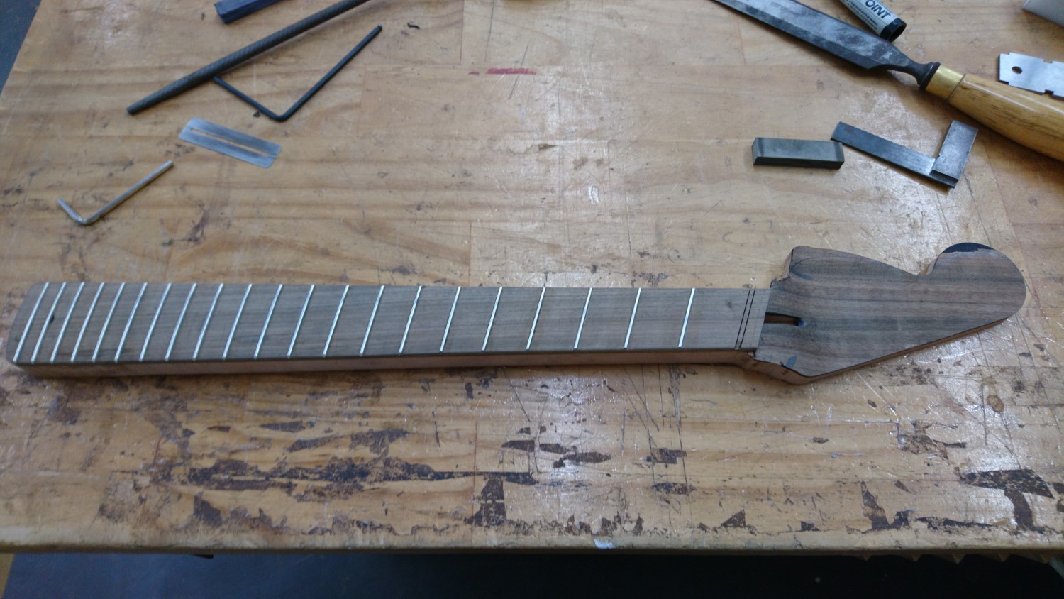

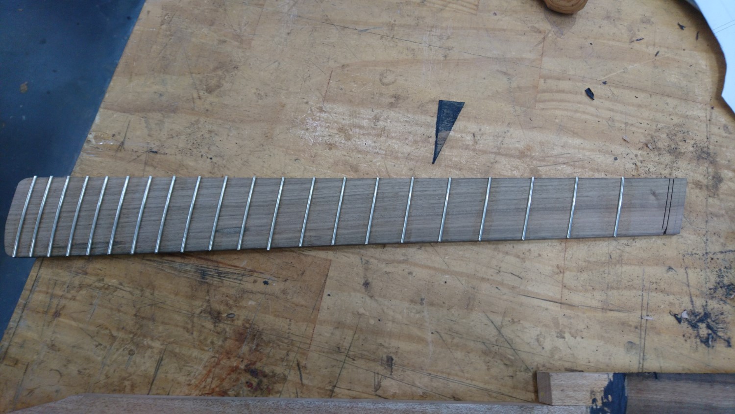

    Quick update before I sleep, don't think I have a ton to add word-wise so pics shall do most of the work
    Snipped the fret-ends

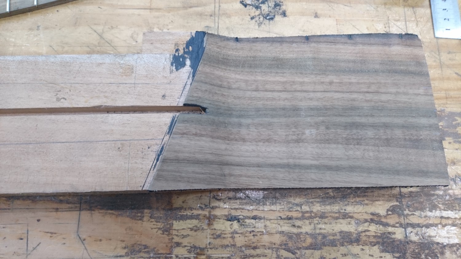

    Trimmed the excess off the headstock, and cut back the veneers on the top to allow for the fretboard

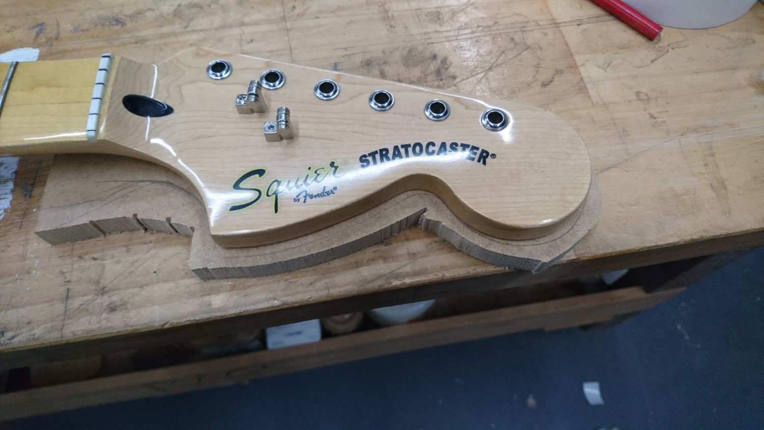

    Made a template for the headstock shape from the original neck because it would be easier to do that than use the actual headstock and deal with two necks stuck together
Name:	DSC_0053 (Custom).jpeg

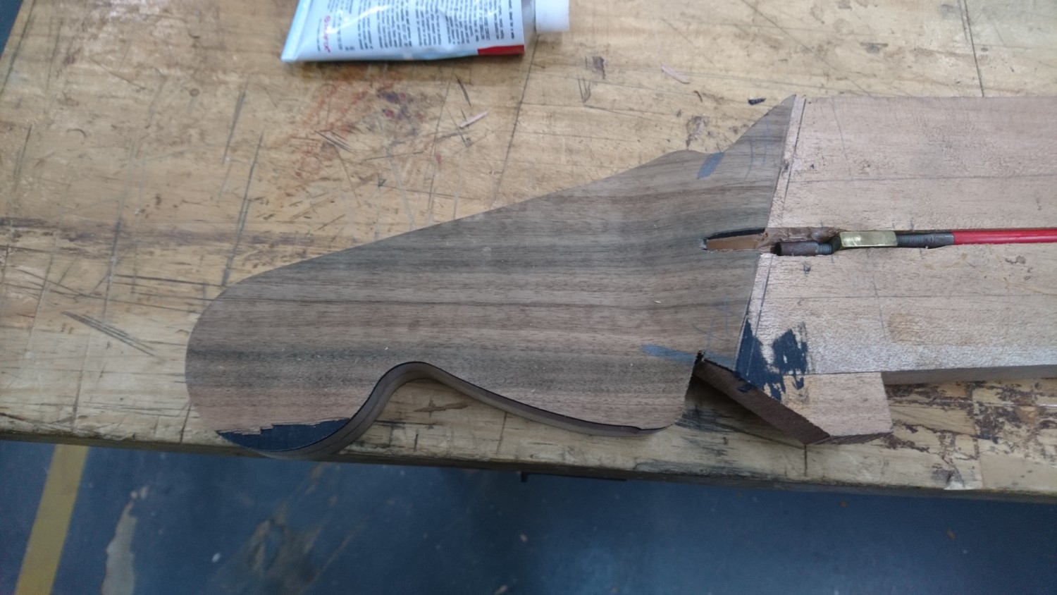

    Routed most of the headstock shape with the newly made template
Name:	DSC_0054 (Custom).jpeg

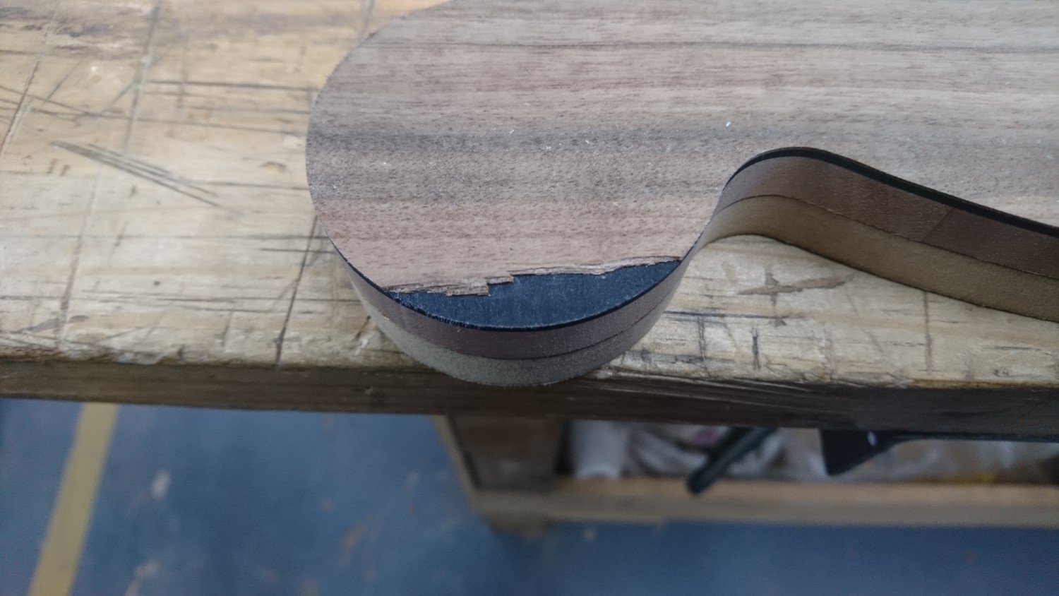

    But oh dear, can you see the first oopsie??
Name:	DSC_0056 (Custom).jpeg
    When I rough-cut the shape with the bandsaw, it didn't do the cleanest cut, so when I was routing this part of the Walnut popped off. Won't be a tough thing to fix though, and it won't be too obvious when it's stained
Name:	DSC_0058 (Custom).jpeg
    Second oopsie. I thought I was touching the wood when I got to the end-grain, but I wasn't, and the router took a bit of a bite out. It's not too drastic though, fortunately, so all will work out.

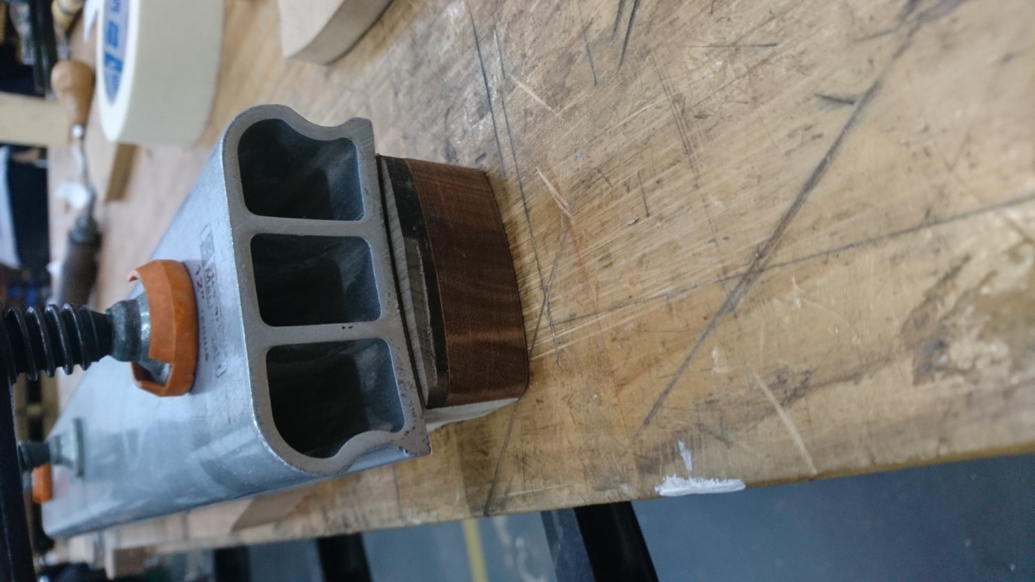

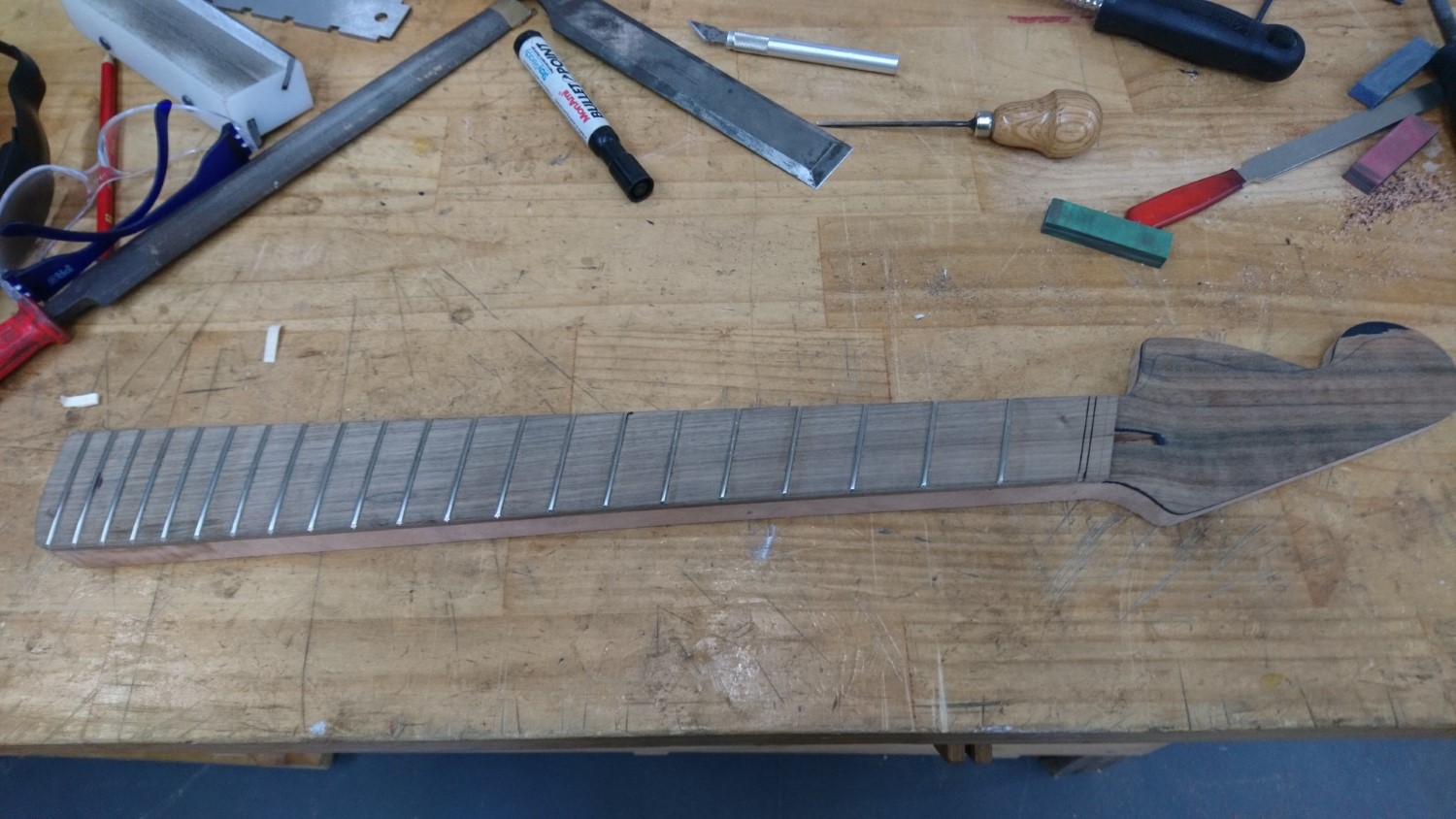

    Then with the Truss rod all sorted and everything fitting in place nicely, the fretboard was glued on.
Name:	DSC_0060 (Custom).jpeg
    Flush heel!!!!
Name:	DSC_0059 (Custom).jpeg
    I am glad it all managed to fit together rather nicely, but I will say though: I'm never doing the frets before attaching the fretboard again, it causes too much worry and feels like a bit of a leap of faith that it will all fit together properly. But it's on and looking good, so we're good for now, and happy days.

    Yeah, I found that fun out with the P.E. SV, although mine was more due to the poor first up glue job allowing the board to separate from the neck. It’s amazing how much bow the frets induce in the board.
    Wonderful work B, that is looking amazing.
    edit: btw what glue are you using for the veneer/fretboard?
  6. #16
    Thanks guys
    Titebond II I believe. It's been put in other, smaller bottles though so I am not 100% certain

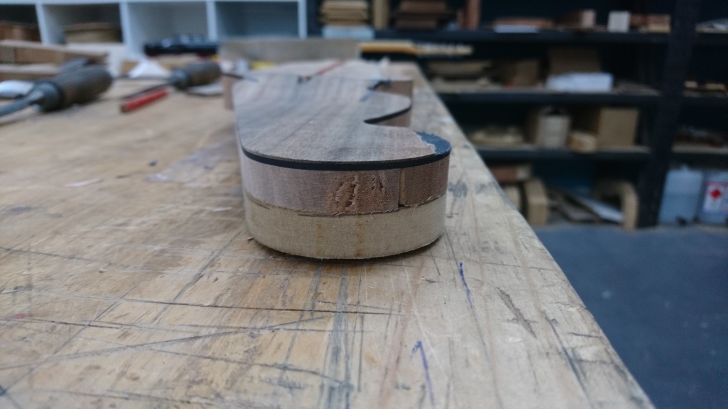

    With that done, I decided to abandon cutting off a new bit of veneer and gluing it to the headstock to tidy it up, and just turn the stuff-up in to something more interesting! Quite pleased with how it turned out, honestly
