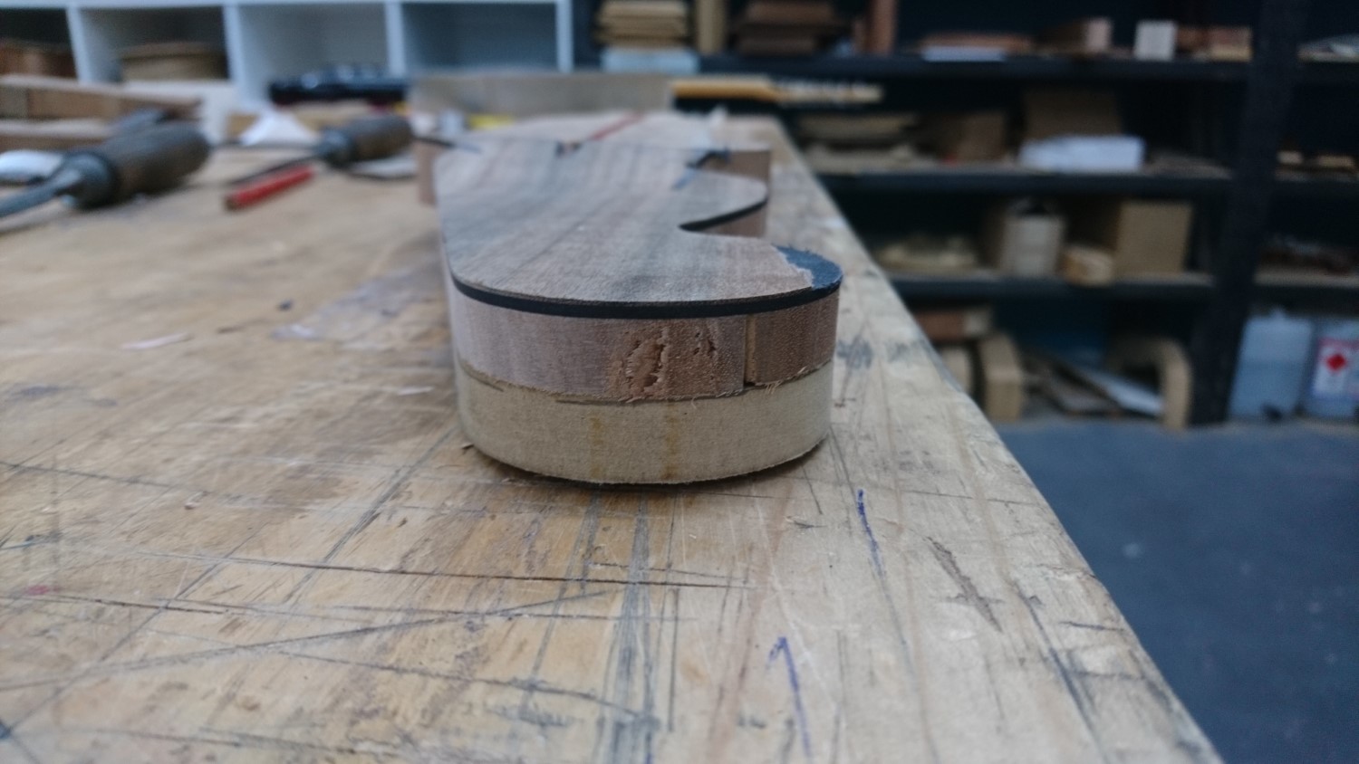

When I rough-cut the shape with the bandsaw, it didn't do the cleanest cut, so when I was routing this part of the Walnut popped off. Won't be a tough thing to fix though, and it won't be too obvious when it's stained
Name:	DSC_0058 (Custom).jpeg
Second oopsie. I thought I was touching the wood when I got to the end-grain, but I wasn't, and the router took a bit of a bite out. It's not too drastic though, fortunately, so all will work out.

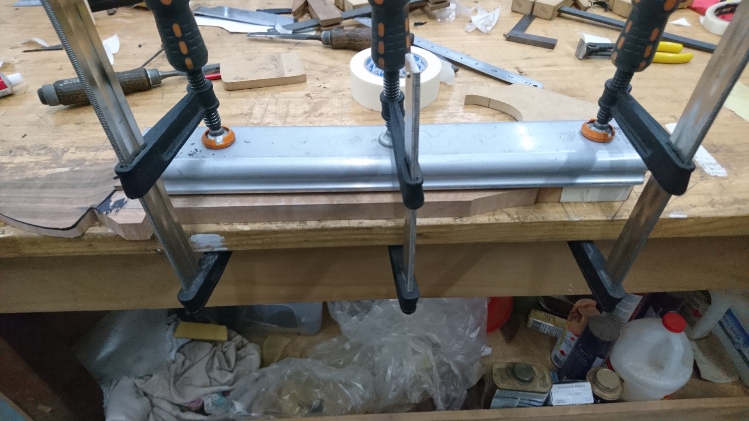

Name:	DSC_0060 (Custom).jpeg
Flush heel!!!!
Name:	DSC_0059 (Custom).jpeg
I am glad it all managed to fit together rather nicely, but I will say though: I'm never doing the frets before attaching the fretboard again, it causes too much worry and feels like a bit of a leap of faith that it will all fit together properly. But it's on and looking good, so we're good for now, and happy days.
Now I'm gonna collapse. Be well, everyone, and may you have a lovely day
Yeah, I found that fun out with the P.E. SV, although mine was more due to the poor first up glue job allowing the board to separate from the neck. It’s amazing how much bow the frets induce in the board.
Wonderful work B, that is looking amazing.
edit: btw what glue are you using for the veneer/fretboard?
