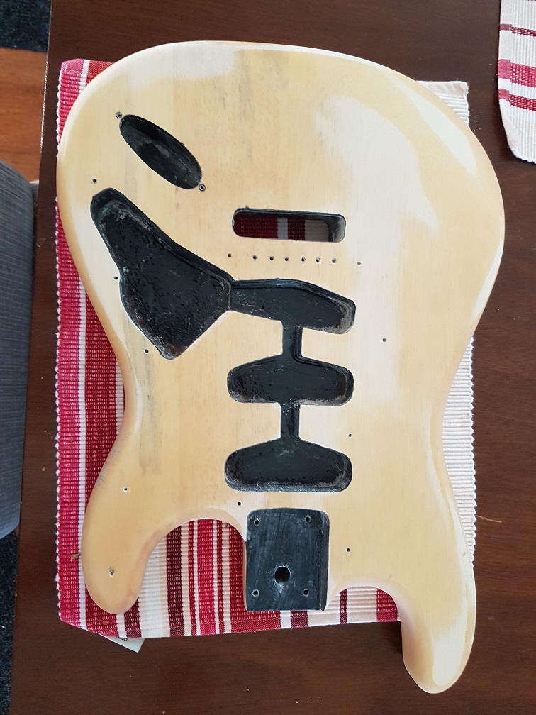

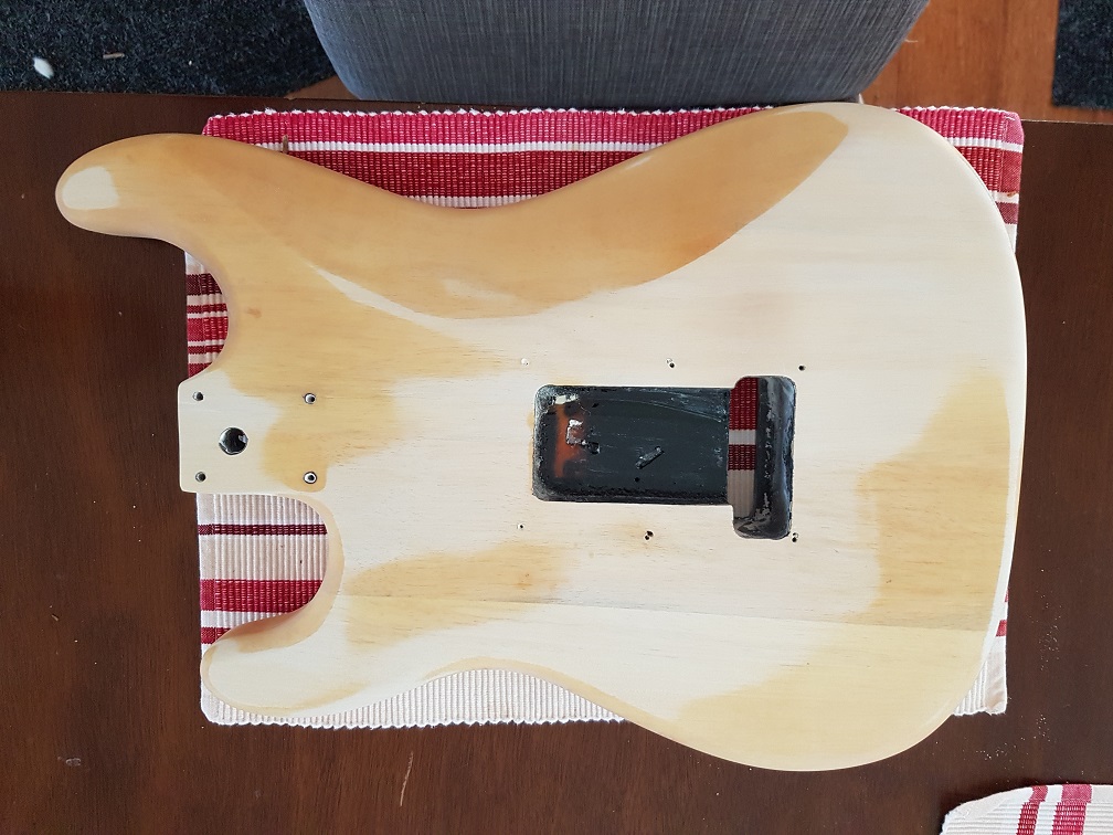

    Well that was hard work, but she's finally naked. Nothing to horrible.
    Now the prep really begins I suppose.

    Plan at the moment is cream / Vintage white, Red tortoise shell pickguard and trem cover. Fender Parchment knobs and pickup covers, new Wilkinson Bridge and a set of Tonerider vintage PUPs

    Just trying to figure what timber that is? From the colour and lack of any defined grain that would suggest Basswood?
    Current ones are now American alder, though depending on the age it may be 'eastern poplar'. But I don't think they've used Basswood for the Vintage bodies.
  6. #16
    looks too blonde for Alder.
  7. #17
    I'd go with the poplar then. Looks a similar colour to a lot of the poplar wood samples I can find on line.
  8. #18
    Don't think its basswood, No fibres and its been grain filled. Not that I'd really know, haven't seen basswood or played with that I'm aware of.
