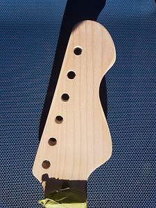

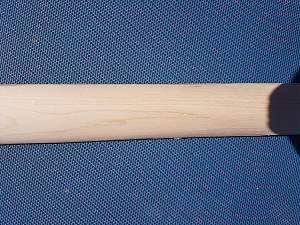

    So, refinishing the neck, its going to be straight TO probably. Question with maple being pretty dense, would doing an ebony timbermate help bring out the bit of grain there is, or would I just be putting it on and sanding it off for no real gain?
    Cheers

  6. #36
    Quote Originally Posted by Rossc0 View Post
    Probably not. There just isn't the grain holes to push it into.
