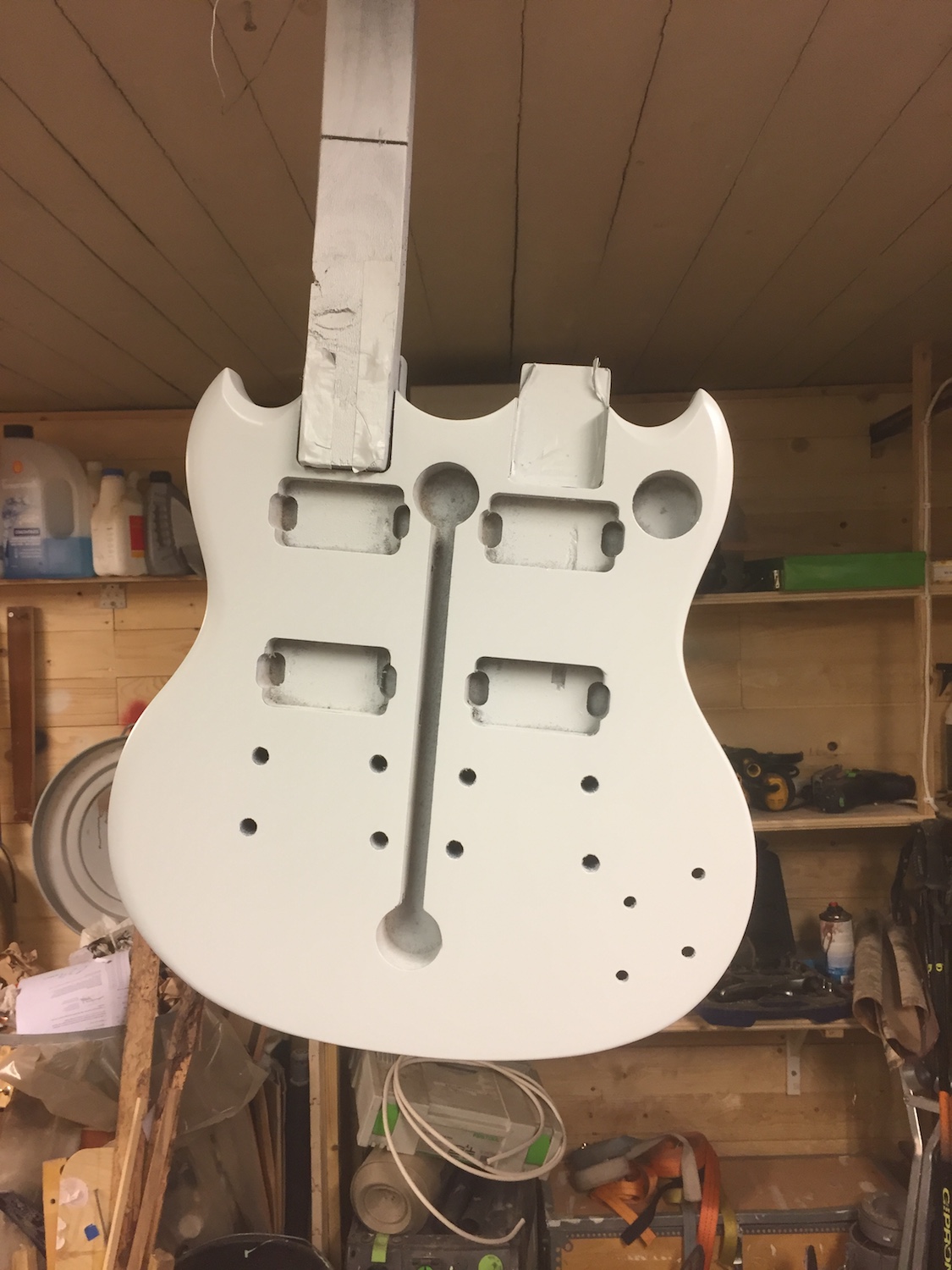

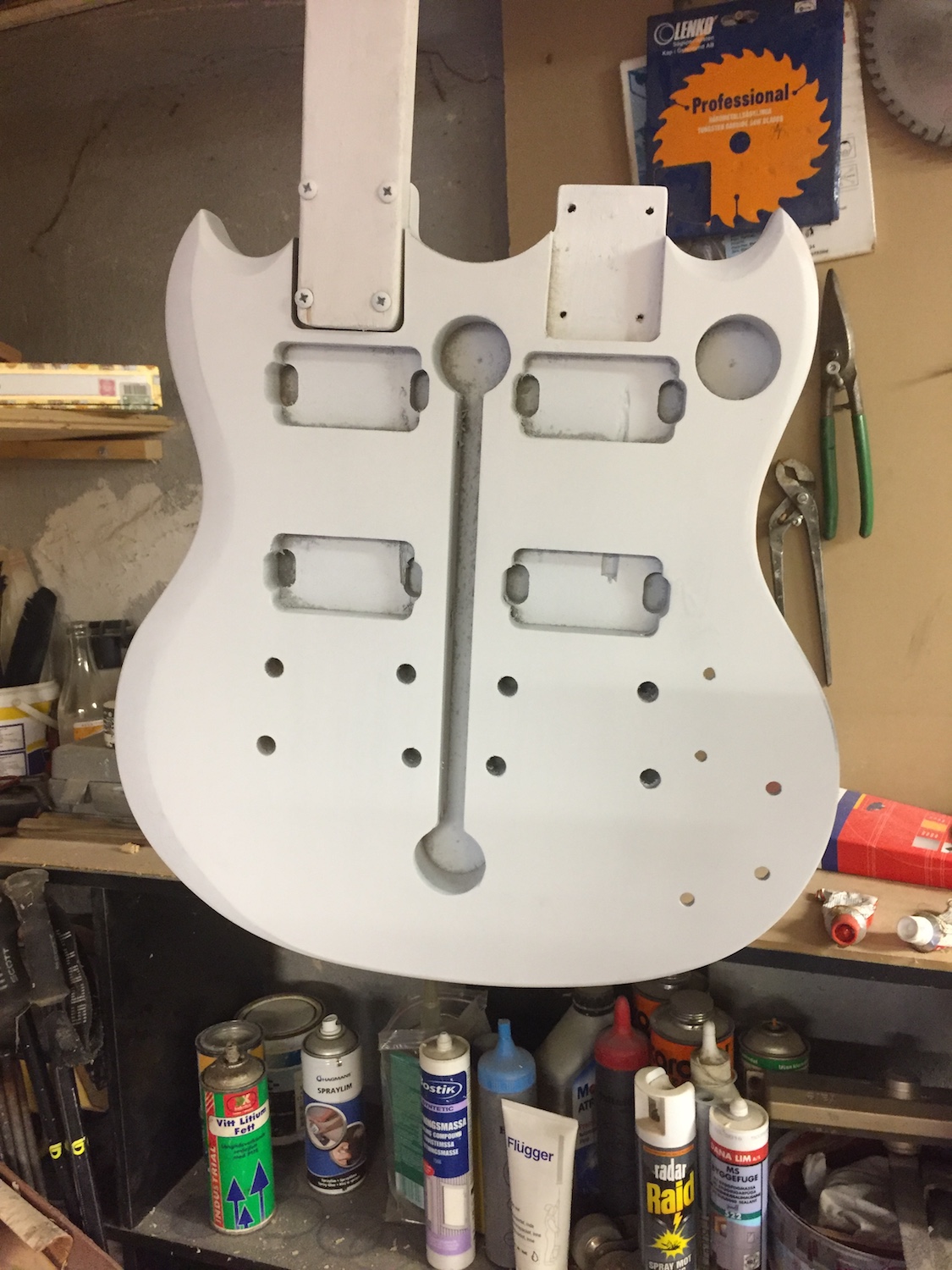

    Been down at my workshop for a couple of hours and getting closer for some paint on the body

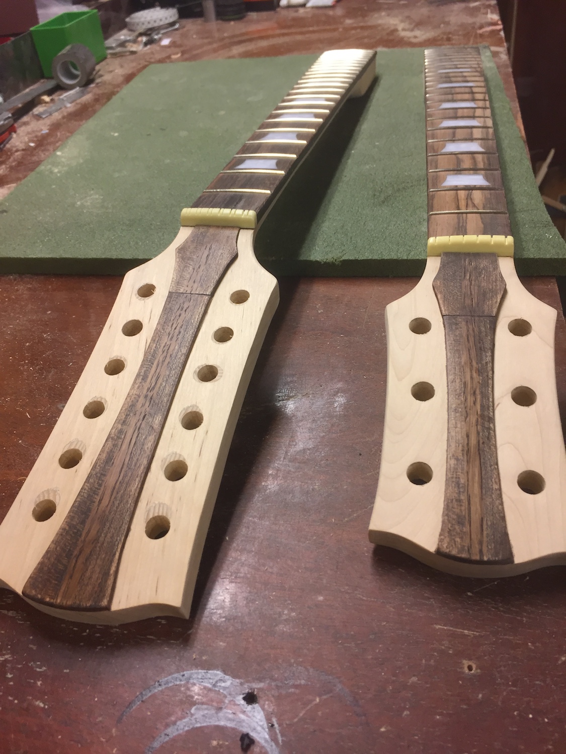

    Ive also started to work a bit on the headstocks
ID:	20720Click image for larger version.

    I had some issues with the primer vs paint and needed to sand it all down to bare wood and apply another primer that was compatible with my main paint.
    so after a few days of frustration im now at where i was a few days ago, but this time the paint wont crack when i start to paint the guitar and necks.
    Ive learned the hard way that you need to know BEFORE you start to put on the primer if it is compatible with the 2 componet paint and if you aren't shure, test it on some scrap wood you have lying around so you dont need to put loads and loads of work into sanding down to bare wood.
    Here are some pics of where im currently at in the progress.
    Body and necks
    Headstocks
    Still love the grain on the 6-string neck
    The body, ive reposition the controlls bit as i felt that the bridge would be in the way.
    I've also moves the jack to the front just because i can
