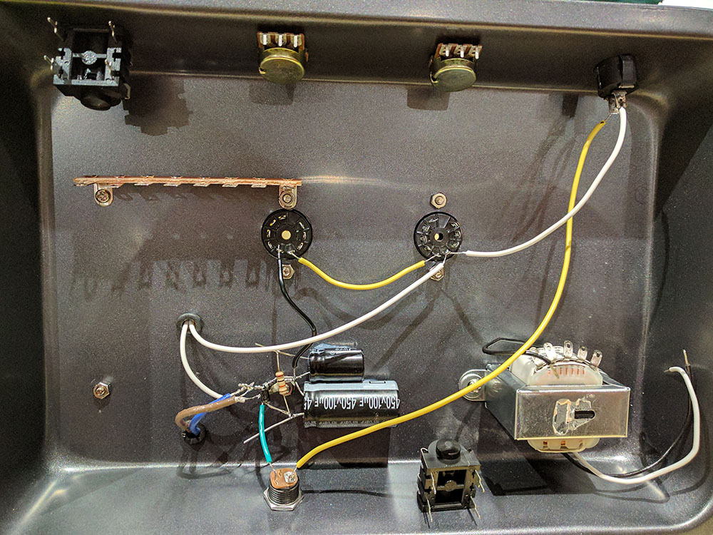

    So I'm about 10/15 steps in on the wiring up the power supply section which looks like:
Name:	2017-05-15 23.43.25.jpg

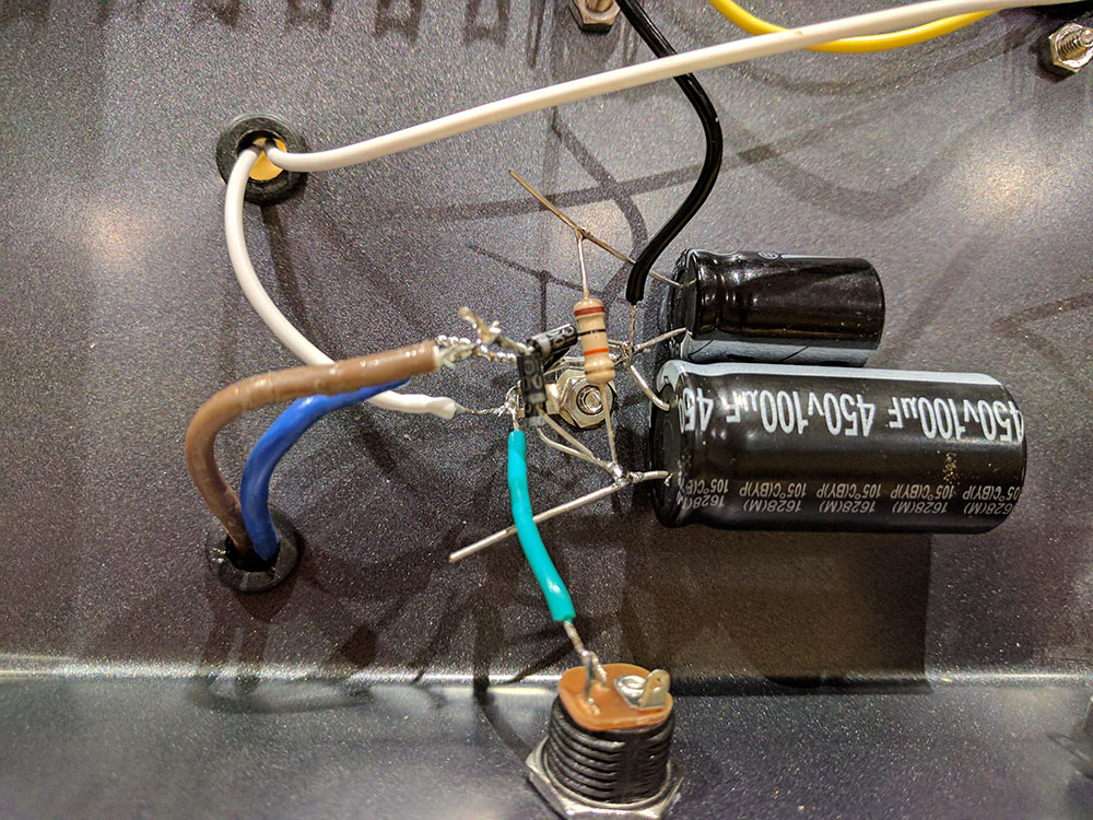

    One issue I have come across with the instructions is with the order it gets you to solder things to and around the star ground means you layer stuff above it before you've finished soldering wires to it.
Name:	2017-05-16 18.29.54.jpg
    The green and black wire in that picture were soldered in after the diodes and and the resistor.
    The star ground being the tab behind the lower diodes
    I may have cheated with the black wire
    Power supply done:
Name:	2017-05-16 18.43.34.jpg
  6. #16
    Quote Originally Posted by Maddogm View Post
    Power supply done:
    You could try adding more solder eyelets to the Star-Ground.
  7. #17
    It's more getting the soldering iron etc in there
    I think if I was doing it again (like the other lamington amp I have), I'd cut the wires going in there to length and solder that end on before adding the diodes over the top

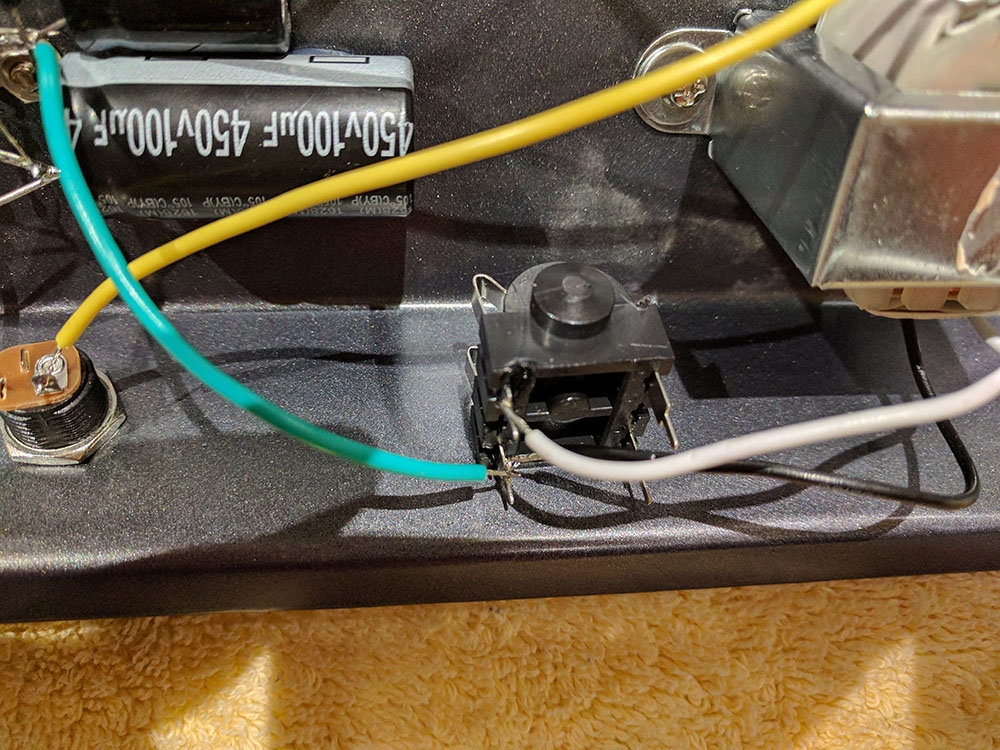

    made some more progress
    Oops:
Name:	2017-05-16 22.40.50.jpg
    I'm onto the output stage now:
Name:	2017-05-16 22.41.02.jpg
