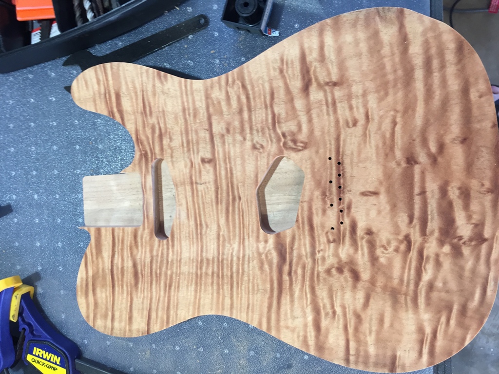

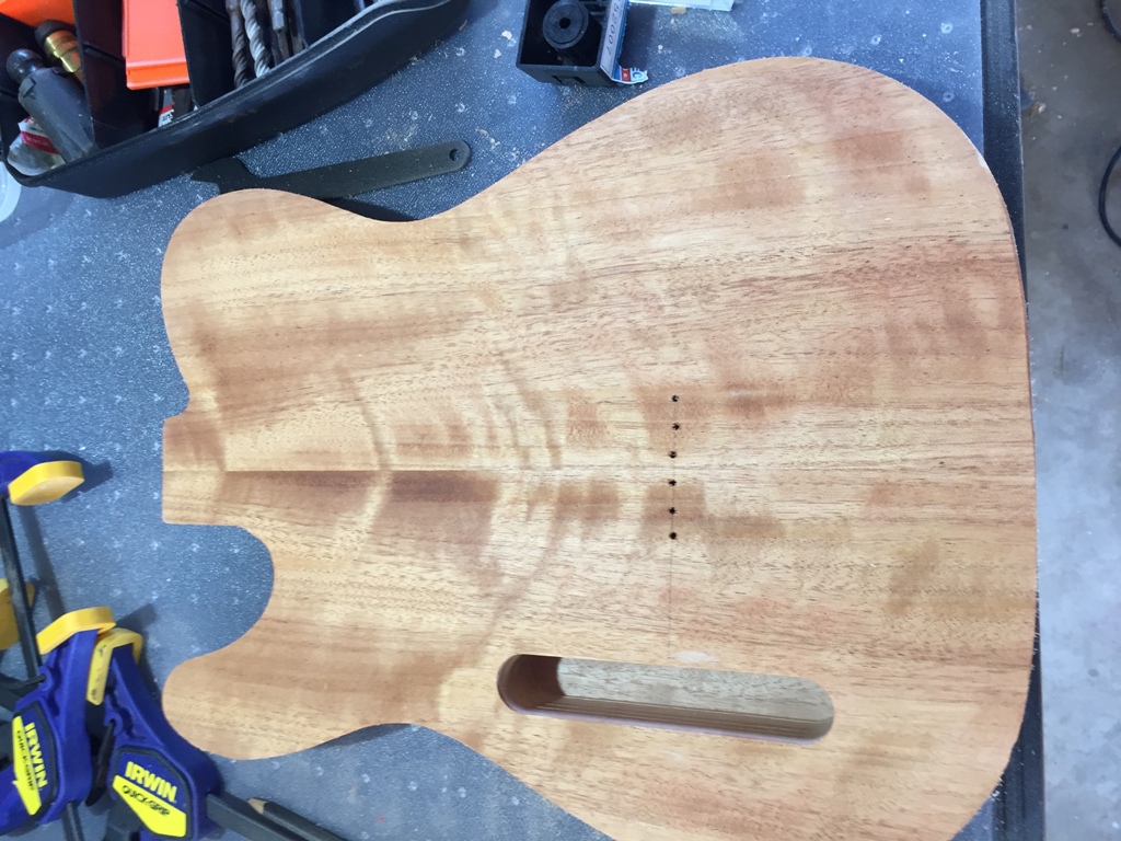

    Ebony coloured is fine.
    Doing a Blackwood neck for this, this weekend so will be able to use pretty much straight away.
