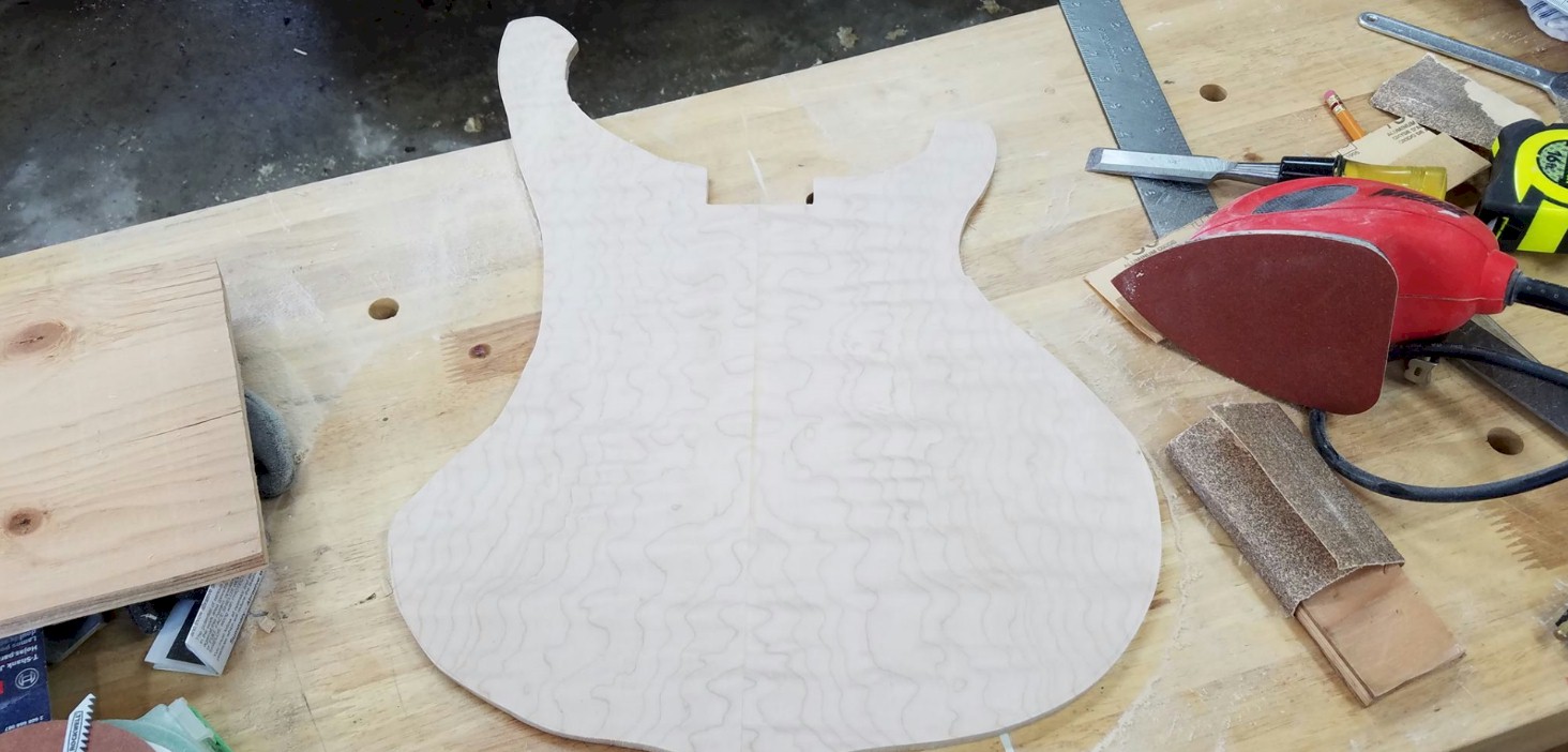

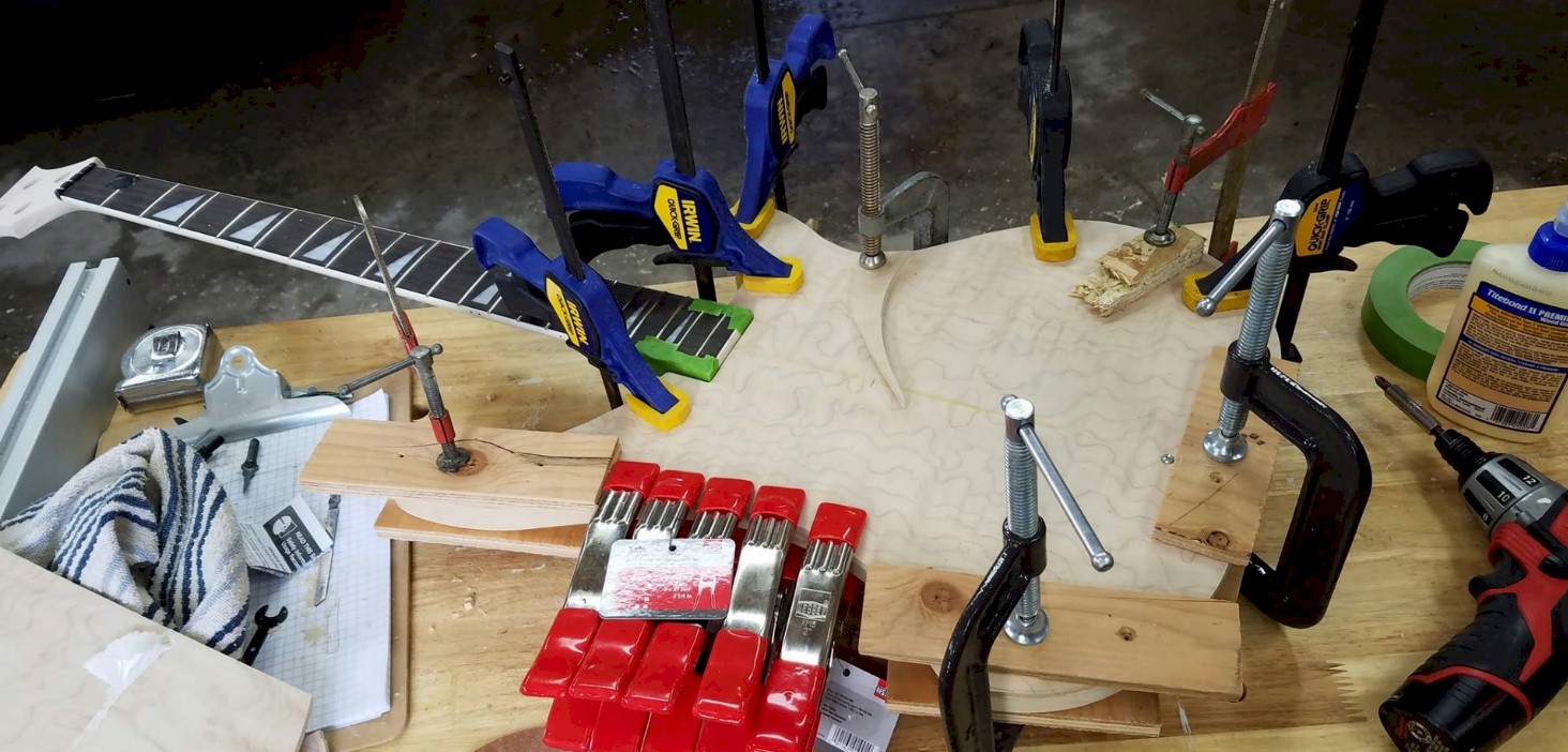

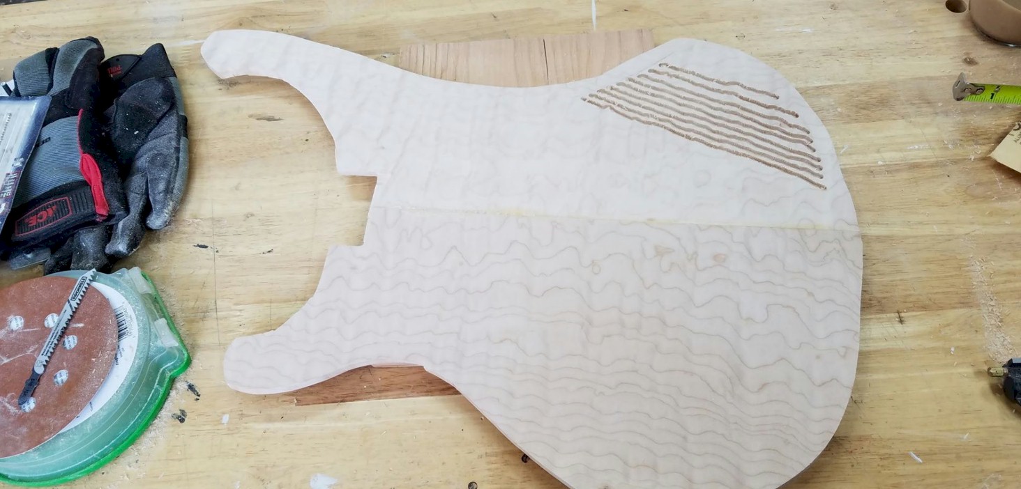

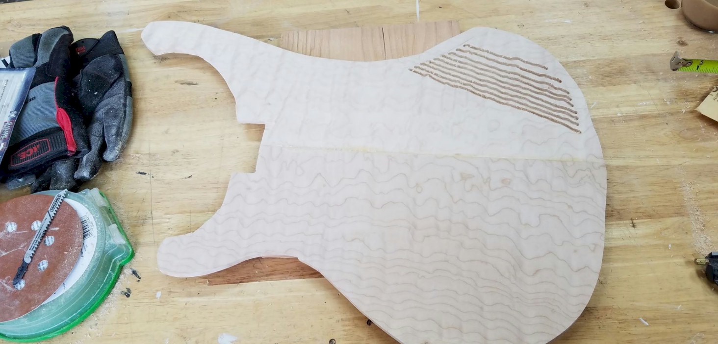

    So today was glue the maple top to the freshly planed and contoured body day...I'd set the neck and let it be overnight, so the first thing I had to do was cut out the shape and the pocket for the neck.I figured out where my center line was through the center of the neck so I could properly align the seam on the maple cap and drew an outline of the body with a pencil and cut that out. Then, using the center line as a guide, I calculated the cut-out needed to fit around the bottom of the neck. I cut it a shade small and the sanded by hand to get the fit I wanted:
    Note to self...when cutting the body shape out of the $120.00 piece of maple, take your time and give yourself plenty to work with.
    I test-fitted it about 100 times and took my time sanding, which was good because it turned out that I didn't give myself much margin for error (in other words, hardly more than none) as I should have when I cut out the cap and I ended up just BARELY covering the whole body. Dumb, rookie mistake, but I got lucky and was able to make slight adjustments to the cut out for the neck to make it work...by a hair or two.

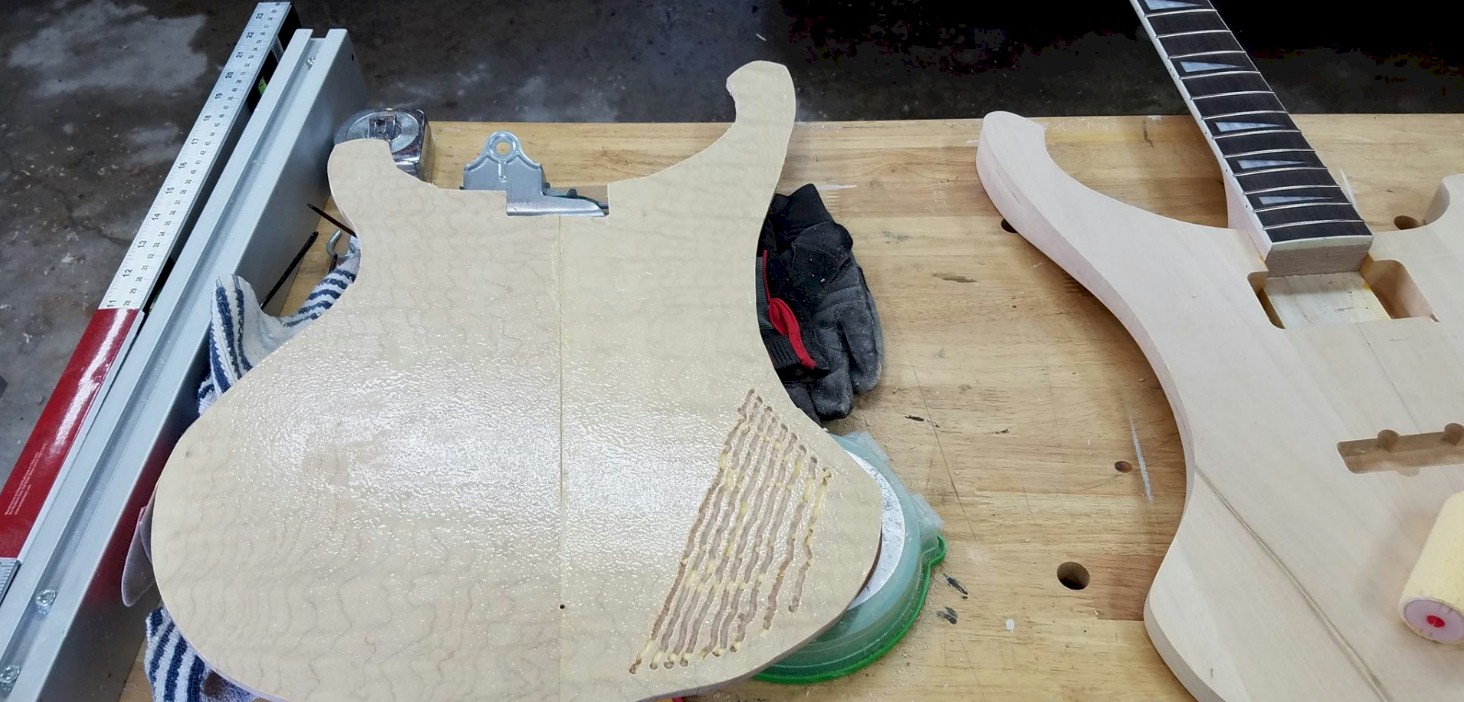

    So, to do the forearm contour bend, I tried the kerf-cut trick I found on YouTube. My cuts aren't as nice as the ones that guy did (I'm a router newbie)...
    ...but it did work (and no one will ever see my squiggle-cuts anyway...next time I'll use a guide) This is actually a pretty slick way to do it, barely even requiring router skills...mucho pleased.
    And then the moment of truth...glue time:

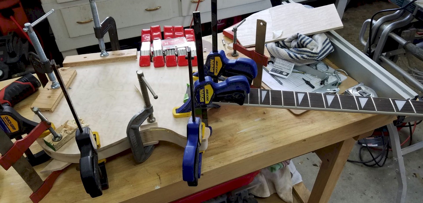

    Now...I'm sure everyone knows this, but when you do this, there's no such thing as too many clamps. I had ten clamps and a half-dozen 2-inch spring clams (pretty worthless, but I left them on for comic effect), and I wish I'd had about four more clamps. Everything looks pretty tight, but I'm expecting a gap or two because after planing and sanding the body, I don't think it ended up 100% flat (as close as I could get...I mean...I checked with a straight edge and it looked good to me):
    Yup...that's a pretty redneck clamp-up job (note the OSB), but I think it just might work...or explode in a cloud of maple splinters when I relieve the pressure. Either way will be pretty exciting when I take off the clamps tomorrow

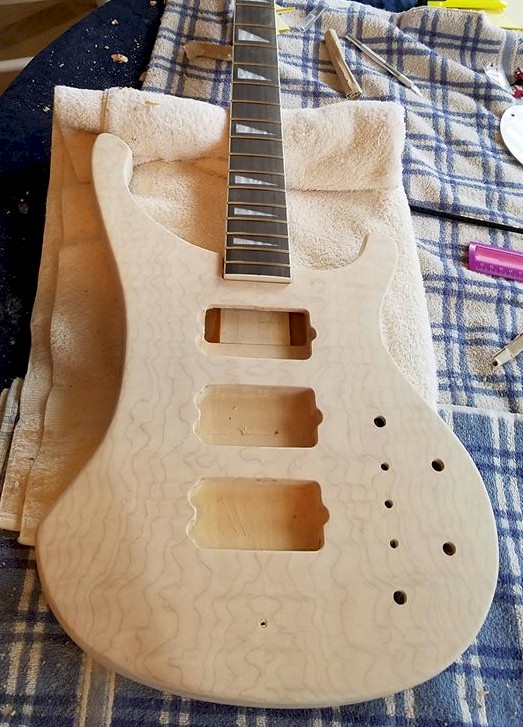

    With much excitement, I took off the clamps today...and nobody died
    Overall, I'm pleased...there's one spot with a thin gap due to my rookie power planing job, but I'm sure that a little glue and sawdust will fix that right up:
    I used a router to clean up the edges and of course had a slight disaster over the hole for the cord jack...for which I feel double-stupid because I knew it was going to be tricky, so I started there and had it perfect, and then coming around from the other side I forgot it was there and messed it up ANYWAY. Very slight though, and ten minutes with the sander fixed it.
    I took the time to pull out a set of mm-style pickups just to see what it might look like...yeah, it's a bit scary, but that's why it's going to be awesome! I'm doing all black hardware over red quilted maple (debating doing a burst...the back will be black), but that bridge looks absolutely anemic next to those pickups...that WILL NOT DO! The bridge I have is too shallow anyway by about 1/8" so I'm thinking about one of those black Hipshot Ric replacement bridges. Need something beefier to be sure...originally I was going to do a BadAss III, but...I don't know...gotta find something MASSIVE. My first real bass was a Peavey T-45...now THAT was a massive bass bridge.
    Of course, since the neck is in the way, I couldn't use the router for all the cleanup...I've got some hand work to do...files and sandpaper.

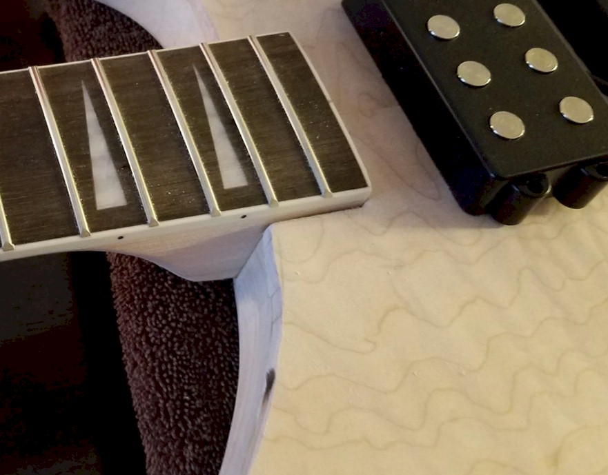

ID:	18093 Click image for larger version.
    I need to hand work the edge of the arm contour, too. That's alright...I'm planning to take about a week to do nothing but sand until everything is dead-on perfect before doing the routs for the pickups (yes...THREE...three BIG ones).
