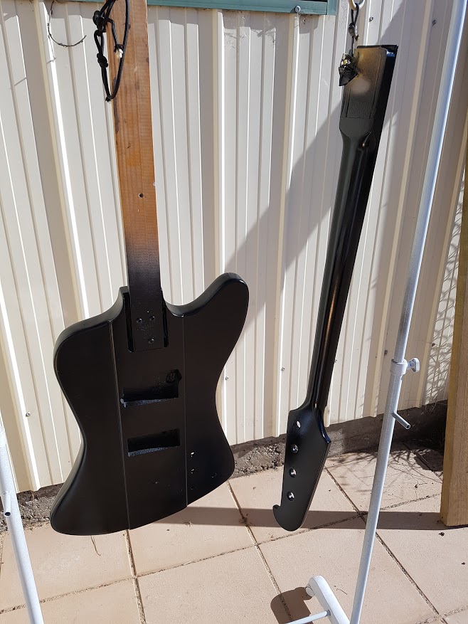

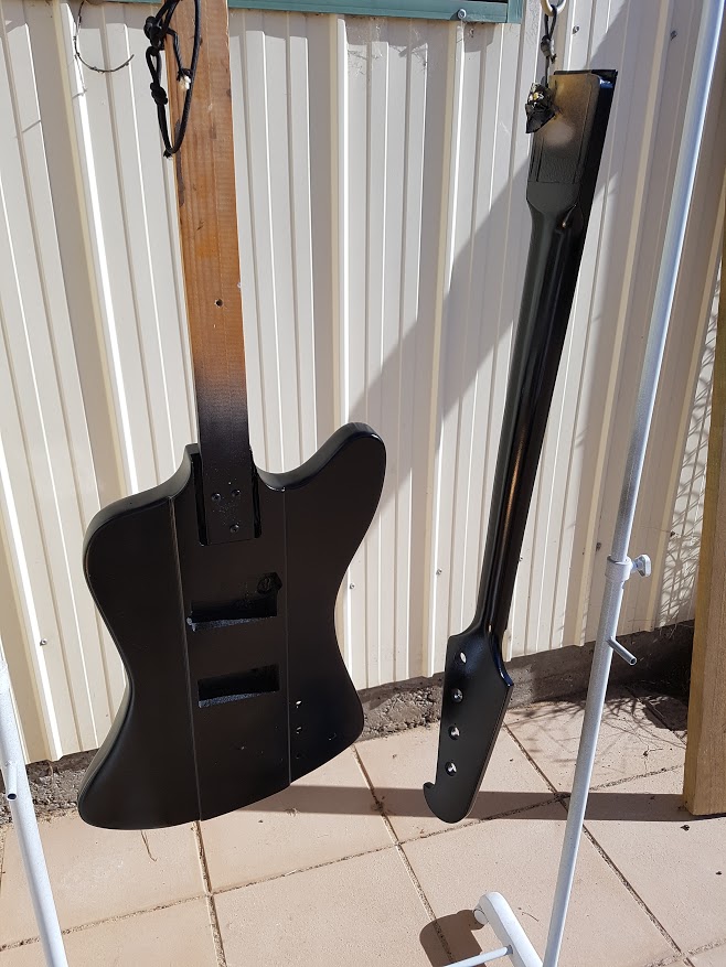

    First coats of primer,much sanding followed.

    Trying to get a decent coat of paint during the Canberra winter

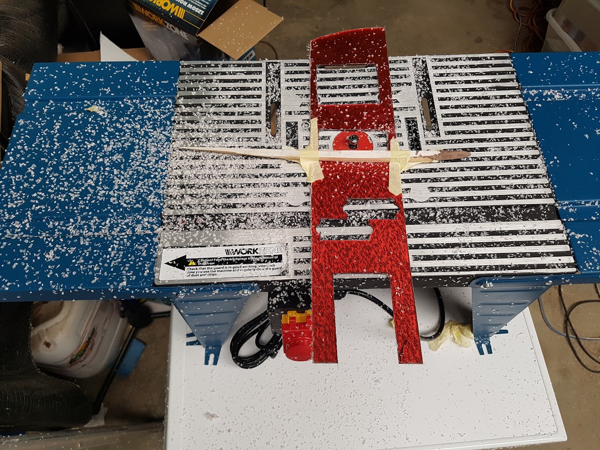

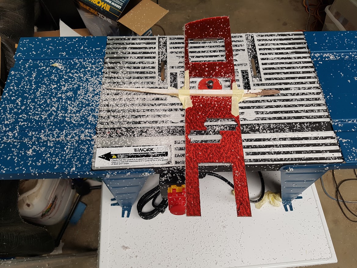

    Cutting scratch plates can be messy.

    So the whole raised centre block will be covered by the pickup/pickup surround?
  7. #17
    Yep Fretworn, trying to highlight that whole center section.
