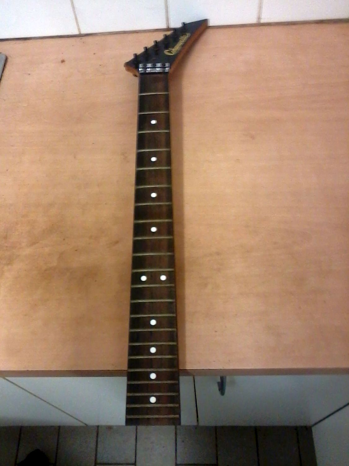

Square-ended neck and round-ended neck cavity on the body, but you should be able to do something about that. Just check the scale length before you screw everything together, just in case the original body had a 24-fret neck fitted.
Good news about the neck pocket.

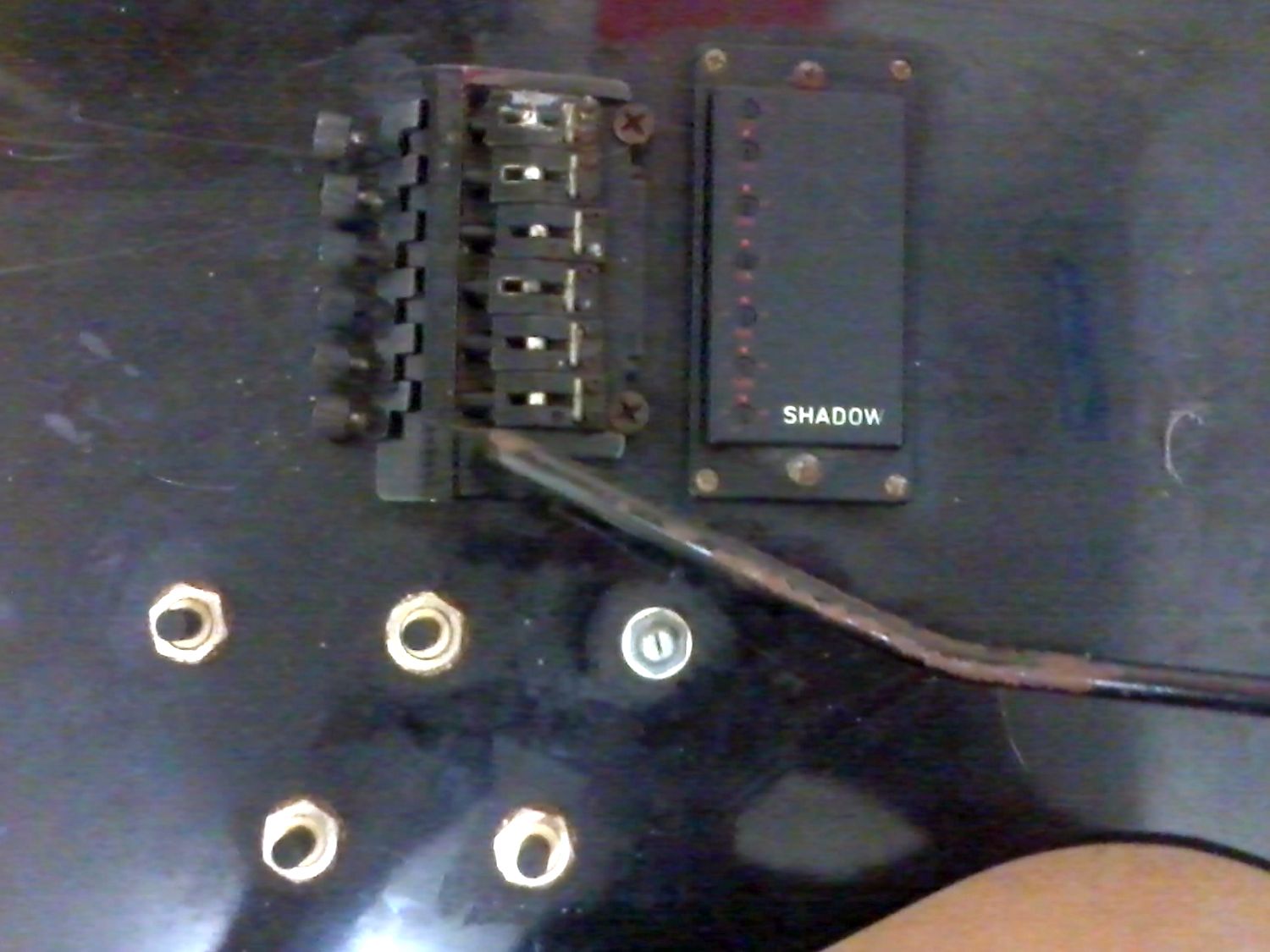

Just been doing a quick Google search to find out what type of Kahler bridge is installed on the body, and apparently it is the Kahler Fulcrum bridge, but the one shown in the pic has string saddles with piezo-electric pickups on them.

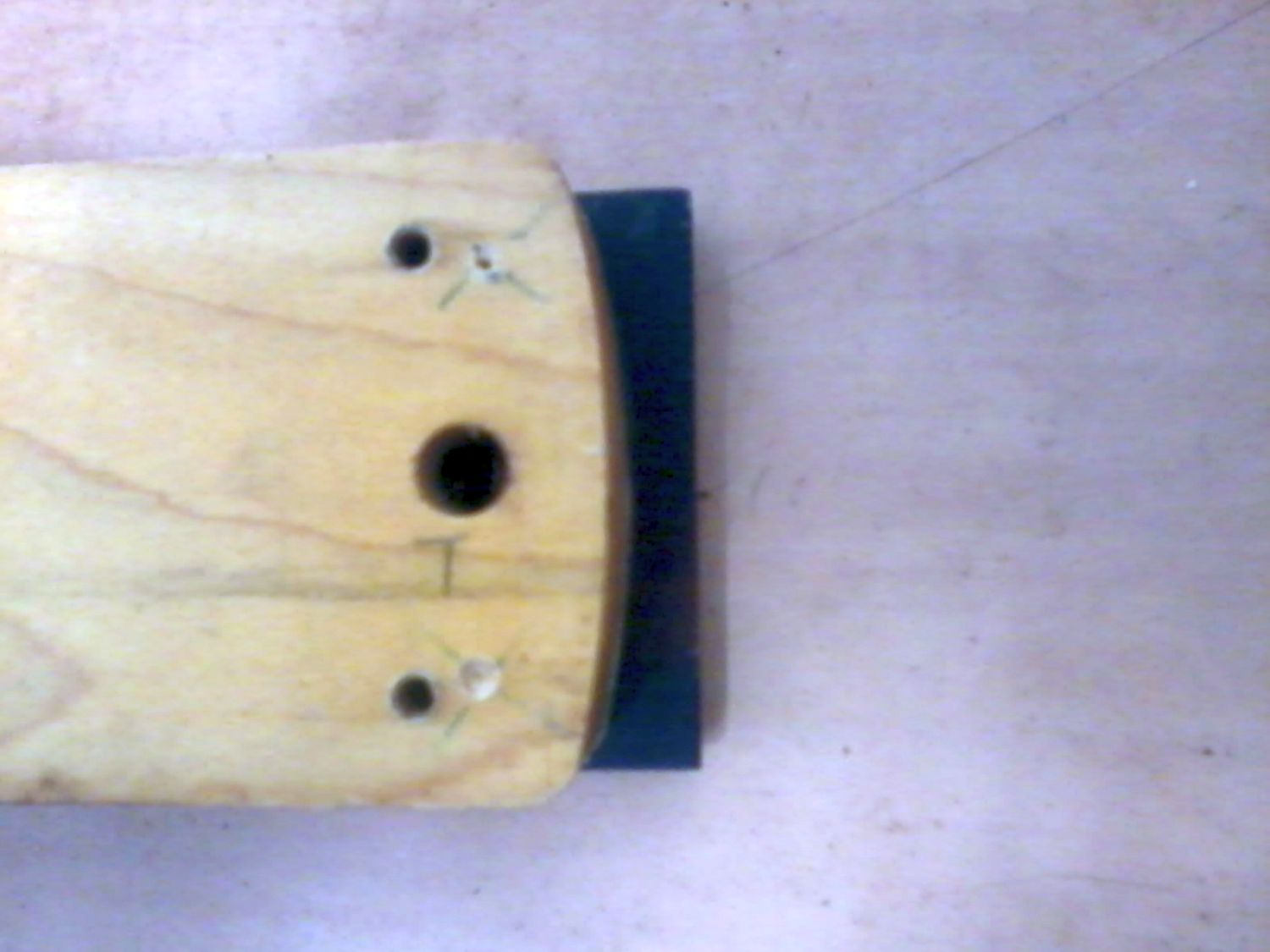

Here's a pic of the back of the neck heel,showing the fretboard overhang:

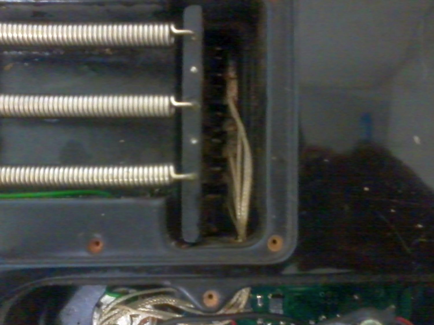

Here's a closeup pic of the back of the trem spring cavity, you can see the signal-wires for the string saddle piezo-electric pickups near where the springs anchor to the sustain block:

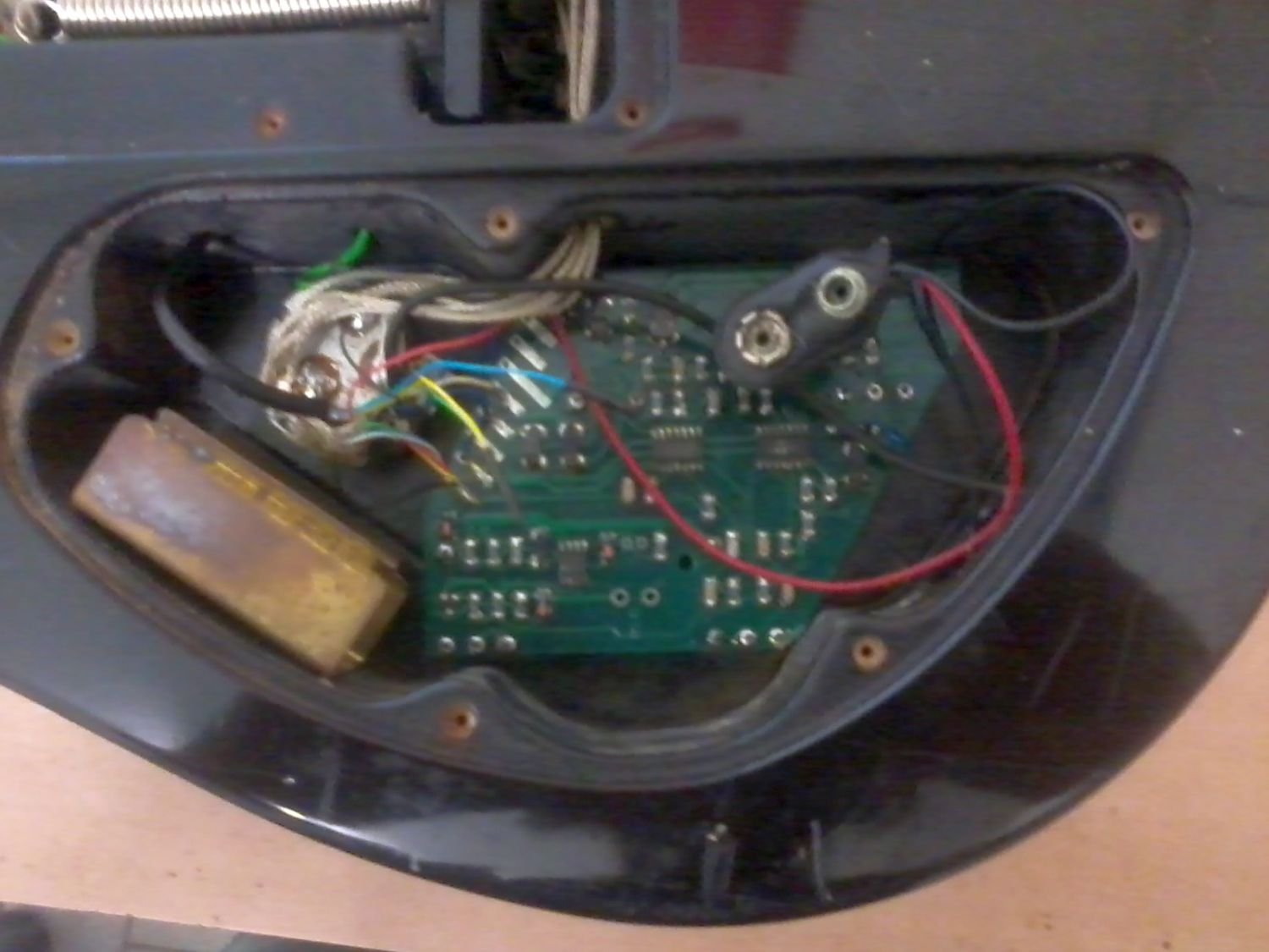

And finally, here's a closeup of the control cavity PCB that contains the active circuitry:

Looks pretty high tech. Hope that the surface rust on some of the hardware does not mean corrosion has also found it's way into those electronics.
As far as I can tell, the electronics seems to look fine, the circuit board looks to have been coated with a fine layer of lacquer to protect the copper tracks from corrosion, the 9 V battery holder looks to be made from brass which gives it a greenish colour.
