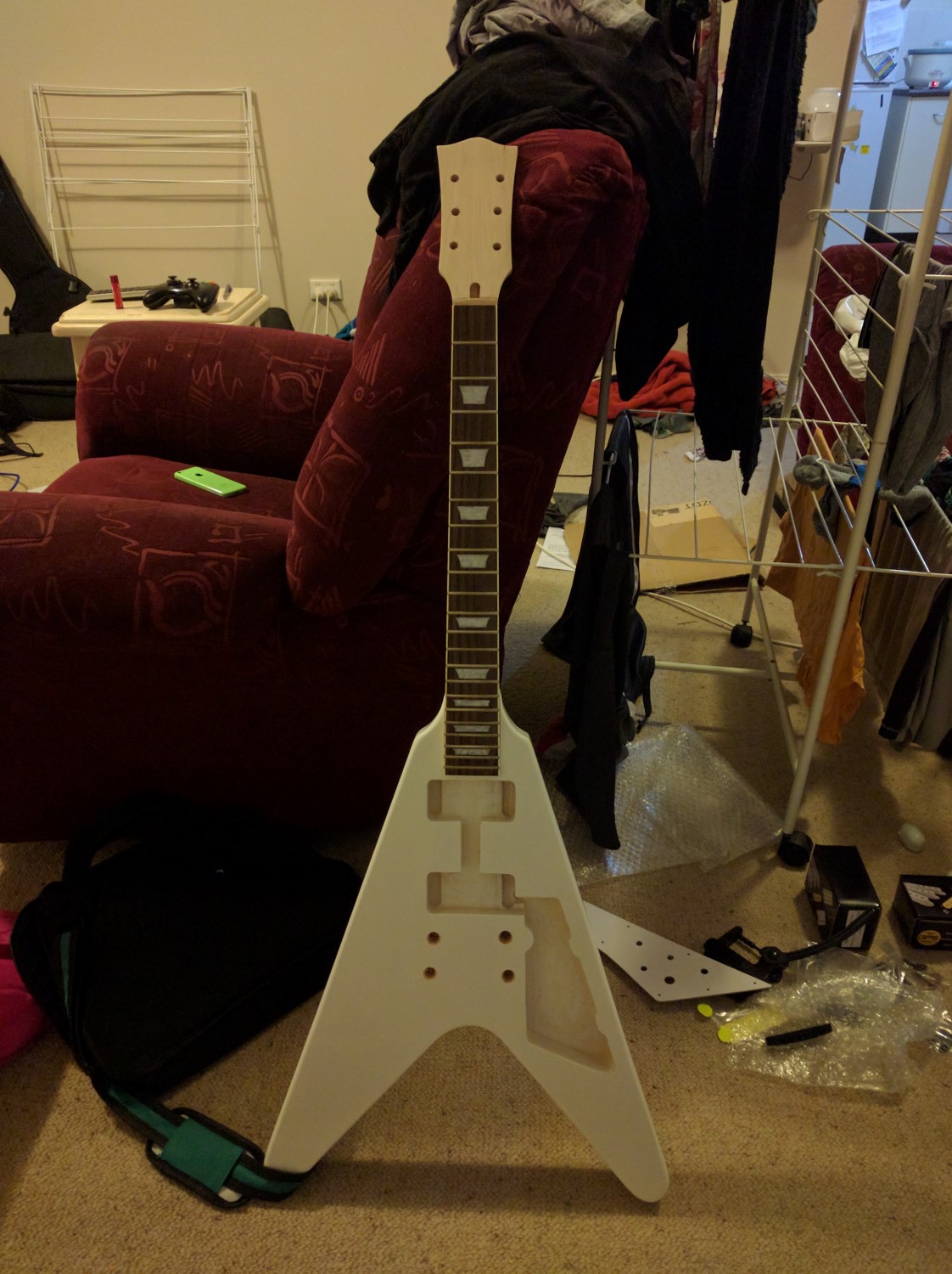

    I've decided to put together a quick build, partially because I was craving building something that was quick and fairly easy, and partially to do something fairly unique with it. So I'm putting together a Flying V.
    I'm using almost entirely stuff from GuitarFetish (I've been interested in some of their stuff for quite a while) and I pretty much saw a potential build, planned it a bit and with a bit of luck, it should be a staple guitar for me.

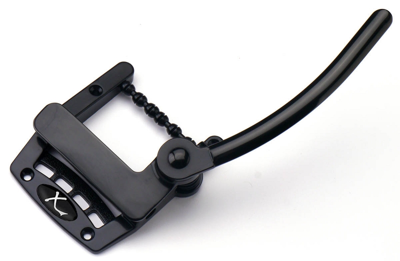

    GFS X-Trem (Bigsby style vibrato)

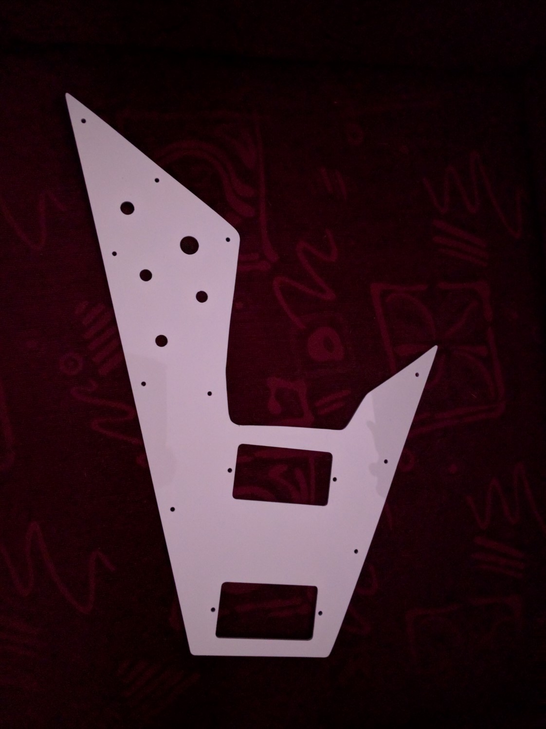

    On top of that, All black hardware, White Pearl pickguard (which I'm going to cut myself so that I can use different controls). Also considering organising a Strat-style input jack on the front, but that would be a good chunk of work and I'm not sold on it in my head just yet.

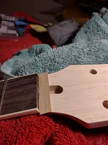

    I'm also going to be a little lazy with the headstock. What I SHOULD do is paint the headstock white to make it match, but I'm just going to oil the headstock as well with the back, and I might later take the oil off and paint it.

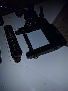

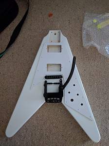

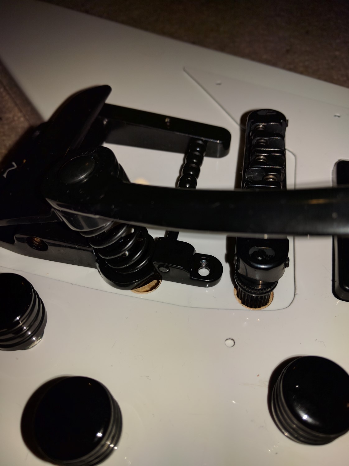

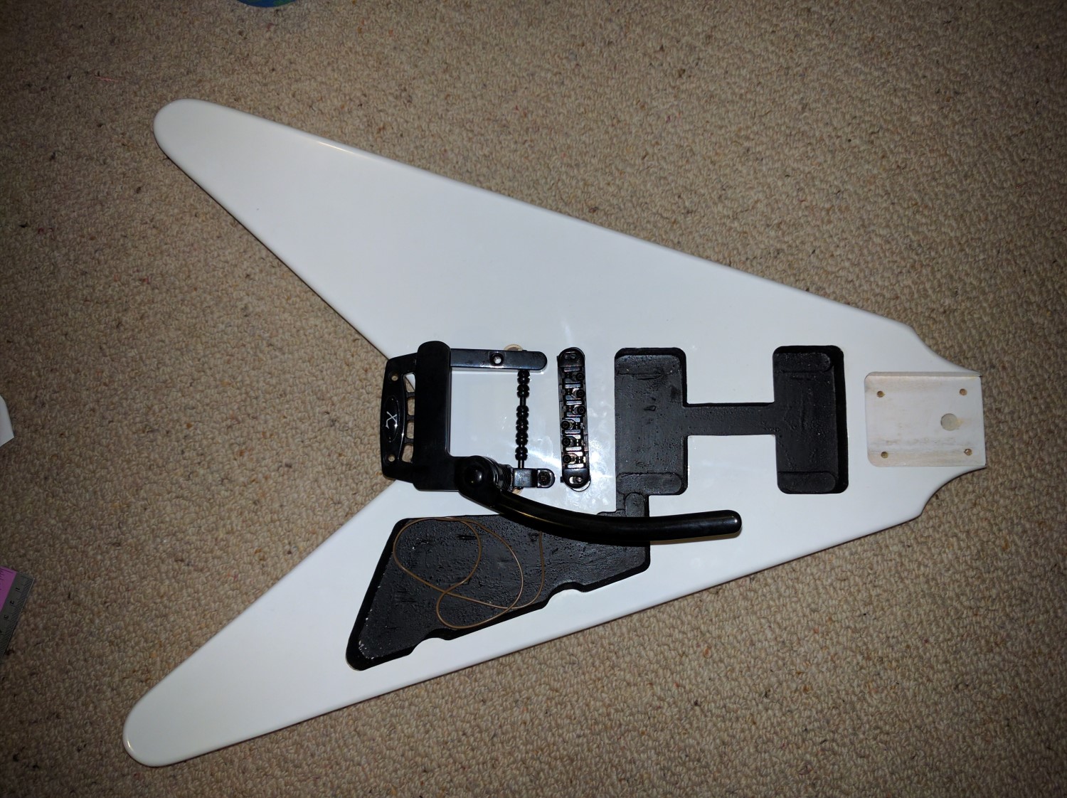

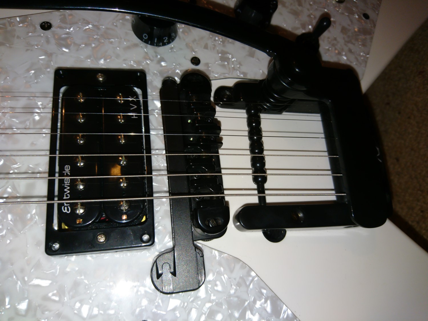

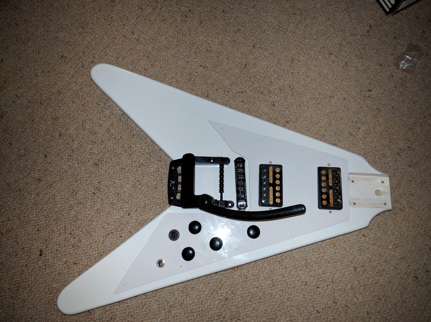

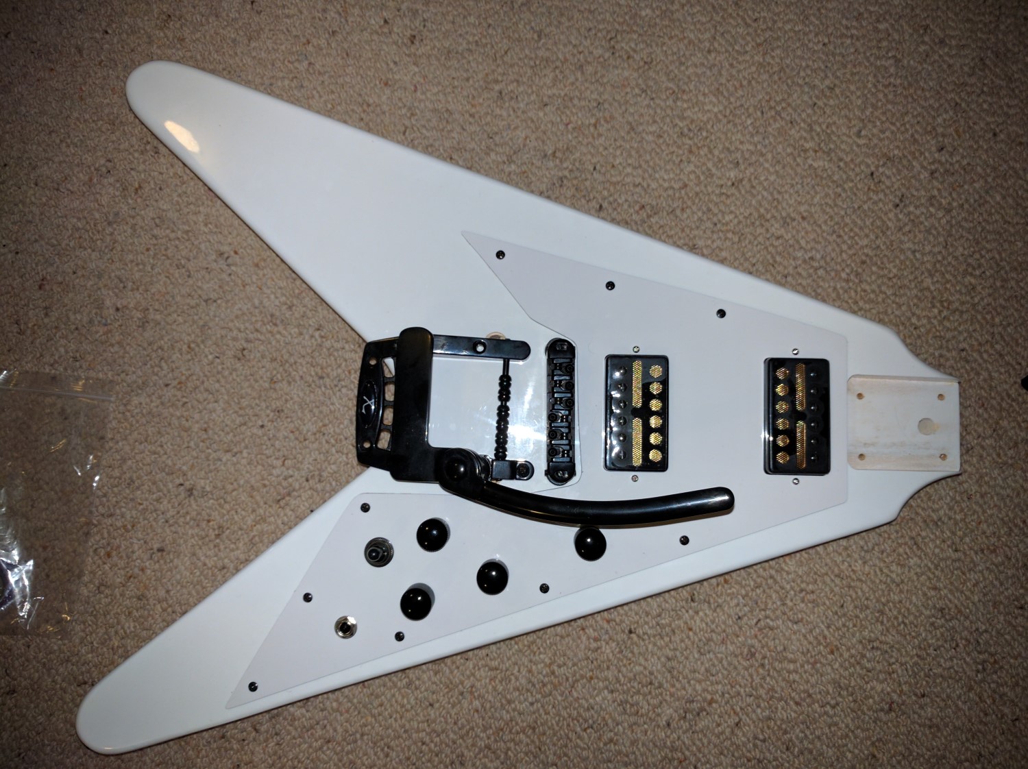

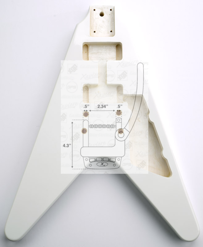

    The other tricky thing is the X-Trem. I did a little mockup (which I don't have on this computer) and the screws, as the holes on the trem are located regularly, don't actually fall on the body. What I am planning to do, is drill a couple of holes further up. I am 90% sure that I will be able to do it, BUT in the case that I cannot, I will forgo that for the time being, and just use a stop-tail, then down the track get a Bigsby and Stop-Tail Vibramate.
