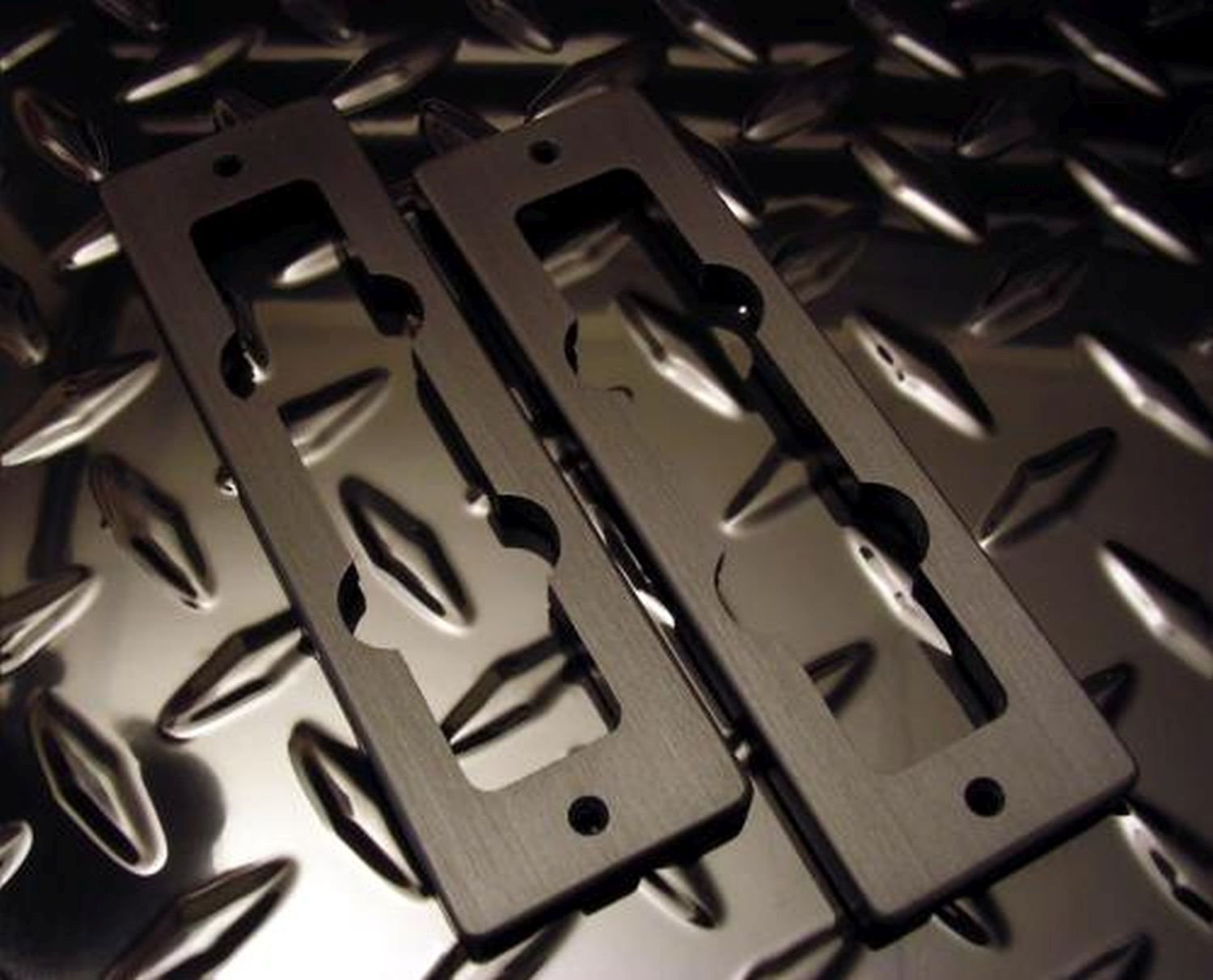

    These ones from hyperlink in a prior post look like they would do the trick and save you a lot of hassle?

    I'm not sure if those are actually gonna cover the neck pickup hole, they don't really look wide enough.
    I'll have a go at making them first and then think about ordering some if it doesn't work.
