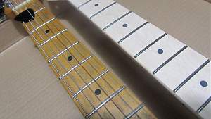

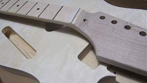

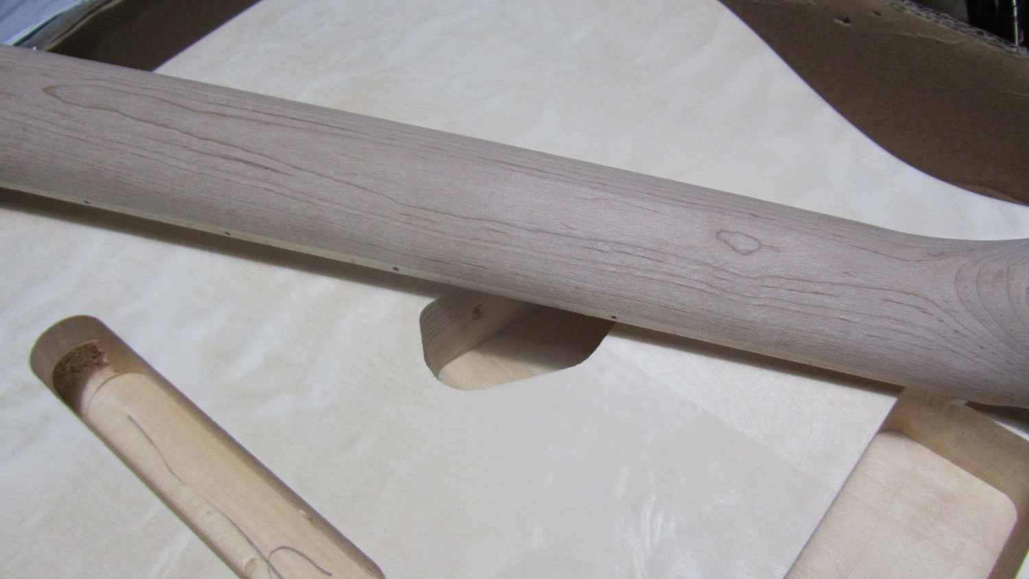

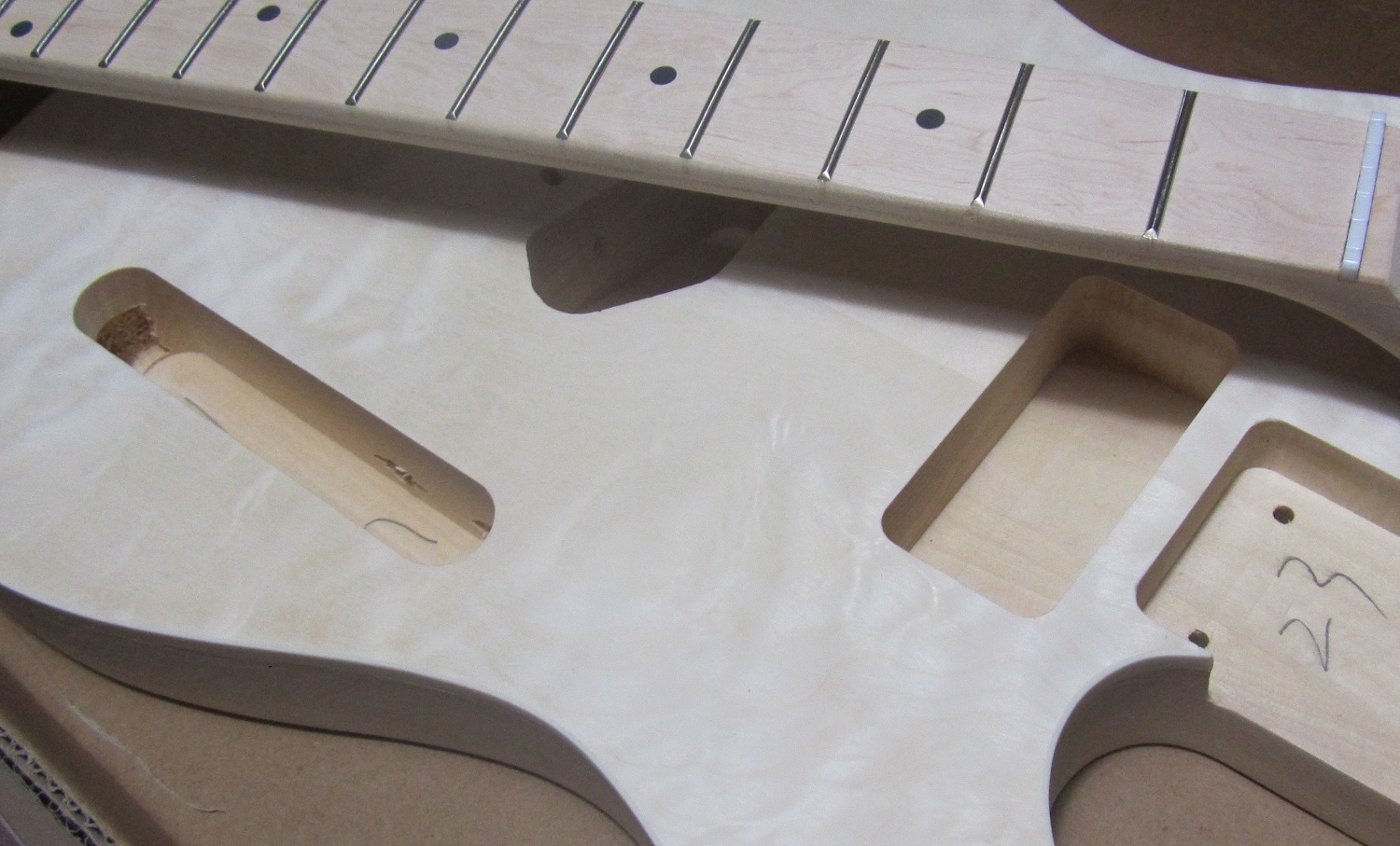

    nice one Honeybadger would love to see some pics of the kit you scored. Thought you said it had a quilted maple veneer earlier ? unless it's a custom order. So your kit has 2 humbuckers ? The body should be alder and the neck maple. If it is mahogany it has a light brown colour to it, much darker than maple.

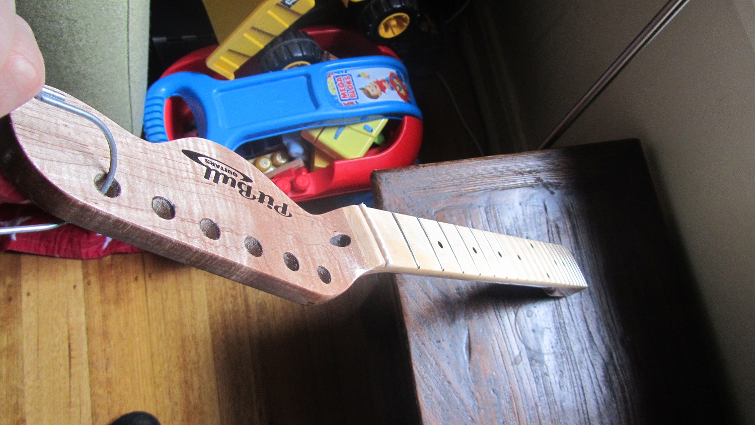

    THX will do, just worked it out regards fret board/Neck got The Thinline Tele neck .

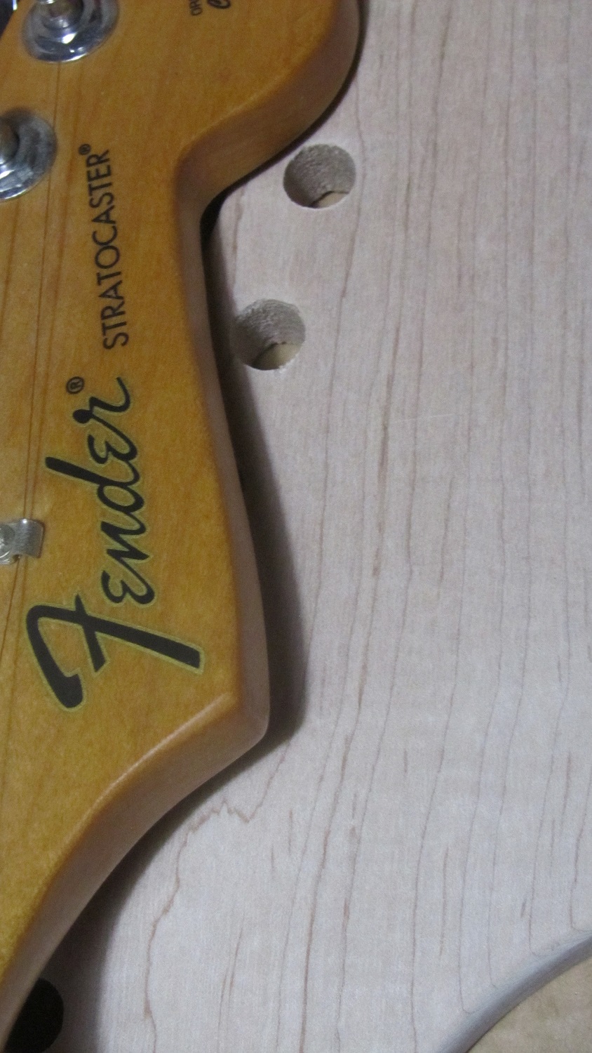

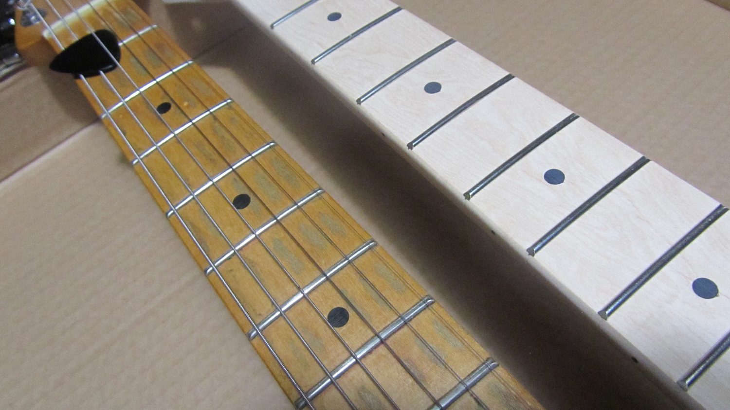

    heres the photo comparison to my Fender Strat, maple neck it has turned a deep honey color.Click image for larger version.

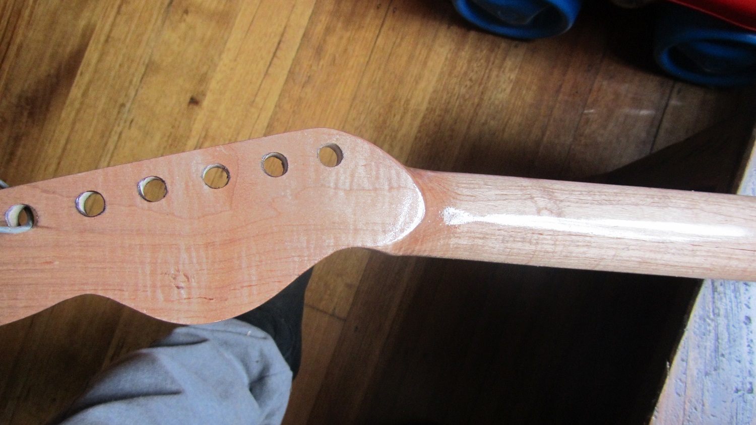

    wow that's bizaar Honeybadger, that neck does look mahogany with maple fingerboard, you can see the difference in colour. Some nice quilt what I can see.
    good score I reckon that will look a treat !
  8. #18
    that is a pretty nice kit, that tele body should come up a treat

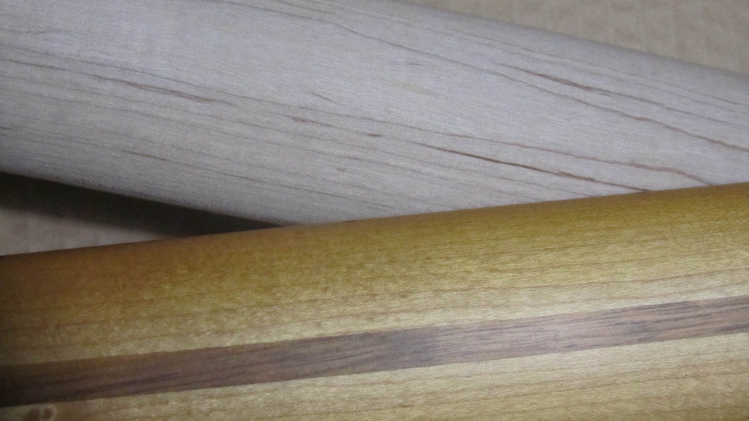

    Issue I will have is the neck timber is a darker shade then the body timber. Since this is a stain, with a French polish finish need to balance the amount of neck to body stain finish. There is some really nice grain on the neck. Finish will be Bondi blue. I also don't like the neck to be vanished, I sand down smooth my necks Ala John Mayer. SRV. So I have a Mahogany Neck with nice grain with a Maple fret board. And I wanted this to be a beginners build.....
  10. #20
    so HB will the neck and body be bondi blue ? you will just have to apply it and see what the colour difference is like and make adjustments from there. Another option is shape your headstock and with the offcuts do some test stains of the bondi on the mahogany to see how the colour compares to the body. If it is too far out you may consider a clear neck mabe ?
