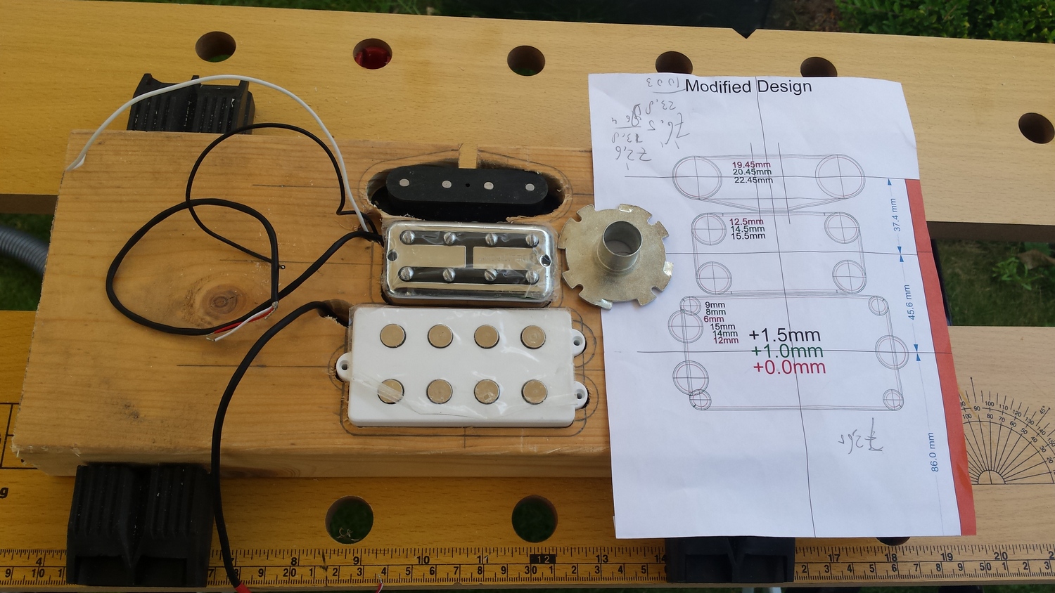

    Never used a top down mill before, borrowed one from a friend and started testing on some dummy wood. Decided to go for the template route, designed pickups in CAD, added margin for the router guide and got them laser cut out of some PMMA plate (in fact, 2x 5mm to make the required 9mm of the router guide).
    In the design, pickup posititions for the MM Humbucker and 51p-SC are the same as for the original basses, the Cabronita HB is shifted a few mm and fits nicely in between the other two.

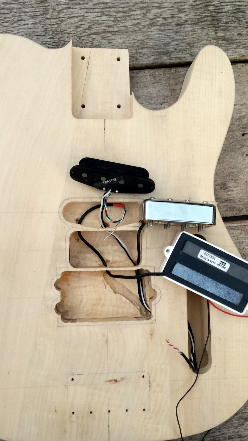

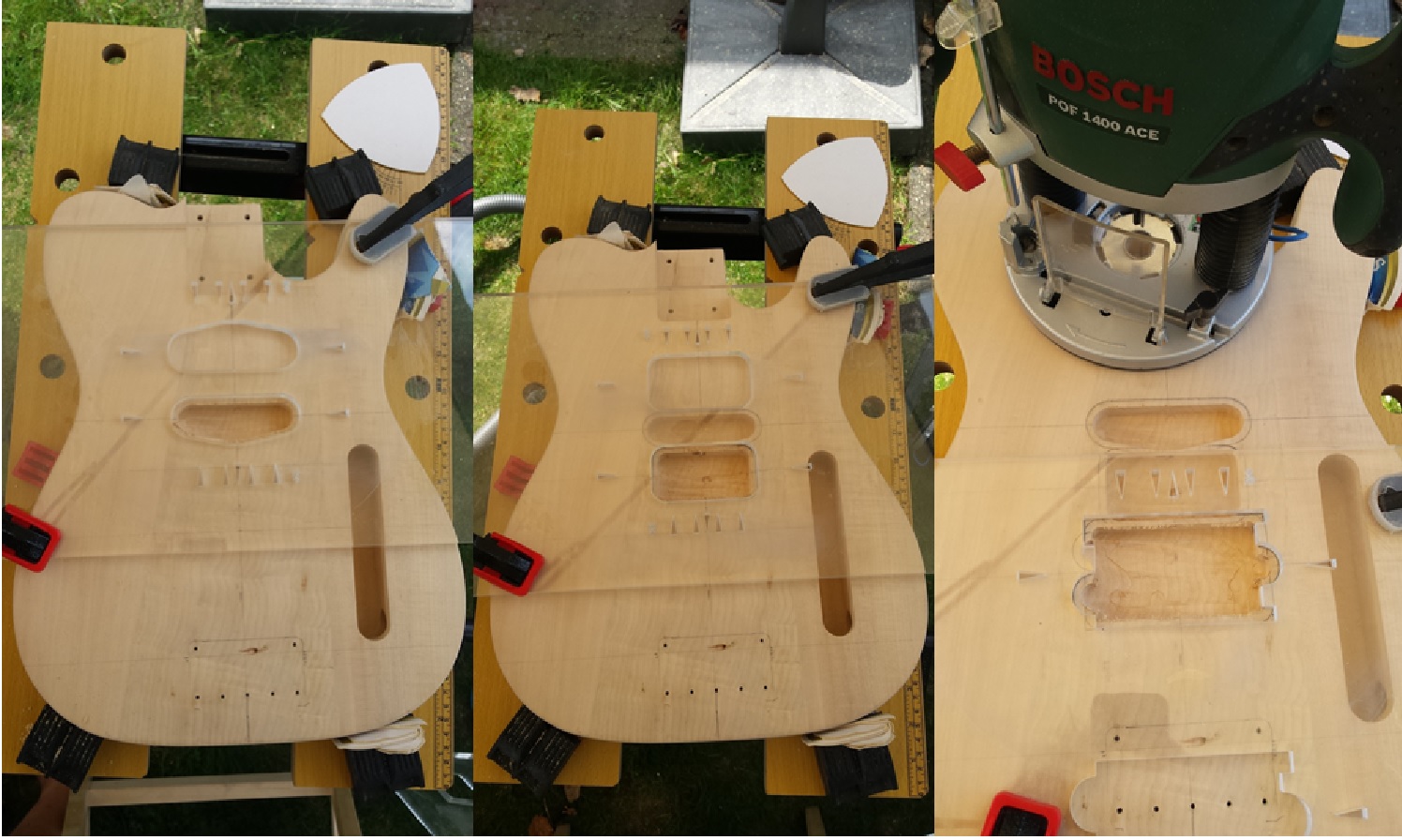

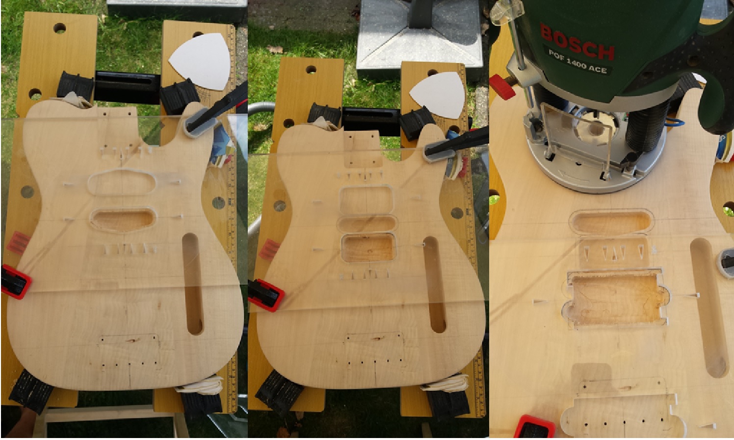

    Next, tested in on some spare piece of wood, verified the templates were OK and finally today got time to get them milled out of the body.
    51P and cabronita HB were pretty easy, the MM humbucker required 2 templates (one rectangular and one for the 'ears').
    Basswood is pretty nice for someone with marginal wood experience, quite soft (but not too soft), got the job done in a few hours (pretty much the same as aligning masks in microtechnology, my day job :-))
    Worked out nice I think, next added some channels for all the wires and made a 4th pocket for the 9V battery for powering the active electronics.

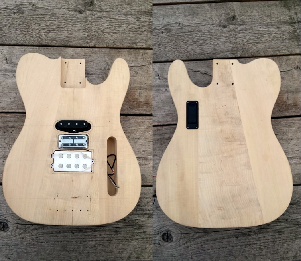

    Furthermore, I designed the electronics, including a new control plate and pickguard. More on that later...
    Very happy so far and great joy!
