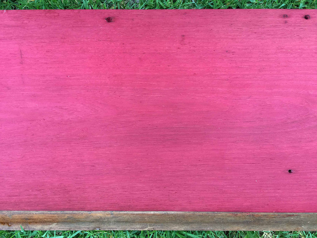

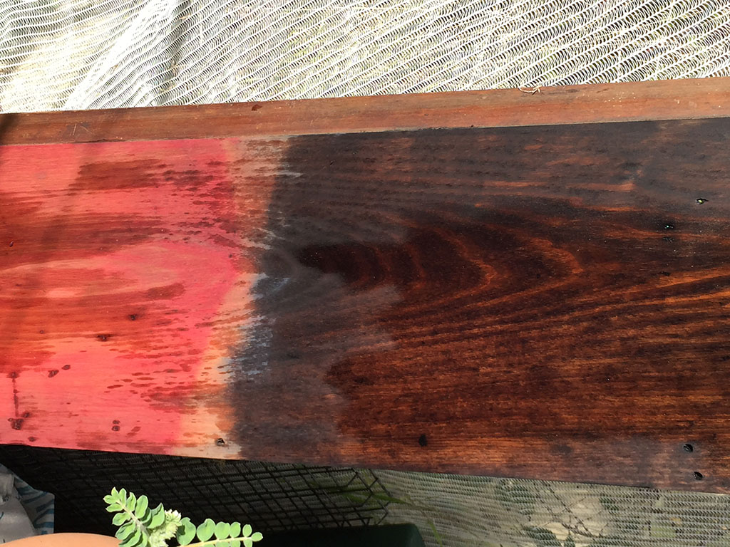

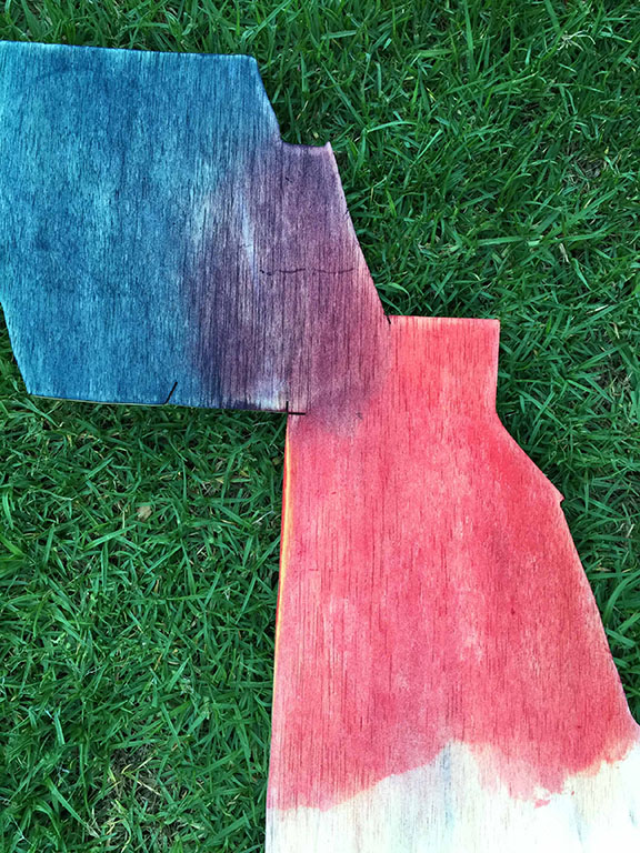

    Fabric dye results - Part 1 of 3

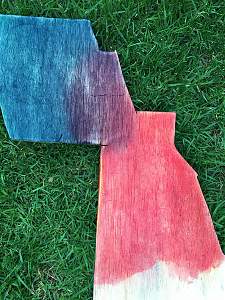

    I did 2 woods, marine ply and a hardwood in 2 colours, red and blue.
    This is the result of dyeing then sanding marine ply. I overlapped the colours to see how they would blend.Click image for larger version.
    Nothing exciting. The wood does not like to take stain.
    Sanding did not improve the look.

    Plywood seems to be a denser timber, as its manufactured for strength, which will make it less receptive to dyes. It still gives an idea on colour, though.

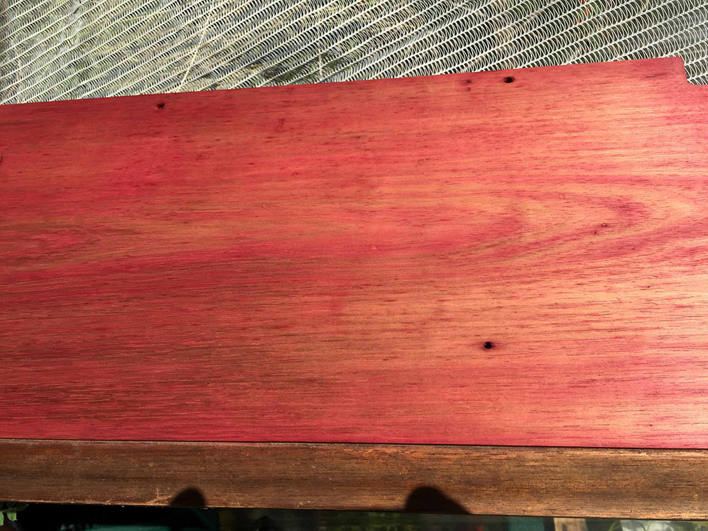

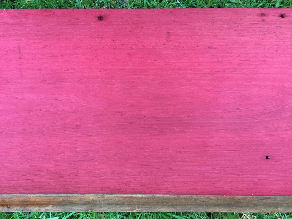

    Fabric dye results - Part 2 of 3

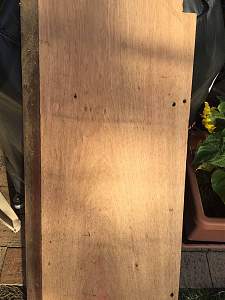

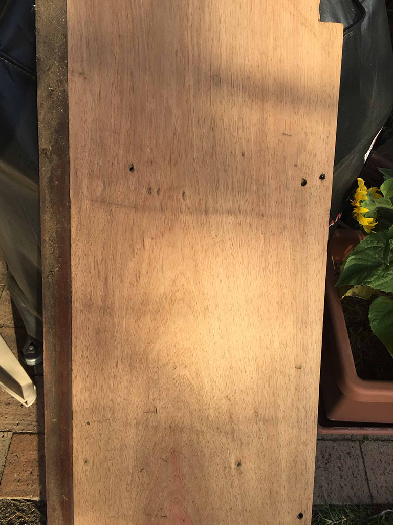

    Here is the hardwood. It has a few remnants of black and red ink after I sanded it. Most of the ink, a previous attempt at staining, disappeared. The dark is shadows, it was late afternoon.

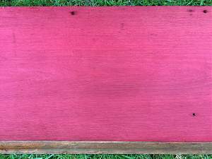

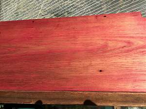

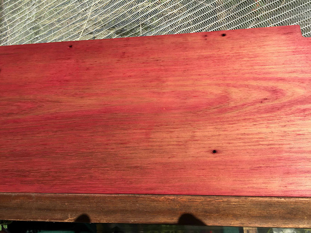

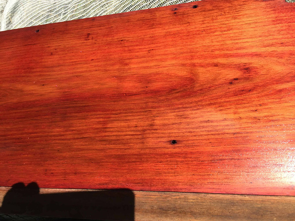

    Here is the wood dyed red
    This is after sanding back vigorously this morning. I wanted to make sure it was not just a film on the surface like most of the ink had been.

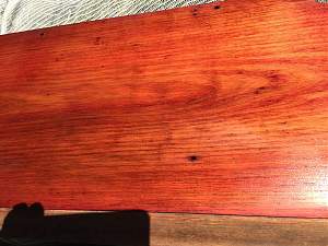

    And finally what is looks like wetted
    Much better than the ply. You need some grain to hold the colour.

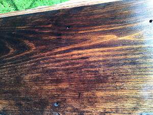

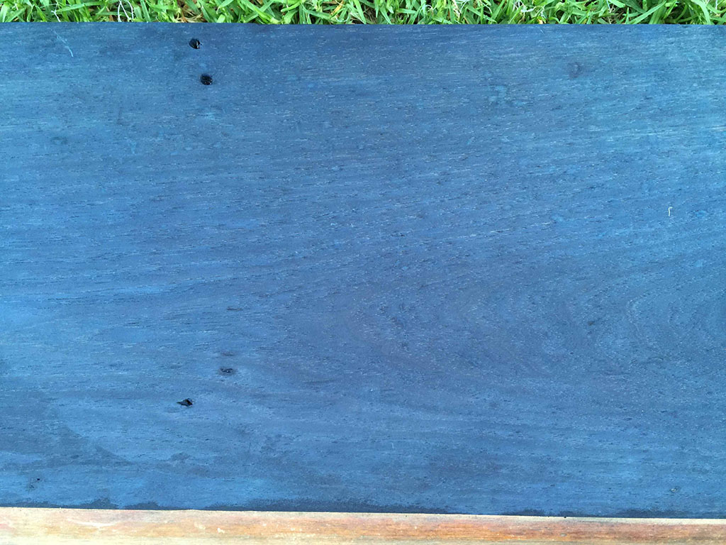

    Last version was blue on hardwood.
    When I first dyed it late last night it looked black. I was thinking OMG I have gone too far. Dried lighter.

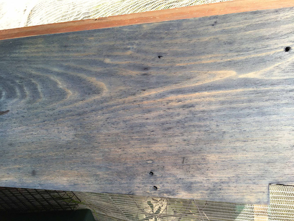

    After sanding the grain reappeared.

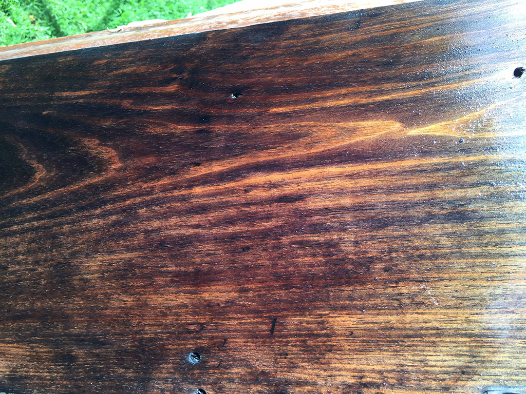

    It looked good wet

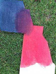

    Just to show there was a chemical reaction between the dye and the wood here is a picture as the water was drying. You can see the colour is across the full piece of wood even after sanding.
    I guess if I went over the top of the blue with a red dye I would get grades of red and purple.

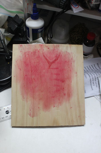

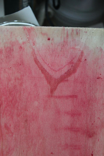

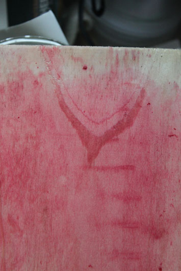

    As it happens SWMBO was cooking some beetroot from our garden as I read this thread.
    What else is a guy to do?
    I grabbed a piece of pine and the scraps bucket.
    I gave the pine a very quick sand, just to key the surface.
    I simply rubbed discarded pieces of the boiled beetroot onto the pine (and scrapped off the vegetable matter that stuck to the rough surface).
    The images were taken a few minutes after, as a control:
    Col.
    \m/
  11. #20
    Hi Col, can you post a photo after it has been left to oxidise for say a week or two as I suspect it will go slightly browner over time unless cured somehow.
