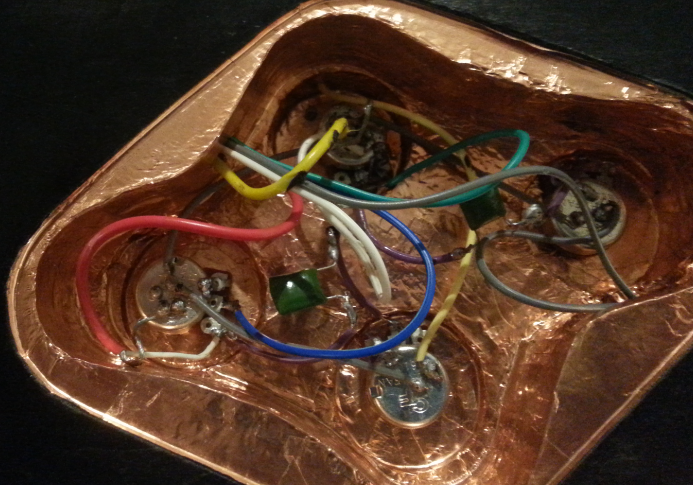

    I was stuck on the wiring here. I followed a LP wiring video from fred yen's website.
    With the wiring above, the capacitors were a different size to the video above by fred yen so I stripped some wires and extended the length of the capacitors on each end. Probably a bad way of doing things but it worked. On his example the capacitors reached the relative pots, but not with this kit so that’s why I improvised.

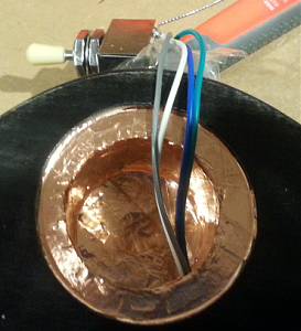

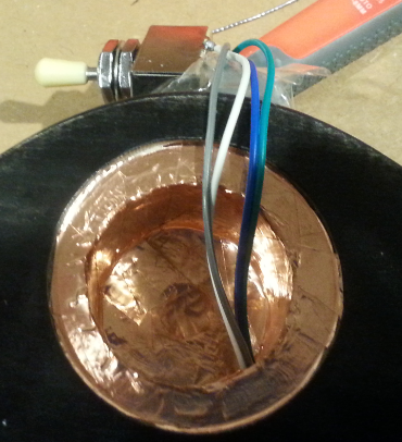

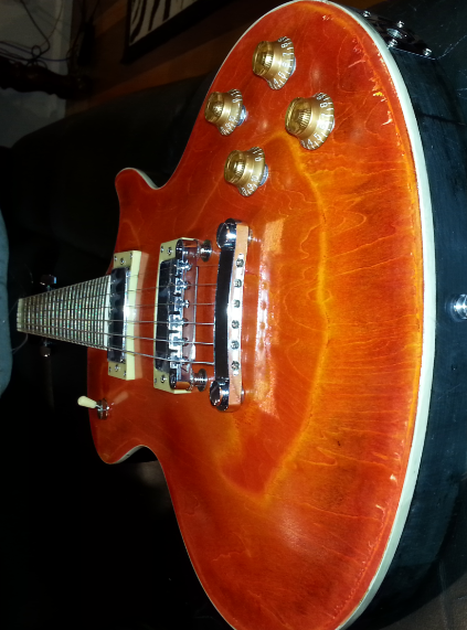

    – Copper shielding tape the control and three way switch cavity was a lengthy process but it was good. No electric interference noise when plugged in. Definately worth the time. I also grounded the bridge but that was to one of the pots. I didn’t ground the shielding tape to a pot. I also shielded both insides of the control cavities covers with the copper shielding tape.
    -Wiring controls and humbuckers. I had no idea, so I followed the video I posted above. It works after stringing the guitar.
