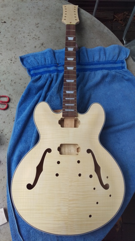

    plans sound great Tony. Just be careful with the veneer you don't sand through. You should get an idea looking from the side of the pup holes the width of the cap but it's often thinner near the edges/binding
    Banned
    Dec 2015
    1,171
    Yeh mate already got the gauges out and doing some tapping, there wont be alot of veneer there thats for sure. I am also tomorrow going to be going over it with a magnifying glass looking for glue, i have found 2 nasty pieces at the neck join on the neck itself, some goop will fix it.
    Plenty of sanding, but only light on the veneer until i get a few coats of finish on it.
    Bought at flame top tele, some Tru-oil and some stain from him. Wasn't planning on doing another kit but I am excited to get it.
    welcome to the forum Emily, be keen to see some pics of the build, be careful if the veneer is thin not to oversand,

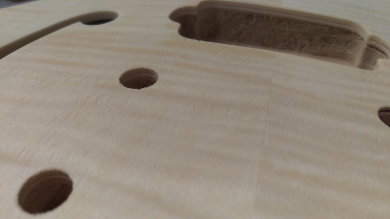

    Hey,
    I got mine as well:
    Pretty happy with the kit.
    I ordered a set of Wilkinson pickups to upgrade the kit pickups. They're a bit larger than the kit one so will have to play a bit with the pickup routes.
    I also ordered a bottle of Aussie Oil... quite tempted to try it!
    I'm going for a clear natural look on this one, now stain.
    Any advice on what to use to grain fill this:
    I'm actually tempted to just sand it flat a little bit (very little... don't want to go through the veneer!) and not grain fill, what do you guys reckon?
    Cheers

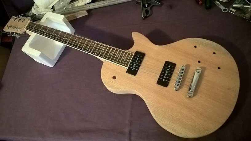

    Fred that's what I'm doing now. This is my first build so I'm feeling my way slowly.
    It's for my wife and she wants it super simple, no shine, no decal nothing. I suggested her initials and number 001 on the head stock rear, I got NO! NO! NO!, OK I get it "KISS".
    Eight coats on, time to let it sit and harden while I sort the electrics.
  8. Liked by: Wisdom

    Nice kit Fred. I'd grain fill instead of sanding. Choose a light to medium colour to blend in if you are going natural
  11. #19
    Mentor FredA's Avatar
    Sep 2015
    Surry Hills, NSW
    500
    @wokkaboy: thanks for the advice. So sand a little, then grain fill, then sand with 400 and up?
    Cheers
    Sent from my 0PJA10 using Tapatalk
  12. #20
    Hi Fred, Yes I sand lightly say 180 and 240 grit, then grain fill, and then 240 up to 360 or 400 grit. Once you have grain filled don't sand too hard or it will come out of the pores.
    Give the grain filler plenty of time to harden, like 5 or 6 hours I usually do.
    I got no idea how thick the veneers are so don't oversand the lower grits
