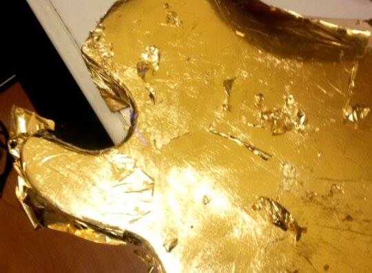

    I have to admit, the body looks like garbage.
    I dont think any amount of staining or lacquering is going to make these six slices of packing crate make for a good finish.
    The up side of this, is it reaffirms my theory that active pick ups could make a cricket bat sound good.

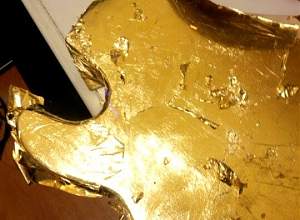

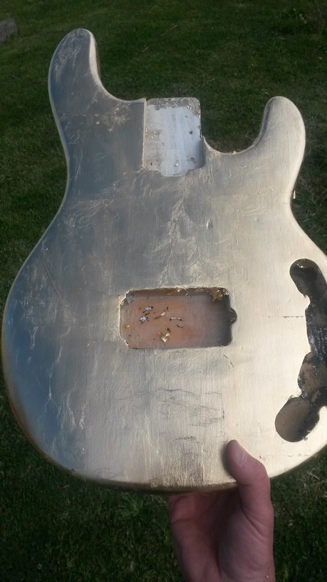

    It was then after some practice and arranging of things I decided to do this to the body:
    It is mezmerising!

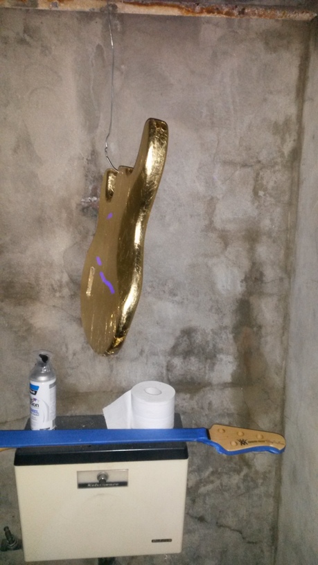

    I live in a lovely small old house by the sea, so there aren't really any dedicated workshop places. Its one of the things that drew me to pitbull guitar kits and the dingotone product. It could all be done in the kitchen and around the house.
    I was thinkng I would have to hand paint an acrulic over the top, but would have preferred to spray.
    At first I had been against spray lacquering because I could not think of a place that the instrument could be left undisturbed by others in my family and by my cats and dogs.
    Then it hit me.
    Where do I go to be undisturbed by my family and cats and dogs!
    the dunny is your spray booth wow !

    As some of you might be able to see on the headstock, it has the major brand name logo decal on it now.
    You will be pleased to know that where the "TM" is meant to sit in the centre of the logo, I got the designer to replace it with the word "FAKE" and it looks awesome
    22 karat gold leaf from Thailand
    wow Beef what a different idea !

    One of the best parts about this project was needing to find out more about gold leafing, and getting sprung by my (adult aged) son wanting to know why was watching this:

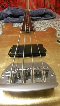

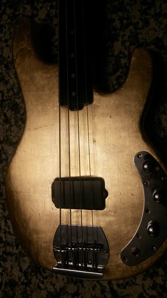

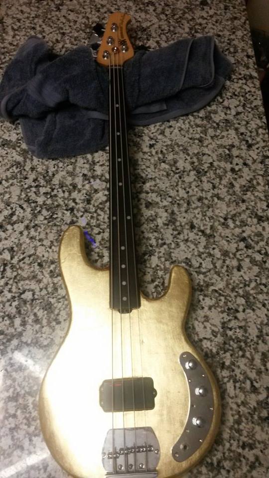

Name:	goldy front.jpg
Name:	goldy whole.jpg
    Not wired and torsion bar adjustment is settling in, but happy with everything else so far.
  9. #19
    looks pretty cool Beef, presume there's no clear coat, how tough is the gold leafing in terms of knocks and scratches ?
  10. #20
    there are about 10 clear coats
    sanded with 1500 grit between the last half dozen
    gold leaf is about as tough as cigarette ash, you cant actually touch it
