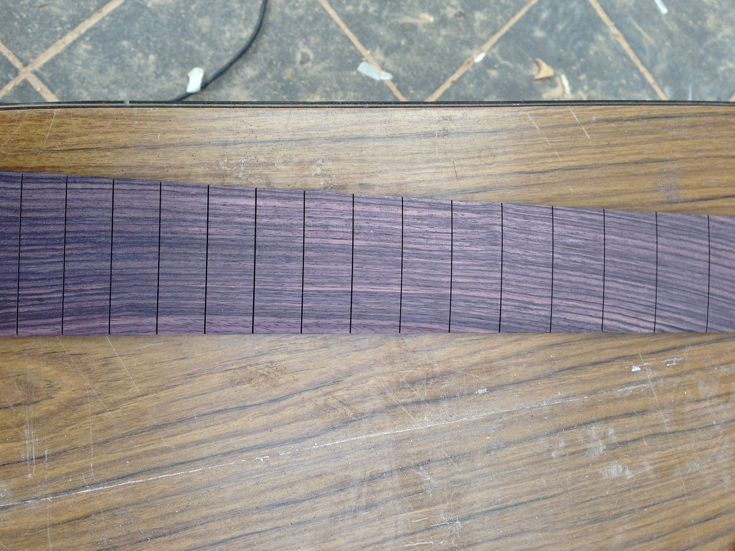

    I ordered my truss rod and rosewood fret board from the states so be 2-3 weeks before i can start on the neck. so basically ill get the body blank done and rough out a shape from my template while im waiting for all my parts to arrive, then before i go any further with the body ill build my neck first, that way i should be able to get a perfect neck fit.

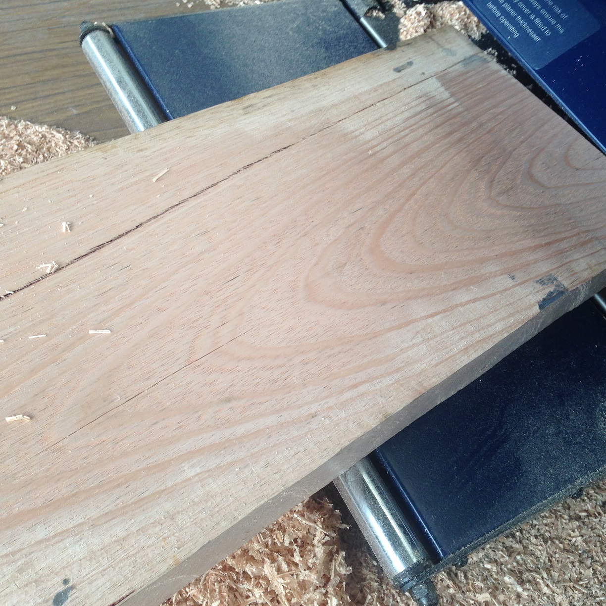

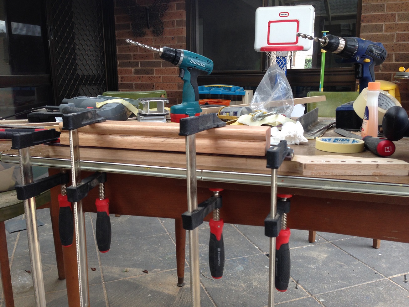

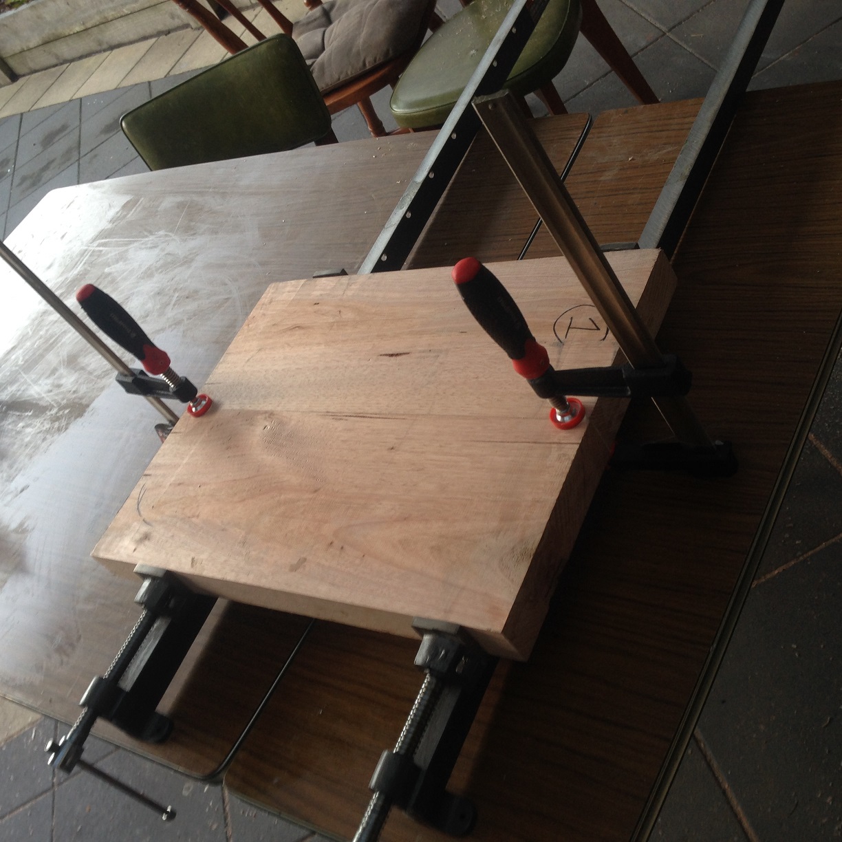

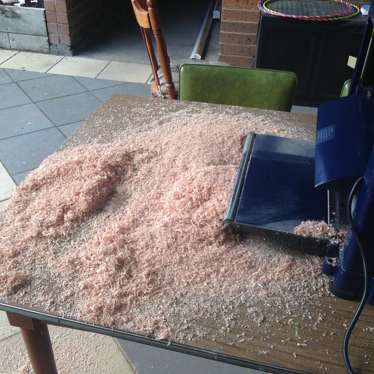

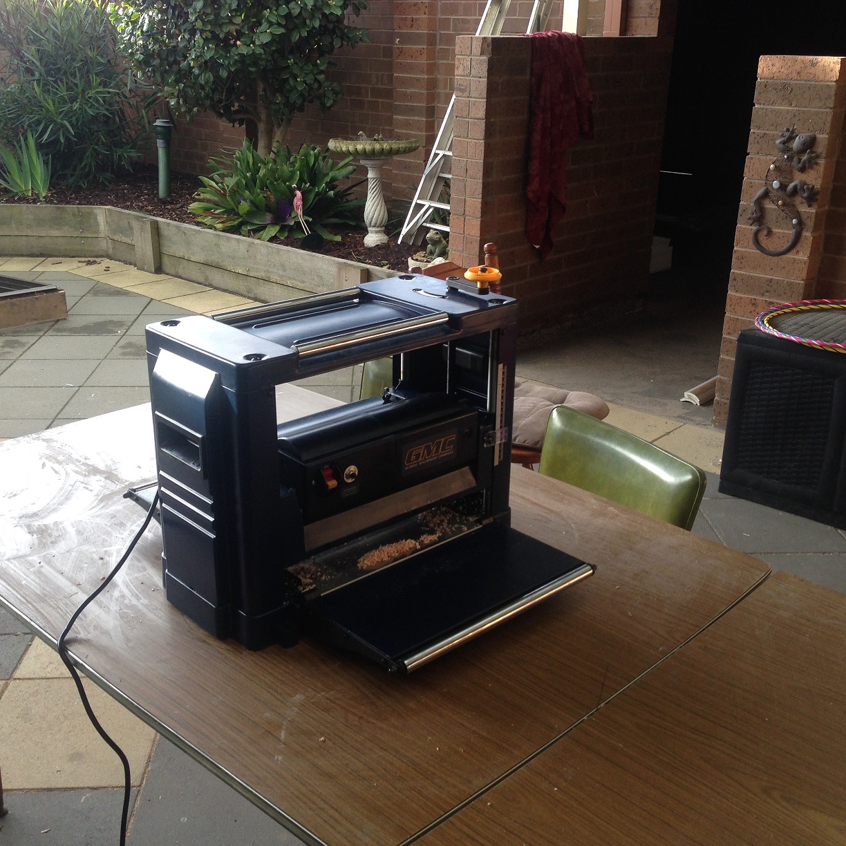

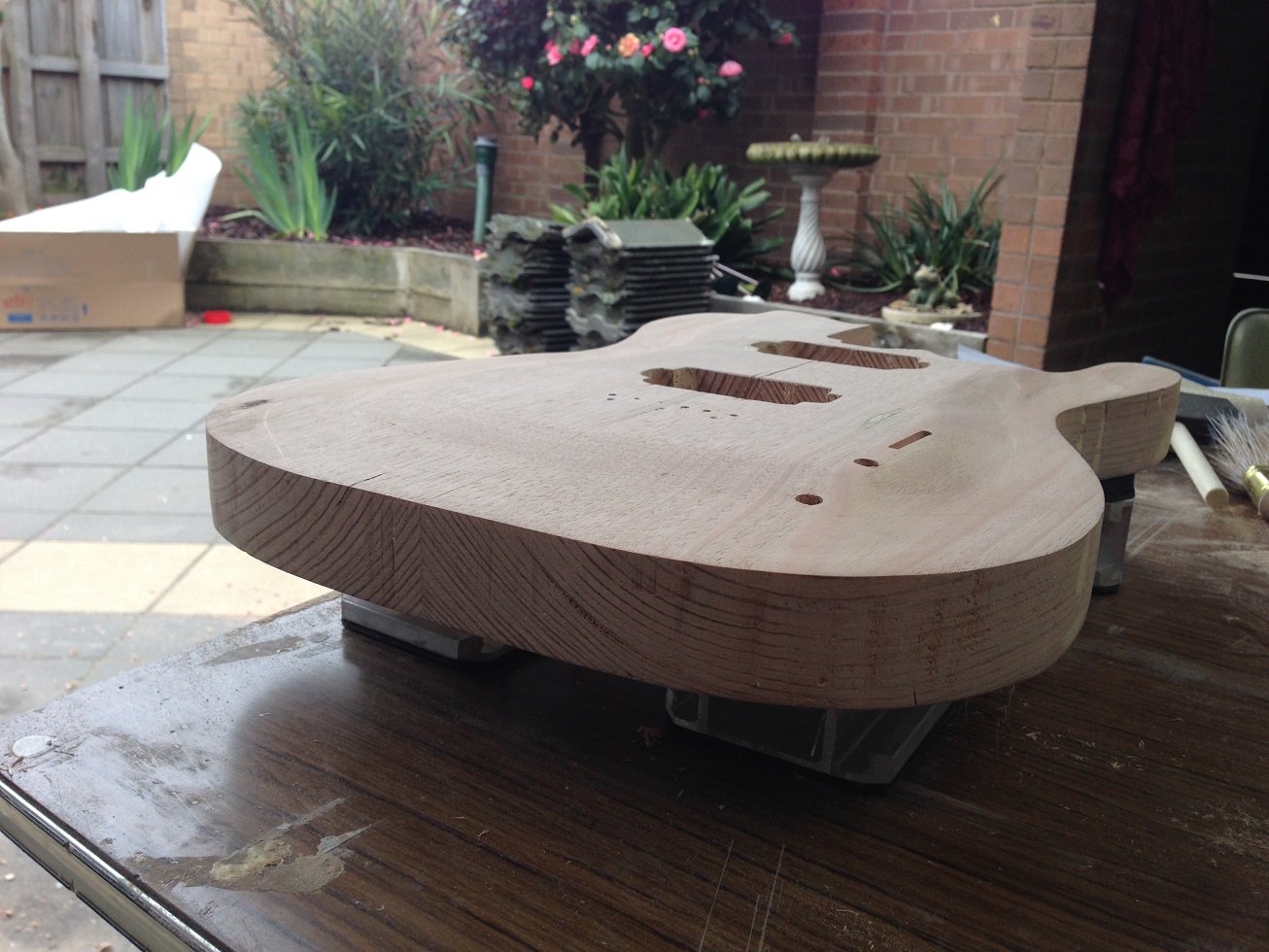

    Hi All, i got some progress done tonight i got an hour after work before it got dark so i grabbed the thicknesser and went to work, i took about a millimetre off each side so they ended up about 43mm thick.Click image for larger version.

ID:	4682After they were thicknessed i put a good layer of titebond on an clamped them up. Click image for larger version.

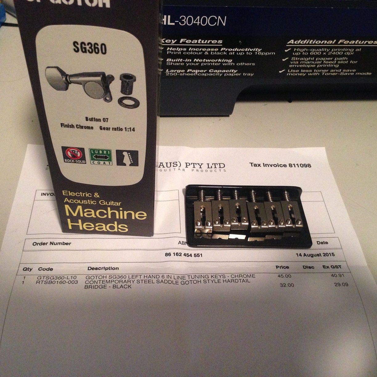

    I also got some goodies in the post from realparts.com.au, i got my Bridge which has stainless steel saddles, i love the block style saddles on these brides, i have the same on my 86 strat, but thats an original. also got my machine heads, i was limited in what i could get because i had to get left handed tuners because i am going with a reverse headstock.Click image for larger version.

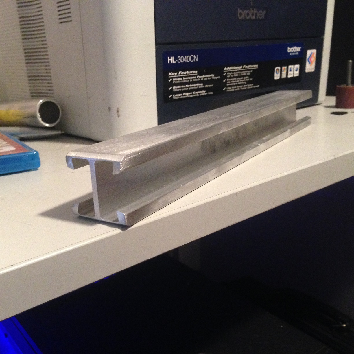

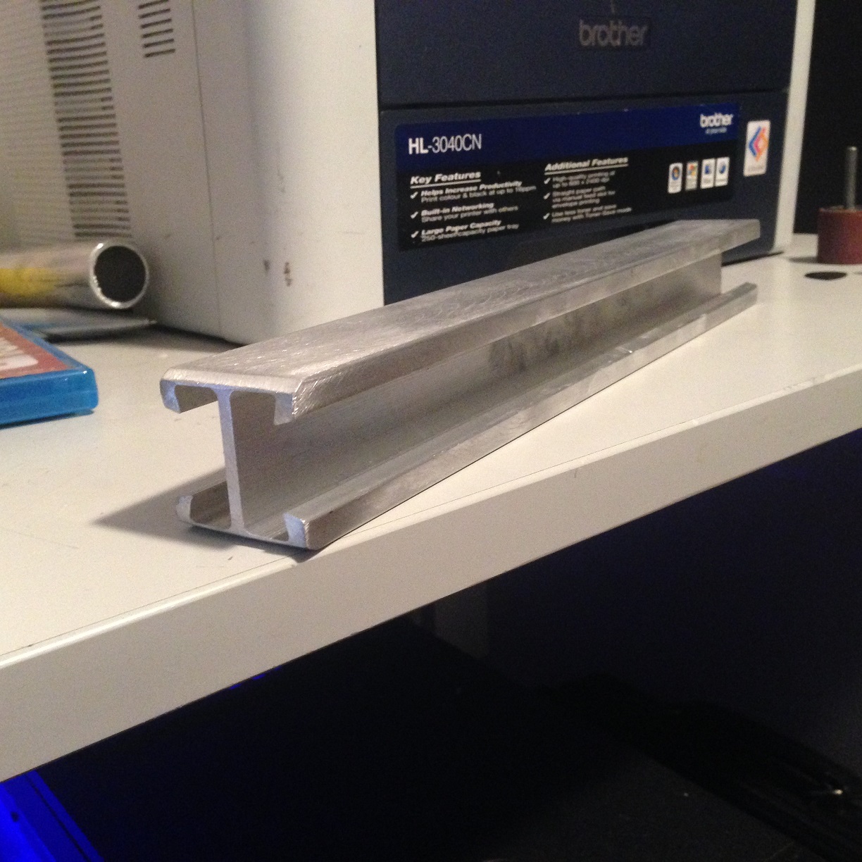

    also made some tools up at work, i made a fret leveler which is 40mm wide and 350 long, is made from milled ali so its dead flat.

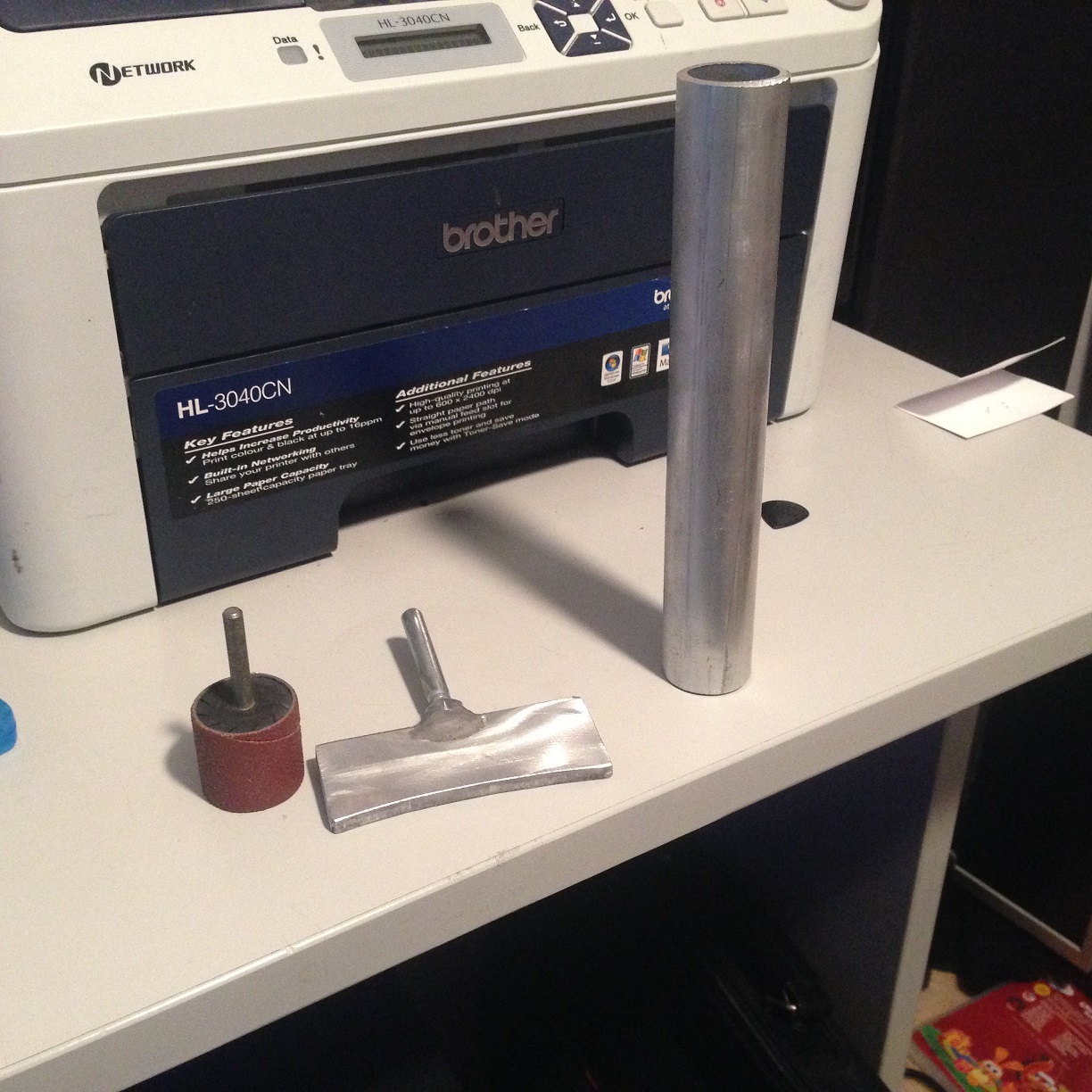

    also made a fret caul 12' radius and i got a piece of tube also to wrap sandpaper around for sanding curvesClick image for larger version.

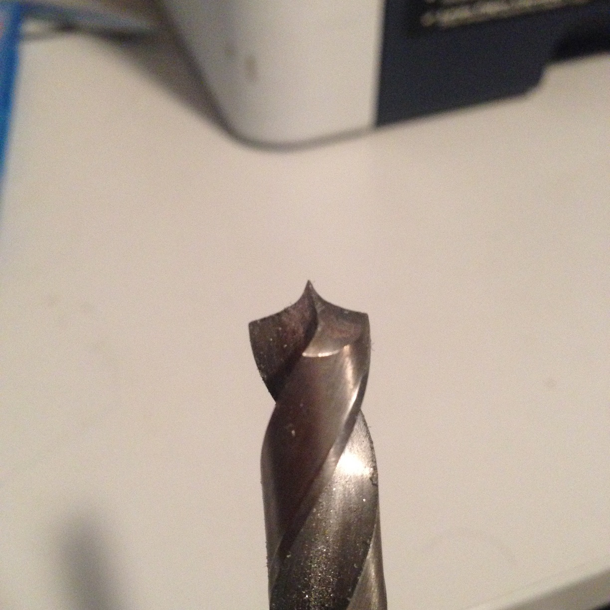

    and this is a regular 10mm drillbit which i sharpend into a bradpoint for the tuner holes.Click image for larger version.

    looking great Farnzie good progress. Love the home made tools. Just get some adhesive sandpaper for the fret leveller.
