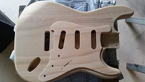

    If it is only the pickguard that you are going to modify you should be able to file it back, I just finished doing a custom timber pickguard for my strat project(new project sta-1m) I roughly cut out the pickup holes with a jigsaw and then took them out to size with 80 grit paper wrapped around a steel ruler, slow but very controllable. the Jm is looking fantastic so far, I feel your pain waiting for the paint to do it's thing I am in the same boat at the moment
