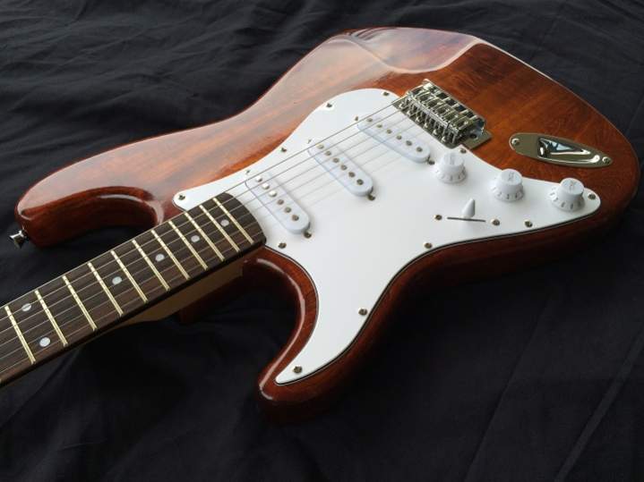

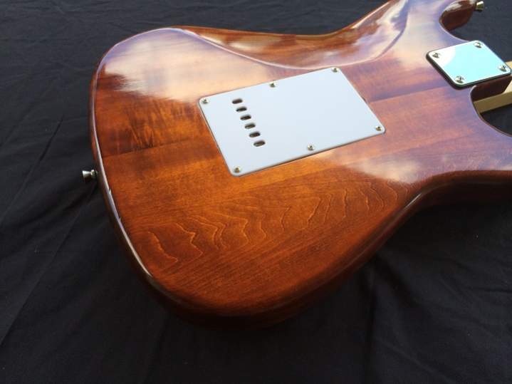

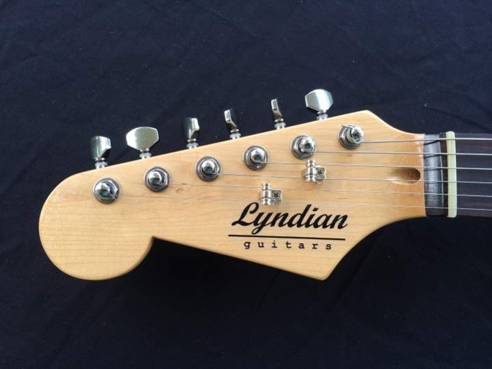

    Well guys, its finished, but unfortunately this one might end up a wall decoration .
    Somehow the truss rod has slipped about 10mm down inside the neck and has now become stuck fast and will not allow any neck adjustment at all. It was OK when I straightened the neck to level and dress the frets, but now has become stuck fast. The neck is pretty straight at present and has very little relief. I am hoping that with the tension of the strings it might develop the desired relief but only time will tell.
    It is a beginners guitar for my brother, so I decided to finish it and give it to him for Christmas as originally planned and we will keep an eye on it over the next few months. Unfortunately he lives in Sydney and I in Brisbane so there is little I can do. Hopefully he will get some use out of it.
    Its all standard except for a bone nut and roller string tees, so in terms of money there is no great investment there. But I spent about 50 hours on it. Ouch, that hurts. lol.
    Anyhoo here's some piccies:

    That's pretty unfortunate Rob. I had a similar thing happen with my pbh4. The neck has held up incredibly well, but eventually string tension will get to it. When that happens, I'll replace the neck altogether or consider steaming the fretboard off.
    But, what a stunner! Absolutely beautiful finish. Once again, you've produced a strat that I really like, even if it is backwards.

    Rob that is a stunning str@t, but what a bugger about the truss rod. Hopefully your bro will get 12 months use out of it before the neck is unplayable. You have also extended the elbow and tummy cut on this ?
    You are still the king of mirror finishes with naughty oil mate

    Rob, amazing finish as always. Was the truss rod completely loose when it slid in and jammed? I imagine you've tried this but I wonder if you hold the neck vertically, heel up, and give it a few taps on the butt of the heel with a rubber mallet if it would jolt the rod free or at least move it into a semi-useable position.
  10. #20
    yeah worth a try Rob, I'd remove the neck and give Weirdys idea a go, got nothing to lose
