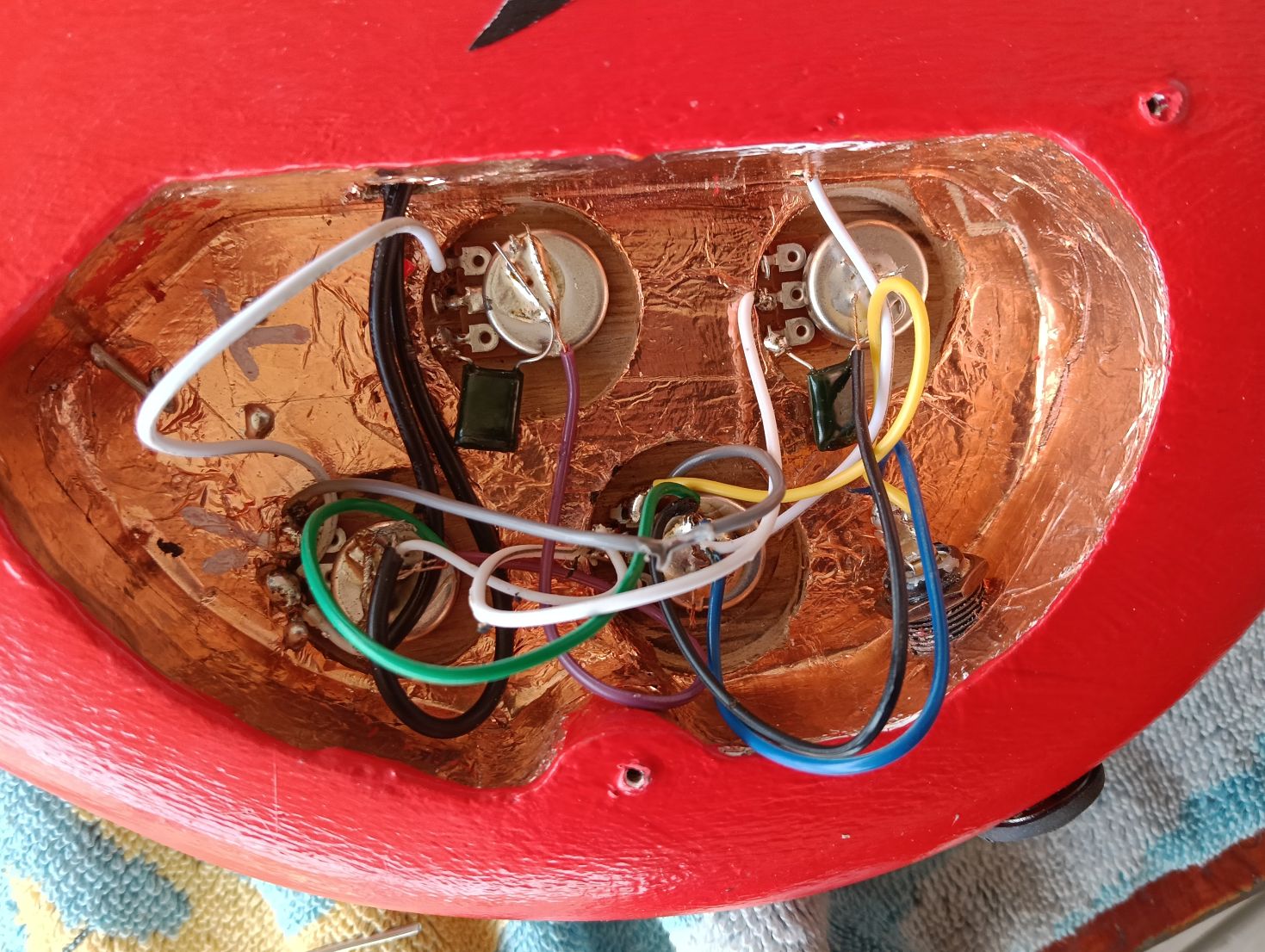

    we will attach a photo as best we can below.
    is very messy, we usually wire much better and intend to tomorrow as we desolder everything and start over again.
Name:	36% - IMG20250322135320.jpg

    I'm not sure, but the picture looks like the solder and pot legs are touching the copper shielding! If that is true it could be the problem!
