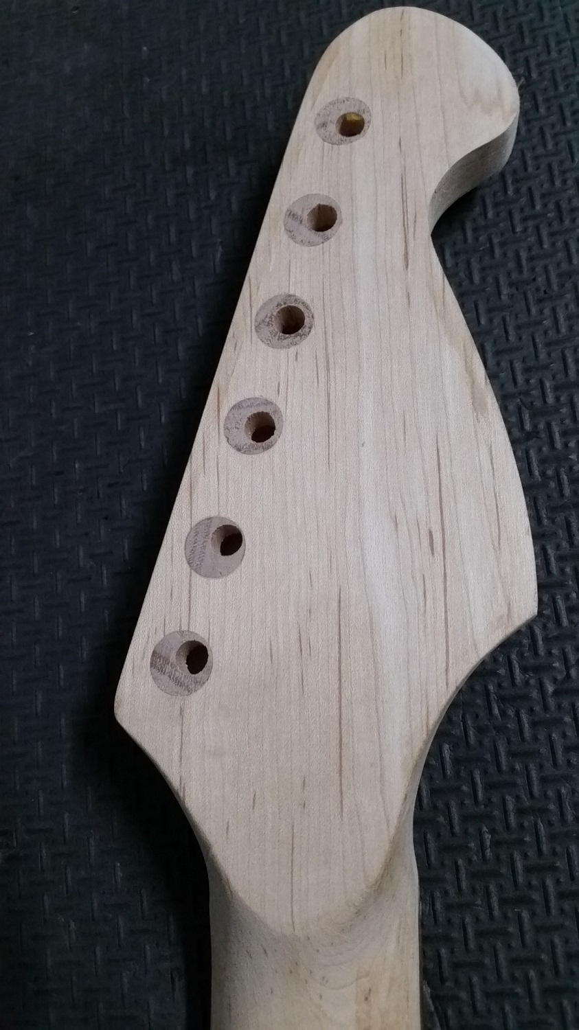

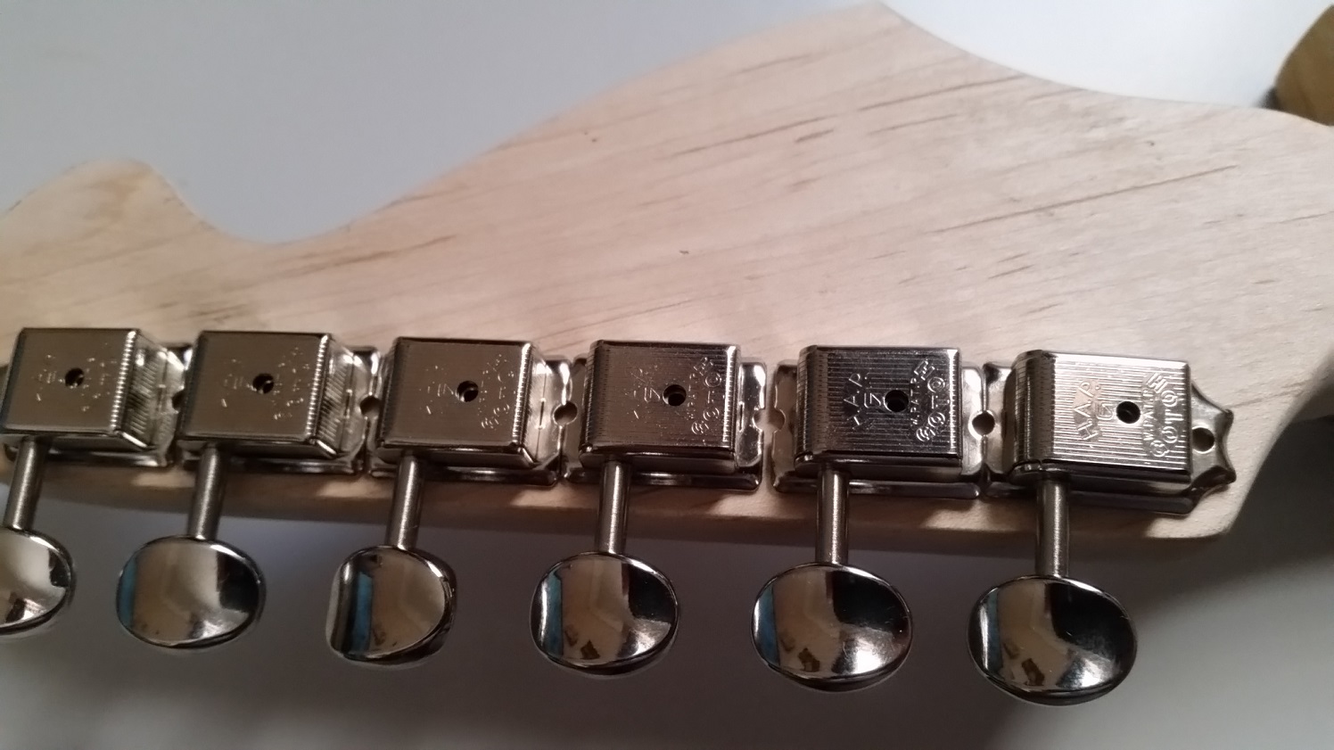

    Just came back to me. Before you order the adapter bushings, please check the pre-drilled tuner holes are evenly spaced so the tuners can sit together properly. I used SD91-HAP (height adjustable post) on a JMA build and wasn't so lucky.
    Had to plug and redrill.
Name:	JM post holes back.jpg

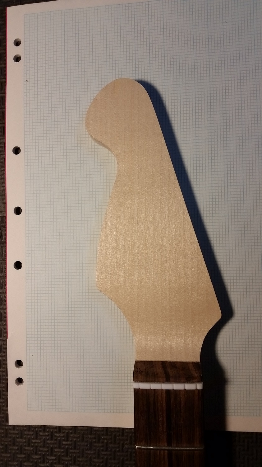

    If you want a natural headstock face, you may have to veneer it.
Name:	JM h-stock veneer.jpg
    Hopefully you won't need to.

    Too late! I already ordered them... Now we will just need to see if they fit or if I have to do something creative. Keeping fingers crossed. Will post whichever way it goes.
    2,971
    ...and you were right! The vintage keys don't fit even with the new bushings. So...the ones I have will probably go back on the market. Meanwhile I have ordered a set of Gotoh SG381 to replace them. As an old friend used to say "Too soon old, too late smart" ;-)
