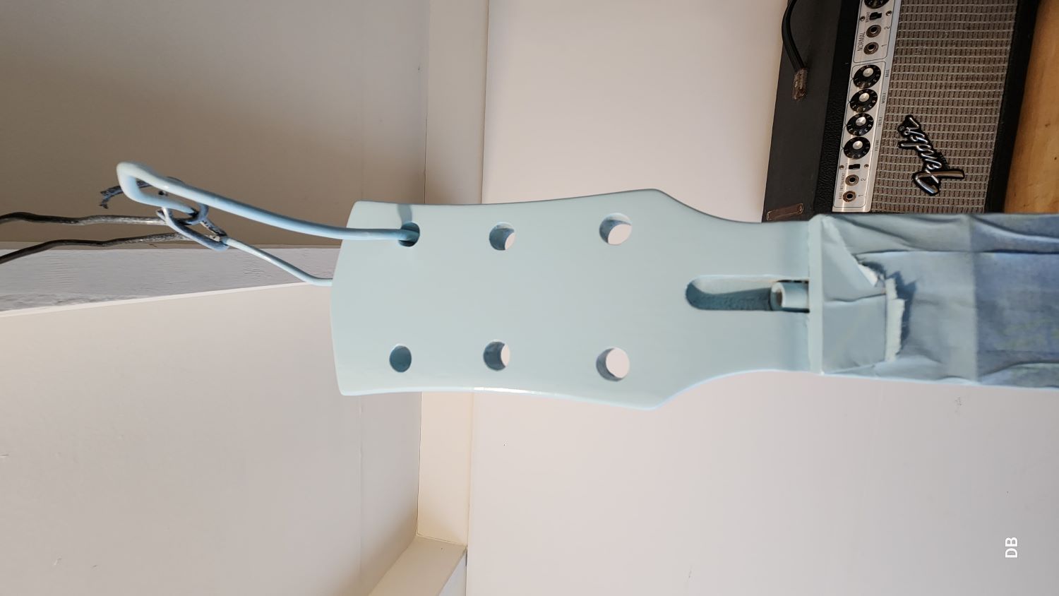

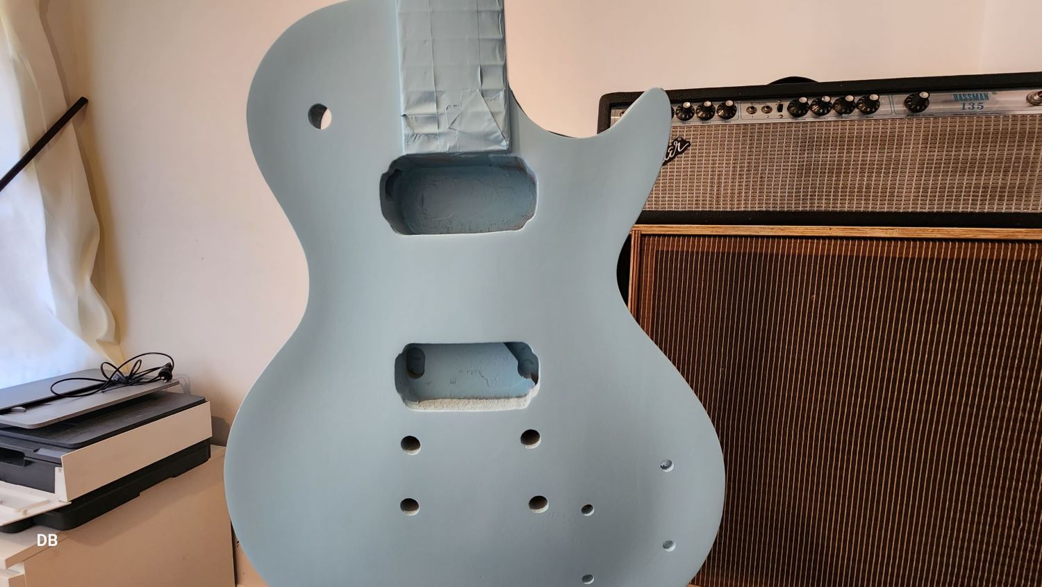

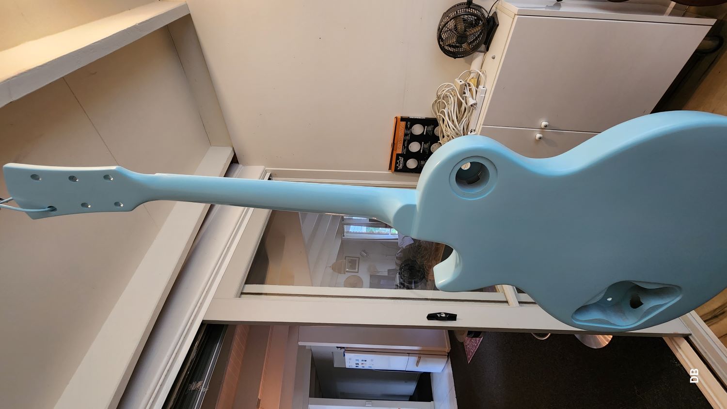

    Here are some photos of the 3rd & 4th coats of Daphne Blue i have to say its come out prtetty good for my first effort i heated the cans up in a pot of warm water over the stove on lowest heat setting to make sure they were nice and warm but certainly not above 70c as acetone becomes volatile from memory above that temp, anyway it worked well in winter here in melb.
    Heres some pics etc, next is the clear coat, there are a few very slight flaws but its my brothers guitar hes hassling me to finish it so he can play it lol i would have taken a bit more time myself but anyways.

    NEVER heat a spray can while the water is on a heat source. If the water is too hot for your hand then it is too hot for the can.
    If the water is too hot the can will more than likely explode from the can over pressurising than the contents catching alight.

    Yes thats right im careful would never use any kind of direct heat source but its winter here and so cold i had to warm them up somehow so 15 mins on lowest electric stove heat setting in a half pot of water did the job nicely, im glad you said that as folks need to know those cans are full of volatile chems like acetone so i believe etc, im no expert but know enough usually.
    Cant imagine being burnt by a can of acetone explosion.
    Thanks for your reply sir.
    david
  9. #16
    And certainly what Dickybee said. You’ll probably see warnings on the can about not storing above 40°C. If you warm it, just fill a bowl with water from your taps that’s no more than body temperature, but ideally a bit less. The contents need to be brought to between 20°C and maybe 28°C. Too hot, and apart from the can explosion risk, too much solvent can evaporate between the can and the surface resulting in too dry a spray. If you are spraying outside below say 15°C then you really want to bring the body/neck inside first to get them to room temperature, then go outside and spray as soon as possible.

    It was warm to the touch but certainly not hot, just nice and warm, i slid the pot over so that only a small % was really over the heat, And it was just on, i was paranoid of over heating, kept and eye on it too.
    I got away with it because im older and kind of know from being a house painter over the years but others no probably best they dont, there was no sun here the other option was in front of the air con i guess.
    Good to know that over heating dry,s the paint and yes i did bring the guitar from inside the house where its curing in a seperate room sealed from the house to the spray booth i made outisde wore a proper painters mask as well.
