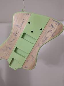

    It's been a long time since my last post. I reread it and laughed at what I wrote back then: "I'm excited that this is the last time I have to wait for something to dry or cure."
    I had to start over. There were some weak spots where a layer of paint under the surface never cured. Too much paint and too much humidity. I waited a month and a half to see if it might get better over time, but no luck.
    While I was sanding off the paint, I decided I liked the look of the bare wood with random patterns of primer, so I left the upper and lower sections of the front as you can see in the picture. This is the new paint job, with the first layer of clear applied yesterday.

    I intentionally over-sanded some edges and a few other spots to go with the relic-ed theme. No, I'm not just saying that to cover up my mistakes!

    That's pretty interesting. Looking forward to seeing it assembled.

    Quote Originally Posted by Karl View Post
    I like it. I think the primer pattern looks great. It should go well with the rosewood neck.

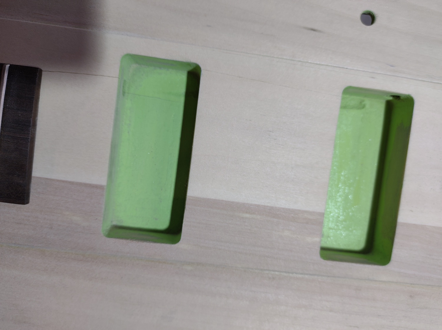

    The photo was taken with me pushing on one side of the neck, widening the crack so it shows up better in the photo. Normally you can't see it unless you look very very closely, which is why I didn't notice until today. The crack starts at the back of the neck pocket and ends in the bridge pickup cavity. It doesn't go all the way through from top to bottom.
    How should I fix this? The crack is so tight that I doubt I could get much wood glue into it. I also have some thin CA which flows better but it sets in seconds. The body is basswood, by the way.
